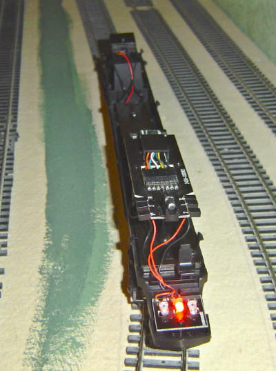

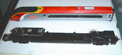

When I opened the loco up I expected to find an 8 pin socket and a Hornby 4 function decoder plugged into it but I didn't. Instead I found the chip hard wired into a custom socket. This makes it more difficult for modellers to install alternative chips. Hornby probably did this to stop people buying the train pack and removing the chip and selling them separately.

This model comes with directional lighting in both the powered and un-powered drive cars. This lighting was produced by ducted light from 4 LED's (1 red and 3 White) in both of the cabs.

The body of the Pendolino has very little detailing just like the real train with only cosmetic signs (bikes, power warning sign for example). On the front of the train there are wiper blades and a detailed light encloses which add just enough detail to make it interesting. On another note when I went to open up the model I found it very easy to get inside. The bodywork simply clips on.
