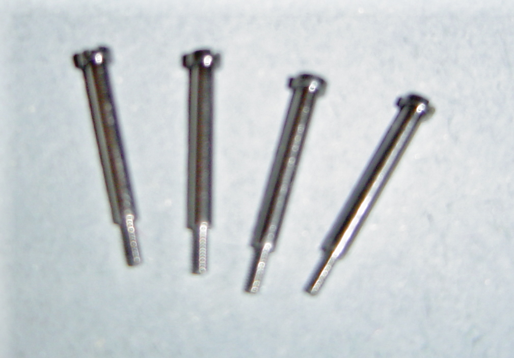

To remove the body of this model you have to remove 4 long screws. Now the screws closest to the fan end were very easy to remove and simply dropped out but the ones at the other end proved to be more difficult due to their position relative to the gaps in the bogie.  I found that I could unscrew them but that I could not position the bogie to allow the screw to drop out. After some persuading I managed to get both of them out.

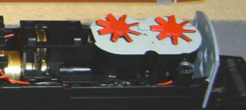

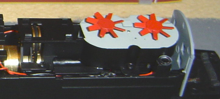

Underneath you can see the centrally mounted motor with axels going to each bogie. This model is DCC Ready so has an 8 pin port for the chip to be plugged into. The lights are fitted to the body so at either end their are contacts to power them. The fans (see below) are powered via a belt drive off of the axel. This means the fans will only move if the model is moving.
