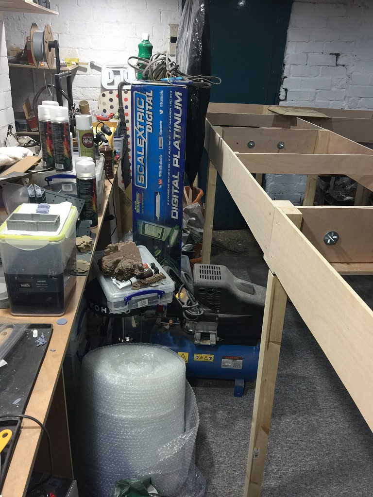

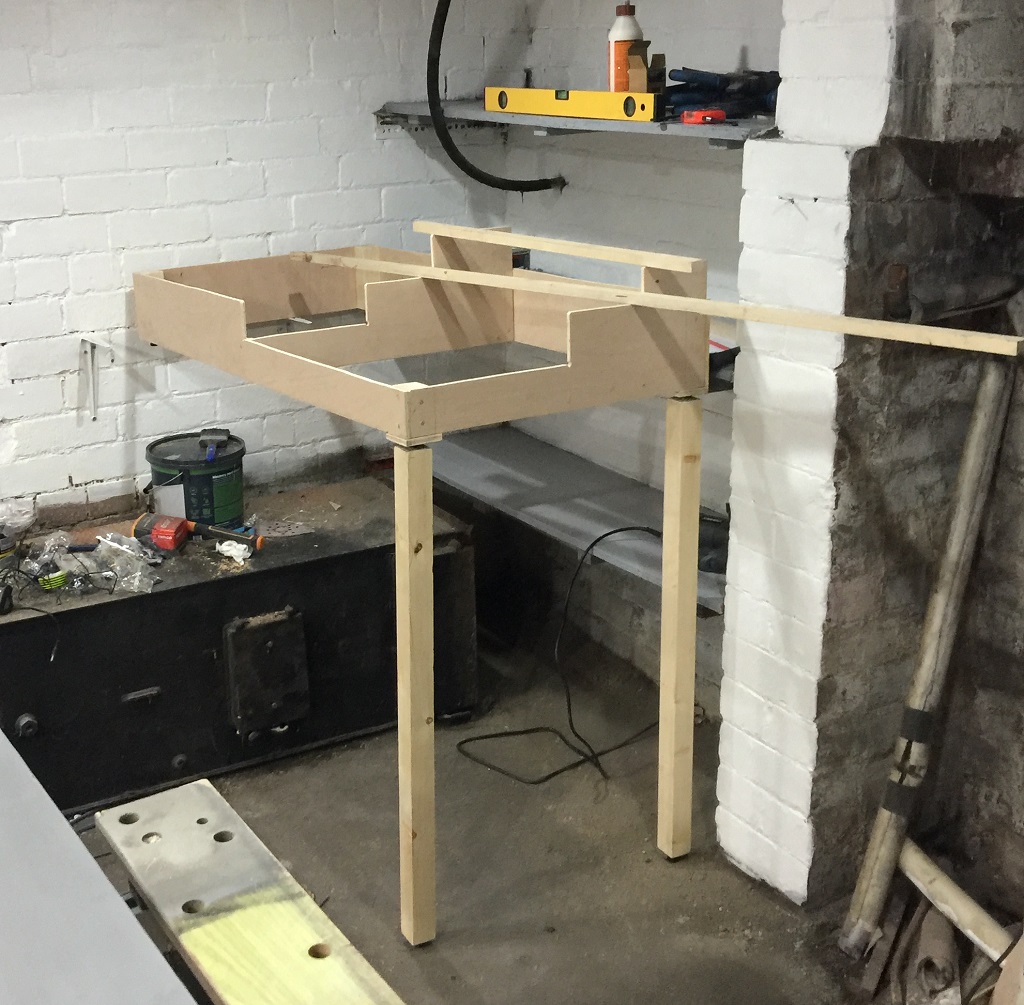

Ok, enough procrastination, I can do more of that some other day, construction on Leopard steer has begun..
evidence:
Image http://www.aleopardstail.com/IMG_3031.JPG
"Board A", aka the back left corner. one end supported by a shelf (the grey bit of wood bottom left, waiting for primer to dry so not in place on the wall brackets.. hence the whole thing not being even close to level).
2'x4' module, three levels, the lowest is datum -3", this will be a purely scenic area, next is the start of what will be a 1:82 climb with a gentle transition at either end - there is a diagonal brace yet to be added to help with this in the corner to support the curved tracks. higher level is a 1:50 gradient the other way which will curve round 90 degrees on roughly a 19" & 21" radius curve.
very basic, the end near the wall has small adjustable feet, as do the bottom of the legs (also keeps the wood of the leg off the floor)

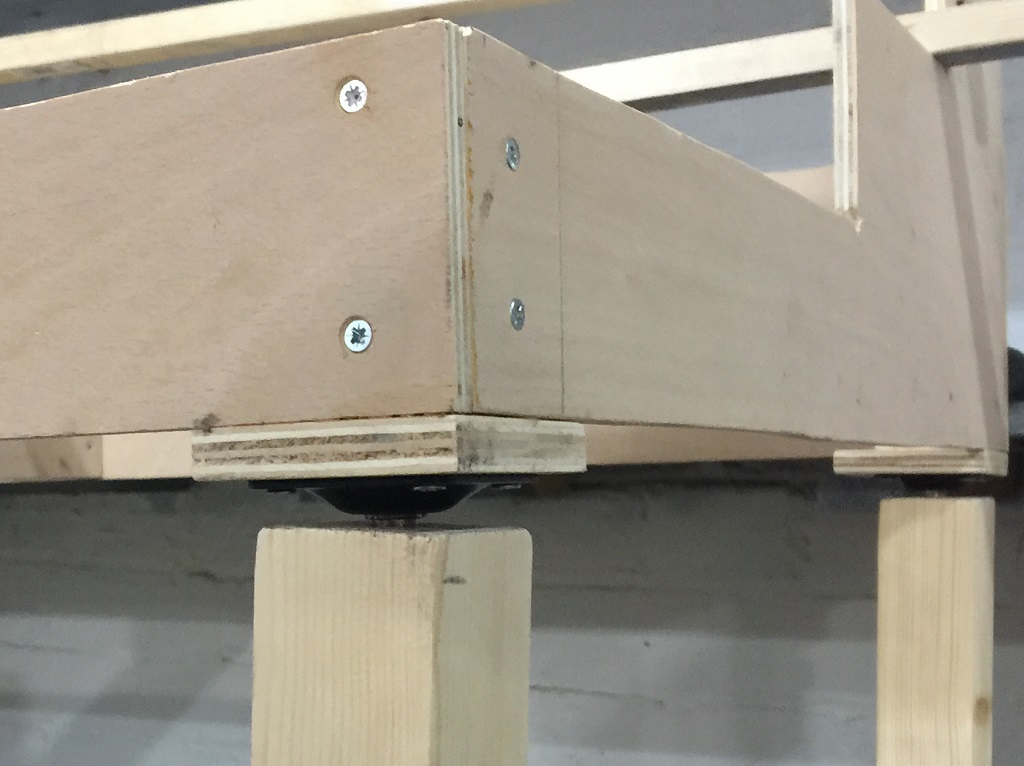

Image http://www.aleopardstail.com/IMG_3028.JPG
and the legs have a screw fixing to the board (hence the lack of any cross braces)
Image http://www.aleopardstail.com/IMG_3034.JPG
means the legs are both adjustable and quite easy to remove
slight irritations, Wickes don't seem to have 2" square timber, so the legs fixing plate needed a small fillet of 12mm ply adding, probably stronger this way.

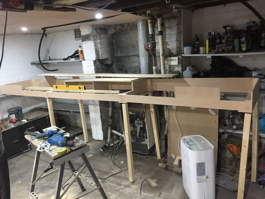

Image http://www.aleopardstail.com/IMG_3036.JPG
now have the first three boards part complete and standing, the legs need a bit of the above mentioned fettling to get them square, the nearest board needs the mid section recutting and putting back (managed to mirror image half of it, thankfully before the glue had fully cured. also both end boards need a diagonal to carry the tracks round the curves.
a few bits I hope to do during the week there, also need to spend a bit of time and get it level, its not far off but not quite there, will then probably move my little test plank to sit on it and experiment with the two gradients to see how well they go(the only bit of flat ground on this side of the layout is a dropped scenic only section to the front.
still, its a start, have a lot of clearing up to do, need to then dismantle things to finish painting the shelving to the rear so some of the clutter can be sorted and put away.

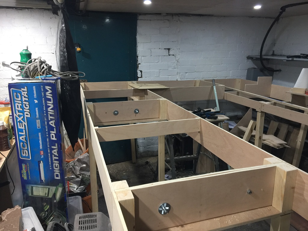

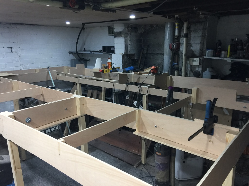

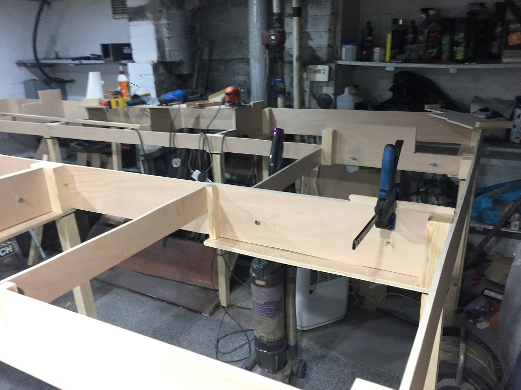

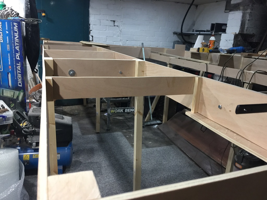

More progress, the primary baseboard framing is done, more secondary cross bracing will be added where needed as the track beds go in (happy for 9mm to go a 24" span supported all around so no part is more than 12" from support but for narrower say 3" wide track beds figure every 12" at least is needed - however they will be done in the more traditional way of a cross brace then a riser that can be set and glued as needed.)
Image http://www.aleopardstail.com/IMG_3040.JPG
low angle looking along where the main storage roads will be eventually "some day" with a high level terminus above
Image http://www.aleopardstail.com/IMG_3041.JPG
panning to the right we have the first of the shorter 3' spanning join boards, this will get a pair of cross braces, possibly a triplet as I want to experiment here - this is where track laying will begin as I have the pointwork for the double junction that will be here - track curving to the left in two pairs after - one to an incline the other descending back to the track datum
Image http://www.aleopardstail.com/IMG_3042.JPG
similar but pulled back to allow the rear side which is essentially two pairs of track and planned for scenery and plain running. shows the board needs some serious levelling and also shows the old maxim that a railway board gathers clutter. this doesn't even have a deck yet..
Image http://www.aleopardstail.com/IMG_3043.JPG
back along the wall, the second 3' span, this will be the start of the two storage roads alongside the running roads. what isn't shown (as it doesn't yet exist) is the "italic L" shaped diagonal section that will carry the return loops - these are a later phase of the board and the board itself will follow later. being omitted for now to access that far end more easily. access will be via an 18" square-ish access about where than Amazon packaging has ended up
Image http://www.aleopardstail.com/IMG_3044.JPG
finally along the desk side of the layout, all this clutter will be rehomed, and this will also end up slightly wider as the whole layout will be shifting about 3" closer to the other wall once some pipes have been removed and an electrical outlet raised to be out of the way (and to make it more accessible than being below)
overall quite happy. 12'x7', in modules, for now the central module along the desk will soon be removed making the central well "walk in" for sanity while laying track as the pointwork for here will be the final track laid.

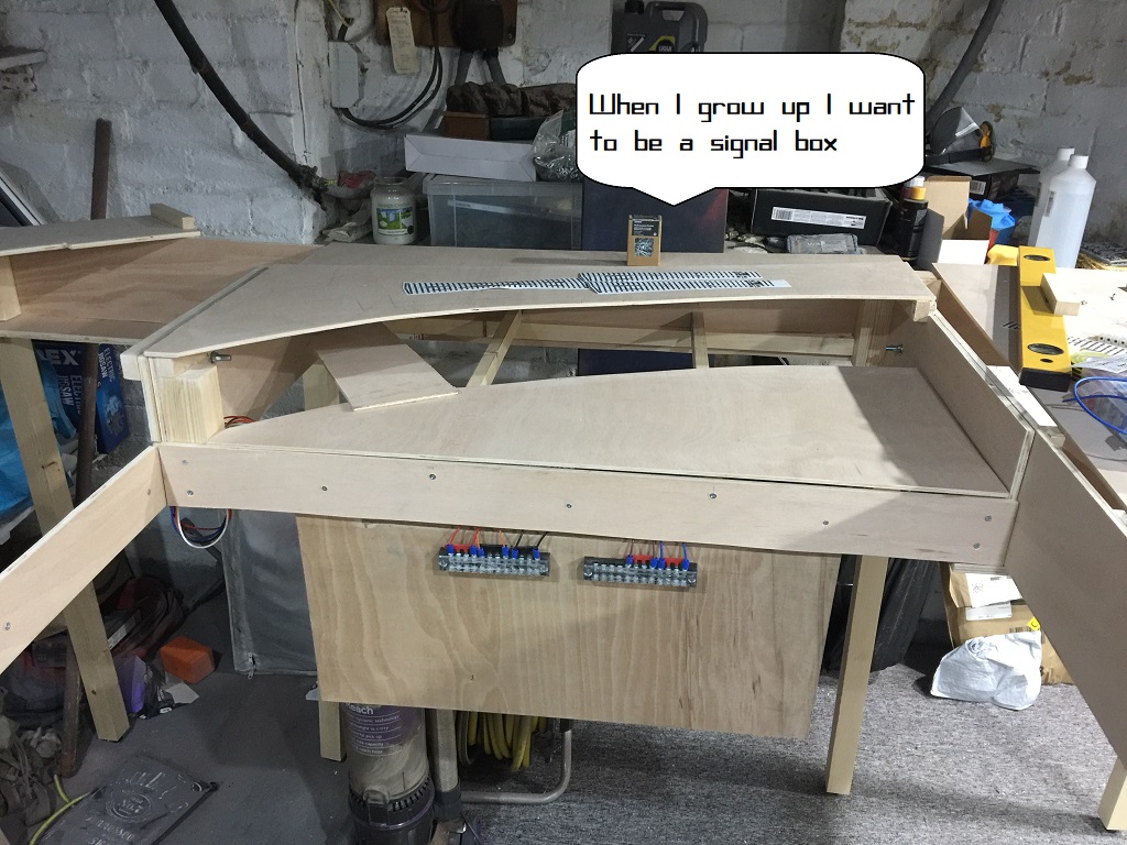

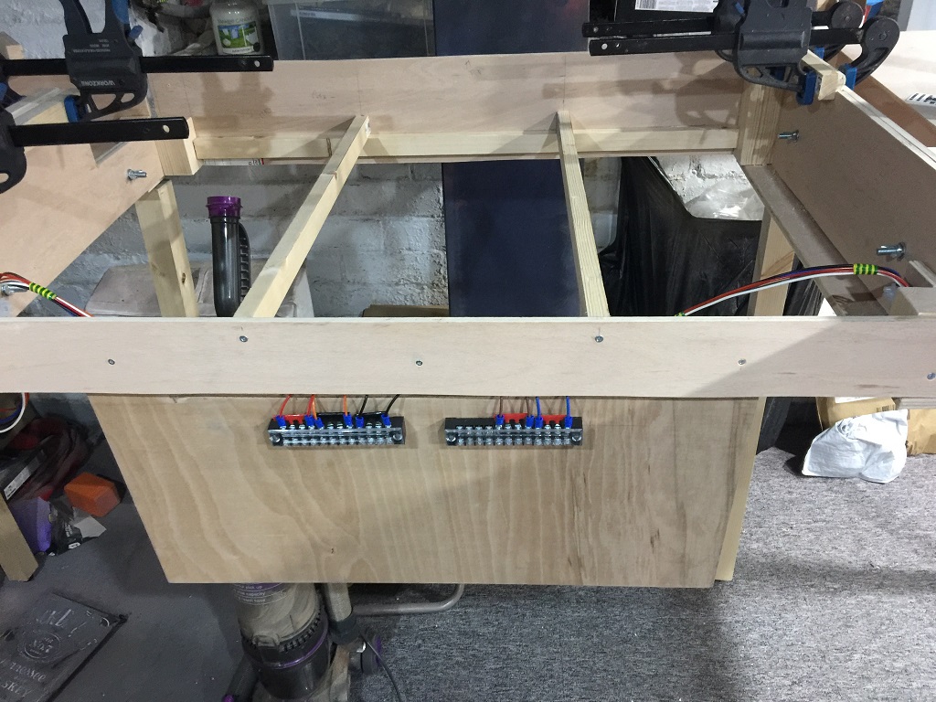

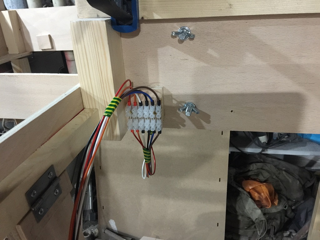

first job, add an electrical panel to board "E" (the first one to be worked on) and wire it up. this is a folding flap of 12mm ply (overkill but means its got enough depth screws don't go through and poke out)
Image http://www.aleopardstail.com/IMG_3045.JPG
so far only the bus wires in and out are connected, given there is no track as yet, or anything else, like power, this is not impacting operations too much. each of the connections has a wire in and out then six useful positions to connect to other things, for this board thats plenty.
also shows how the inner reinforcement will be fitted, though small cross beams (18mm x 28mm) couldn't make the frame on their own but really make the 9mm ply rigid, vertical supports can be added as needed and will support the upper deck at roughly 12" intervals.
simple 6 way plug & socket jumpers go between boards, this is the only one fully installed so far, and the other board isn't wired up yet
Image http://www.aleopardstail.com/IMG_3046.JPG
all jumpers will be identical and interchangable, the connection from the as yet unbuilt power board (waiting for the correct 5V AD-DC converter that can take the cables I have to arrive to build that). means any individual board can be powered up on its own for testing. boards have female connectors both ends, the jumpers are male both ends
the panel is hinged, it was meant to have a magnetic catch to hold it, the ones I have cried when I tried that, moving to a small sliding bolt arrangement.

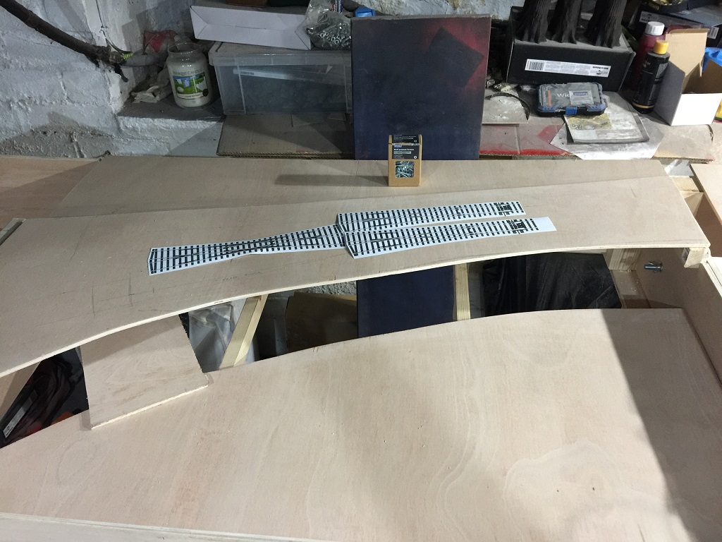

also started work on the track deck, this is not secured down and needs a bit more with a sander to smooth it
Image http://www.aleopardstail.com/IMG_3047.JPG
the lower area will be purely scenic, the bit of scrap is where a road will go under the railway level, which itself is a gradual incline. the board behind it will get cut in length, its going to be level, a bit below the track height but not much, signal box will end up here eventually with steps down to the roadway on the left. need to remove this from the layout to properly fit it and add the extra supports to make sure its all square as its slightly off currently, the scenic deck at the front will add a lot of bracing even though its only thin.
