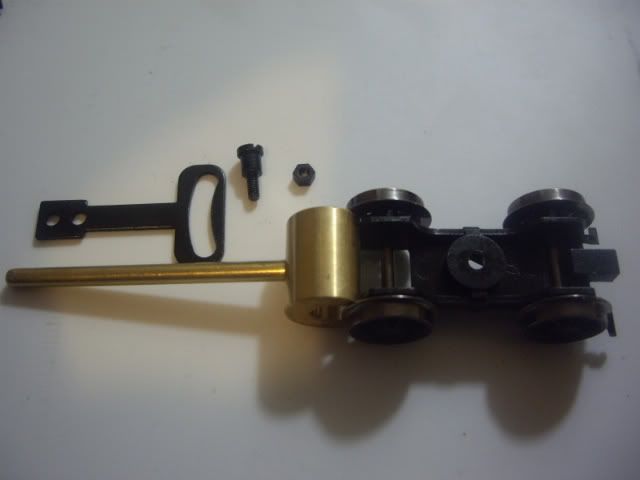

Thanks guys for the advise. I have found that the leading pony truck comes off at the points when run at very, very slow speed, guess the problem may be with the locomotive rather than the points, but even then it can be dodgy with some of the others. Perhaps there may be a way to tighten the screw underneath the loco, to make the pony truck tighter or loser?.

I had a similar prob with Hornby 60021 Wild Swan.47FAN wrote:Thanks guys for the advise. I have found that the leading pony truck comes off at the points when run at very, very slow speed, guess the problem may be with the locomotive rather than the points, but even then it can be dodgy with some of the others. Perhaps there may be a way to tighten the screw underneath the loco, to make the pony truck tighter or loser?.
A spring cut down from an old ball-point pen partly cured the prob [at least it will now take points .....as well as 2nd raddii curves] ....I also found that the "back to back" measurements of the front wheels has to be exact.

Bigmet always gives good advice, so if you can, ditch the set track and go for streamline in as large a radius as you can, The front pony truck: set track points have very large flangeways compared to streamline (which are also large, but better than set track), this is what is probably letting the wheels run over to the tip of the crossing vee. Also,the back to back measurements on Hornby stock, can be a bit iffy. If you can, measure the distance between the backs of the wheel flanges, this should be about 14.5mm. Another thing you could do with the pony truck is to glue a little bit of lead to the top of it. By doing it this way, you negate the chances of taking weight off the driving wheels, causing loss of adhesion (Sorry Terry).47FAN wrote:Thanks guys for the advise. I have found that the leading pony truck comes off at the points when run at very, very slow speed, guess the problem may be with the locomotive rather than the points, but even then it can be dodgy with some of the others. Perhaps there may be a way to tighten the screw underneath the loco, to make the pony truck tighter or loser?.
