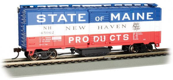

Anyone had ANY experience with these "Bachmann HO Gauge Track Cleaning 40' Box Car" cleaners in any way ?
I saw a couple (brand new) at a cheap price (far less than half of RRP) & decided "I'll just take a chance at that price".
My reasoning is, that, if I don't get along with them, I can always punt them back out on E-Bay -
Try one & keep the other unused & if I like it & get along with it, have TWO on the layout.
TBH : I only went onto the store website to buy a MUCH wanted "Bristol Hercules Engined" Mk.II Avro Lancaster - Made up postage with box-cars
Am told these track cleaners have = "Mildly Abrasive Pads" = To which I blanched & thought "EEeeeekkk"
There's no way I want anything "abrasive" going anywhere near my track(s) as ALL are brand new & as yet, virgin unused !!
( bought a fleet of brand new loco's AND as yet, unused track = All put by for retirement )
I toyed with the idea of knocking them off the order whilst on the phone - ( it took a while , meantime...)
I then reasoned that I could either change the pads to something NON-ABRASIVE as like, "in it's place", something fabric wise.
Forgot that phrase, something like "Mother invention of all necessity" - (apologies, as I cannot remember the full phrase ! :oops: )
But for the sake of £18.00 each, I'm more than keen & willing to experiment - They're FAR cheaper than most, anyhow.
Before anyone shouts "C.M.X" = I have a George "Whatsisname" (Dent ?), from Scotland track cleaner, "Schrage ?"
My apologies again, as my beer-addled memory is losing it's retentive capacity thesedays.
I just fancied a backup to the Isopropyl or Liquid chemical "Schrage" cleaner, as in maybe dragging around something like fabric type pads ?
** Along the lines maybe of carpet-tile fabric, but without the "hair loss" or risk of what Airfields call "F.O.D" foreign object damage.
I just don't see the point of putting "Abrasives" onto brand spanking new track, when they'll start life as clean as Virgin Olive Oil :lol:
If any of you CAN suggest a fabric type felt pad, or similar ?
I've heard folks talk about "Hardboard" ( chipboard ) chunks, but that just doesn't appeal to me.
I know the pads on this Bachmann lark ARE interchangeable - Was wondering what I might be able to fashion-up as a pad replacement ?
Sensible answer on a postcard, please.
Go easy on me, as I only returned to "Model Railways" since 2016-2020 (until Covid struck), so my knowledge is fairly scant.
I bought the George (Dent ?) whatsisname "Schrage" cleaner on someone else's recommendation.
So as you can probably tell :oops: I'm out of my league on the great quandary of "Track Cleaning"
P.S : Just remember, "Abrasive" is most definitely "out" for me, as far as I'm concerned...

Well, they've arrived & TBH, they look really decent for the money I paid for them, brand new - £18.00 each
They do appear to be really well made, far more solid than I thought they'd be.
Perhaps the only exception might be the plastic cantilever arms - Not sure how durable they'll be, long term (?)
My major concern was "Are They Abrasive" = I wasn't 100% sure until they first arrived...
Guy on the phone taking the order said 'mildly abrasive' & I was a bit "Johnny on the spot" but decided I'd give them a try.
My reasoning was, that I could or might be able to make my own adaptation of the pads, to something "non-abrasive"
In the end, my fears were ungrounded - The surface looks like a hardened styrene foam padding - certainly "non-abrasive"
That made me super happy
Bear in mind the replacement pads (so I'm told) are £13.00 a set (pair) & I only gave £18.00 for the wagons brand new.
Intent is to "push" them round, rather than pull them (!)
Not saying they are a miracle cure, just they look better than expected - Will use in conjunction with my "Schrage" cleaner & IPA
