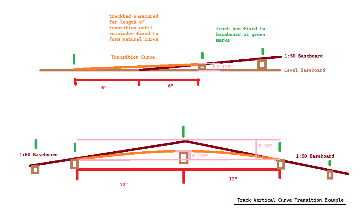

Done a bit more reading on this, this has suggested allowing roughly 10" per 2% gradient change, I have eased slightly to 12" as I think its tidier
Image http://www.aleopardstail.com/vertical%20curves.png
roughly illustrated thus (MS Paint for the win!)
showing a 2% (1:50) transition from level and a "hump" (could be inverted to be a dip)
the net effect is that if you know you have say 12' of length for your gradient, when working it out deduct 6" at each end, then divide the desired height change by that distance to get the gradient allowing for the ends
apparently someone (someone other than me) did the mathematics behind this and this should mean that rigidly fixed wheels with no flex don't see the flanges go above rail height, noted that exceptionally long rigid wheelbases may need longer and shorter (e.g. diesel bogies) can handle a shorter transition.
in crude terms that can be managed also by having say a 12" length of track without track pins and letting it find its natural curve

aleopardstail wrote: Fri May 17, 2024 11:45 am Done a bit more reading on this, this has suggested allowing roughly 10" per 2% gradient change, I have eased slightly to 12" as I think its tidier...
Allow as much as possible, I'll not have anything more than 1% change per foot. (I have ten coupled rigid chassis, long bogie frame diesels, and carriage stock with close coupling mechanisms to contend with; and then there is the trend to reduced flange depth in RTR OO as well, increasingly finding 0.6mm flange depth.)
aleopardstail wrote: Fri May 17, 2024 11:45 am ...in crude terms that can be managed also by having say a 12" length of track without track pins and letting it find its natural curve.
Inadvisable as even a modest 500g loco will flatten the track for a good 6" and then face a vertical 'kink'. Creating the natural vertical curve with a thin ply strip so the track is fully supported throughout is way superior.

Bigmet wrote: Fri May 17, 2024 3:20 pm
sounds good to me, there is space to easy it out a bit, its technically something like 1:52 currently so a bit of easing should work, means the main gradient is a tad steeper but easy enough to arrange
