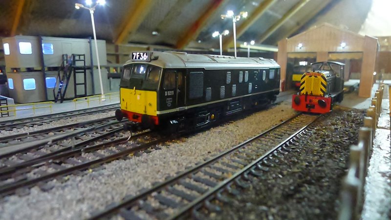

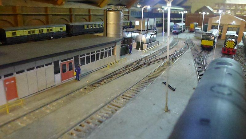

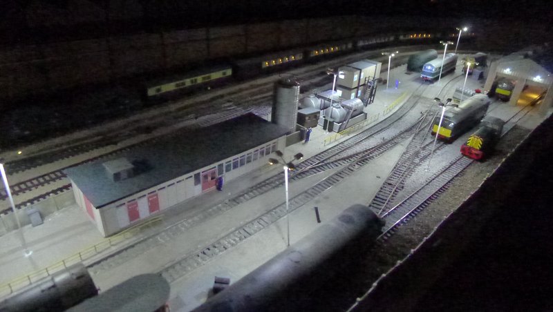

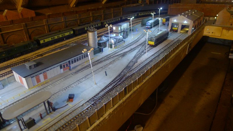

Whats this? An update? Yup I am still alive. What with Covid, losing my job at MLP, getting a temp job, spending 3.5 months on furlogh (this was great by the way), doing up the house, sulking over missing out on the champions league, some awful personal stuff,losing my agency job, regaining a job at said agency company and this week being confirmed as a full time employee, I finally had an idea of doing a layout update and then realised that all of my layout posts are sitting under a tree somewhere getting drunk and not wanting to know. So here it is in a sort of resurrection kind of way. I decided to change the diesel depot

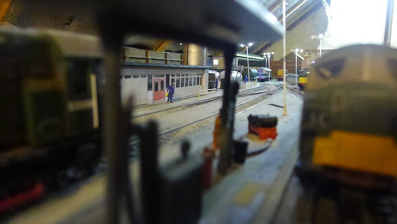

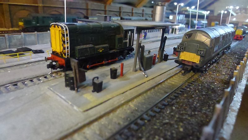

so I installed some new smaller lights and removed the single very tall light that I habitually damaged when cleaning track. The crappy old paper portakabins have been swapped with the Knightwing equivalent. Gaze upon my depot loveliness.
The original depot building was replaced with a better made building with some kytes lights

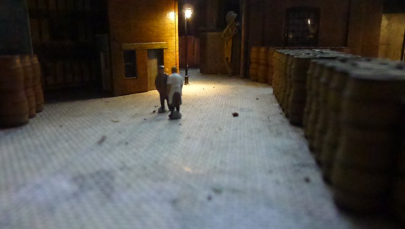

Some barrels and stuff at the south side factories

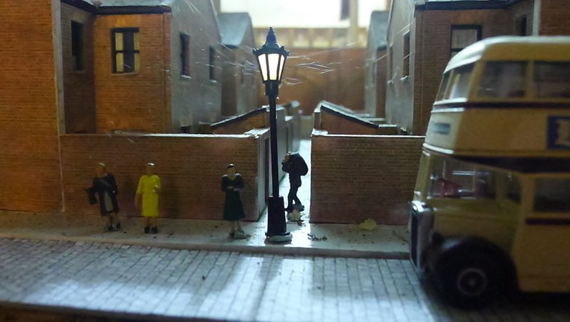

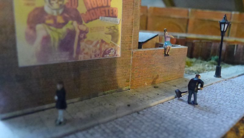

Some people have also appeared

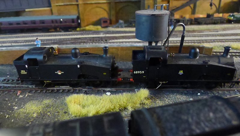

A couple of new locos including the J36 and 6 new suburban coaches. This loco is outstanding with ultra slow movement capabilty and a J50

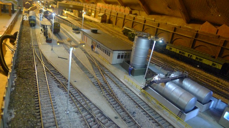

Nice to see this splendid layout again.
The depot looks very good.

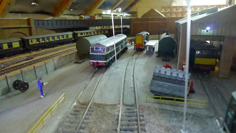

Loving the work on the depot. The potrkabin kits look really good.
Also, where did the tall yard lights come from? They are very effective
Dan
Dan
My Layout Thread: http://www.newrailwaymodellers.co.uk/Fo ... 22&t=30117
Re: Leicester Fosse (Central) Sishades new epic
They are from layouts4u and are PL4 - Plaza Lights. They cost about £6 each, and are rather sturdy. The wires are pleasingly thick so wiring them up is a doddle.

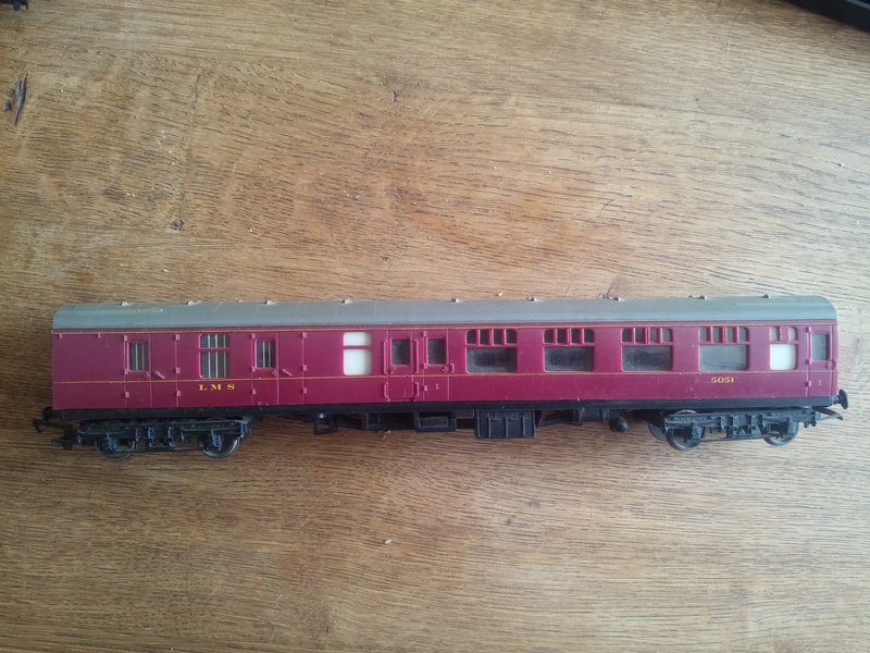

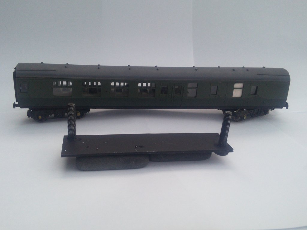

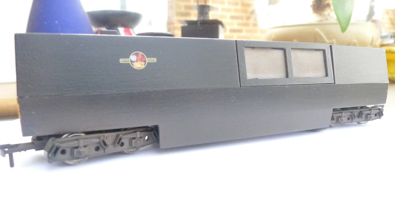

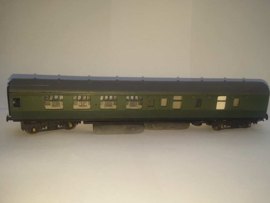

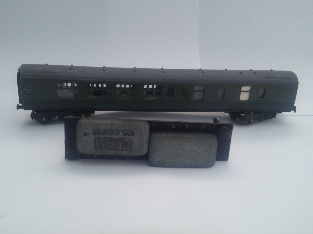

Anyhow building these airfix/revell/trumpeter kits has gotten me excited about doing some model making for the railway. I have a cleaning train which includes a CMX wagon, two triang cleaning wagons and a dapol cleaning wagon,
the latter being completely useless but is a good vacuum cleaner. I also use a track rubber for those grimy parts, and also have an old hornby triang LMS coach which must be almost 40 years old sitting on a shelf in my kitchen.
I purchased two Peco track rubbers, (no picture as I'm sure you all know what they lookl klike anyway)
I stripped down the coach parts, cleaned them up and sprayed the sides in WW2 Luftwaffe colours (dark and mid tone greens). A small cradle from plasticard, 2 bolts, some super glue, replacement glazing and voila.....A Luftwaffe track cleaning coach!!!
Here are some pics taken in bad light and with little photographic skill.
I have yet to test it out, hopefully this will get done in the next few days after I get back from my train trip to Barrow. Oh did I mention that LCFC won the FA Cup?

My last report concentrated on a small project to convert an old carriage into a track cleaning device using a couple of Peco track rubbers. I forgot to take the height of the rails into consideration and the coach wobbled so a colleague at work machined off a few millimetres and hey presto it was despatched to my layout, behind a "Baby Deltic" Class 23.
Despite its weight, the 23 had no problem pulling the carriage around the layout and it worked very well indeed. I now have two track cleaning trains, the other consisting of a sound fitted class 50 pulling a CMX wagon, 2 triang cleaning wagons and the above mentioned Dapol wagon. This can be seen in the opening two minutes of the above video.

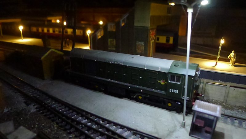

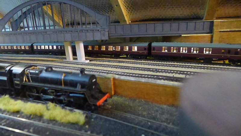

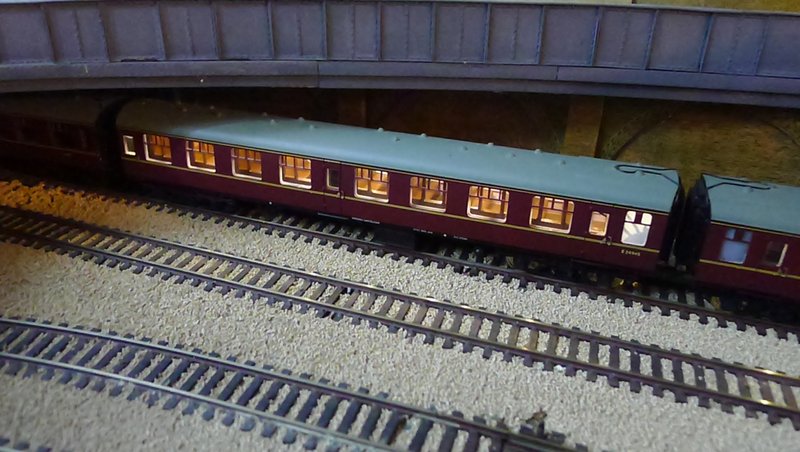

Next up was a rake of BR Maroon MK 1 coaches, and to these I added lights. This took a while as taking these carriages apart was a bit nerve racking due to the thin wires at the ends. I initially used wheel wipers from DCCConcepts but they produced so much drag the train would not run. So they were replaced by coiled pickups that are inserted onto the wheel axles. It looks very impressive in the dark, but I do think they lights are too light. These were advertised as warm white and came on a five meter strip of LEDS.

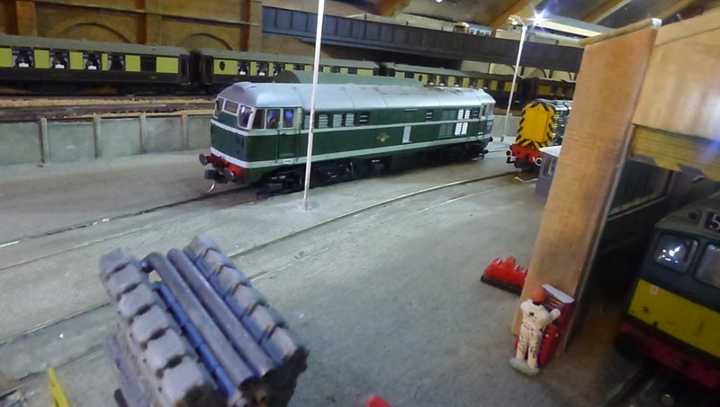

The biggest change to the layout has been the redevelopment of the diesel depot. I have replaced the buildings, changed and weathered the hardcore areas, and added some smaller details to give it some life.

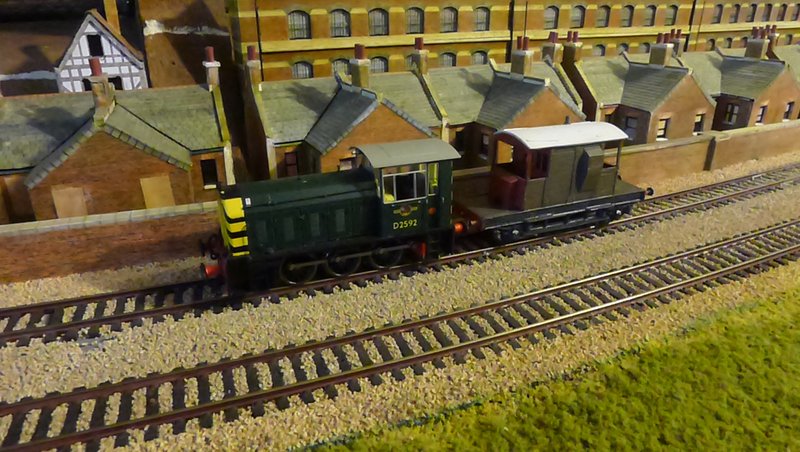

Some more pics of the layout

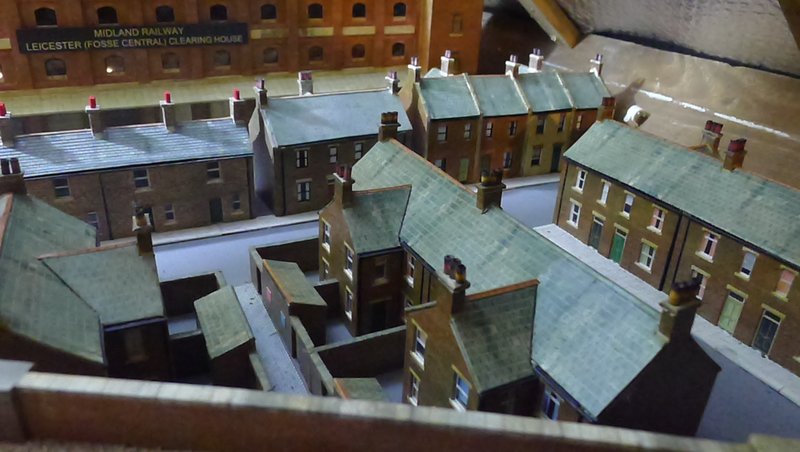

This is at the very back of the layout and does not contain any people as the building are barely visible

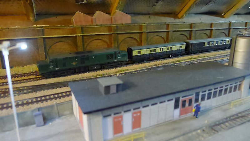

A class 37 pulling my new pullman liveried wagon as used in the Winston Churchill funeral train

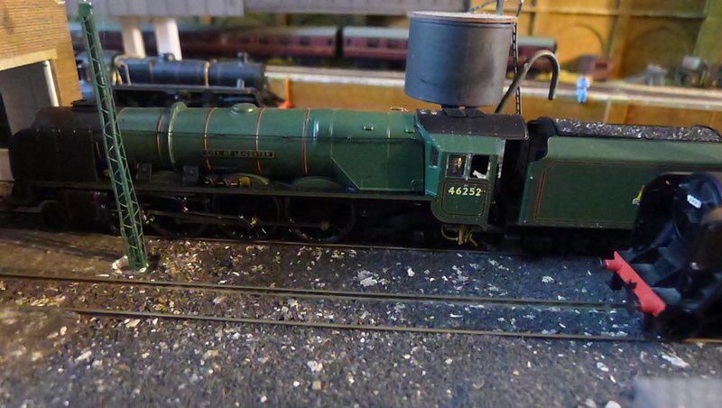

My new all die cast special edition "City Of Leicester" with sound. Weighs a ton and is simply superb.

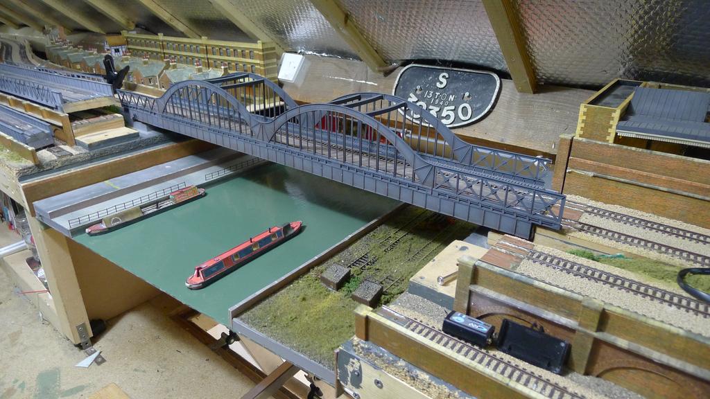

The scenic section under my bridge is now gone and I am going to redo it. Over time it just does not feel right and I have a plan of how this is going to look.

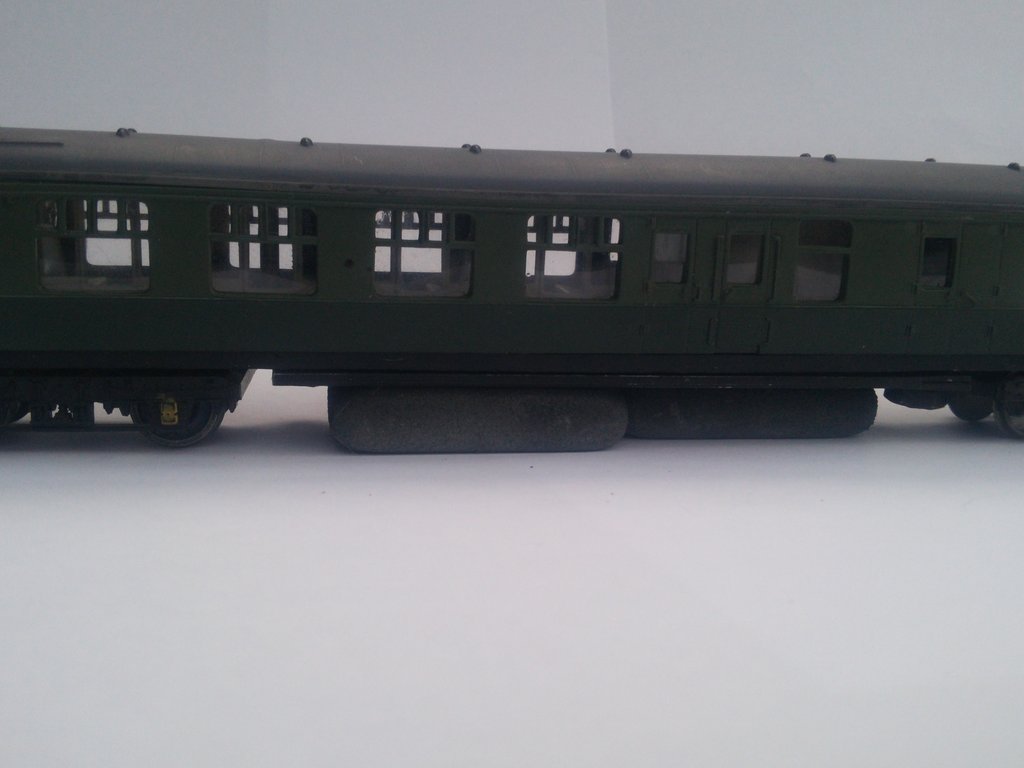

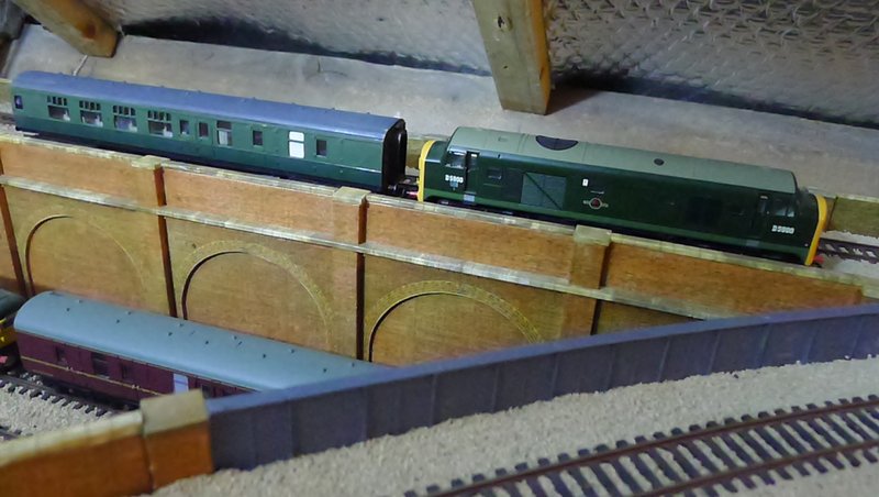

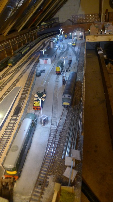

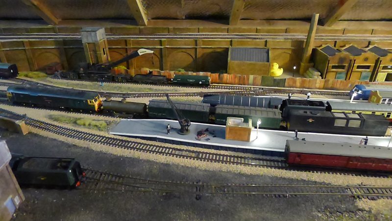

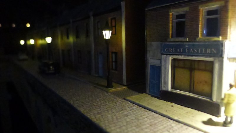

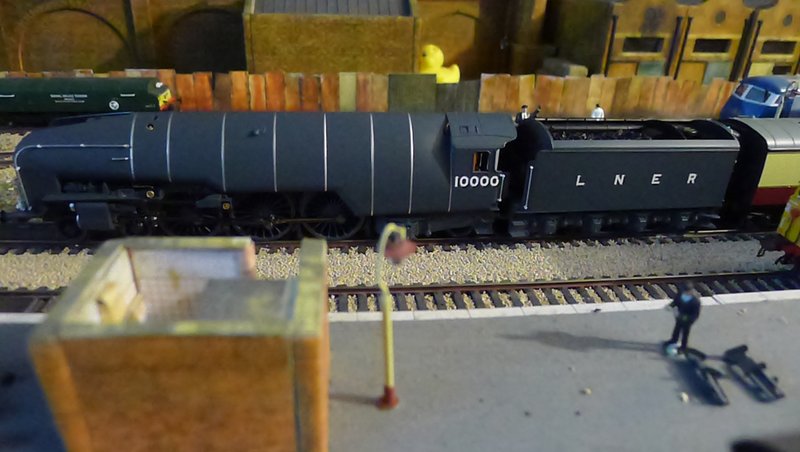

My new Hush Hush; sadly I had to remove the steps in order for it to run around the layout without crashing into my platforms as it very wide. It is sound fitted, runs like a dream and is a wonderful model. However the track must be level, and I have one small dip where it just "hangs"

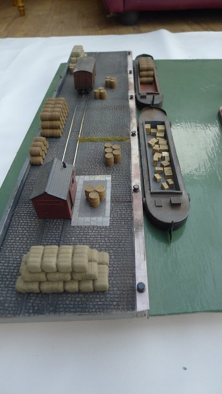

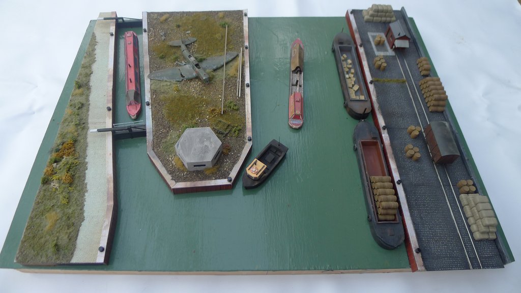

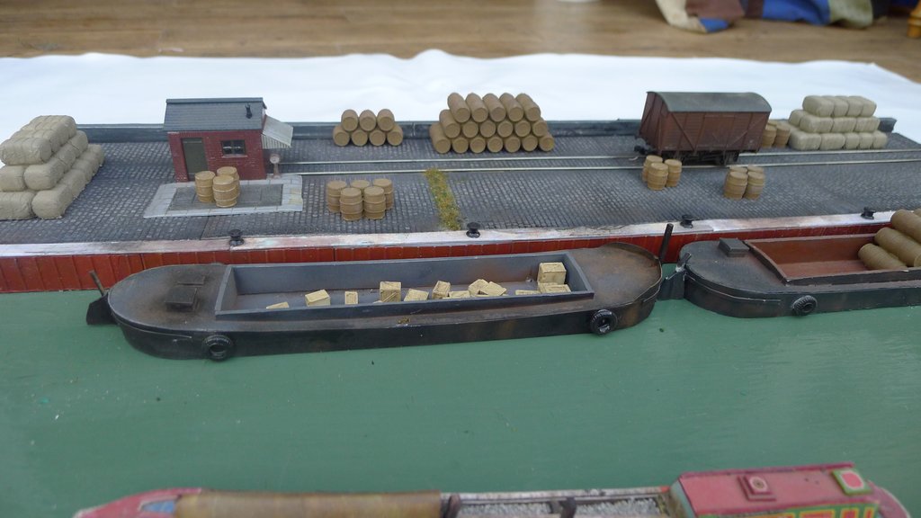

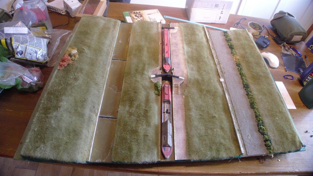

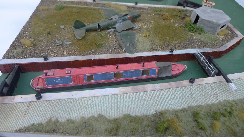

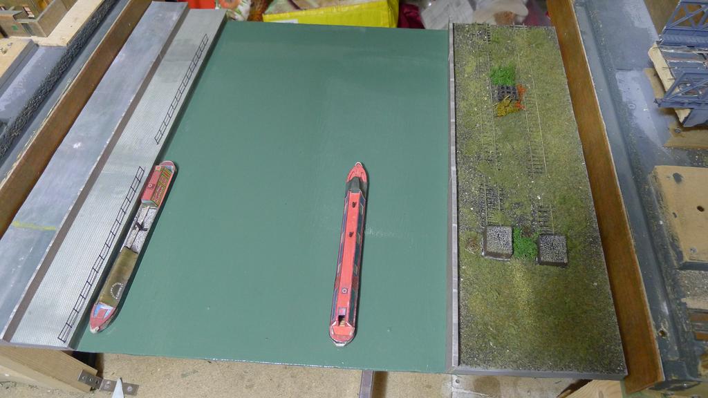

Anyhows, having said that the World Cup is on, taking place in a desert with some camels and a skipful of the worlds oil. While I wait for the England Vs France game in which we will surely be booted out of Qatar i decided to do some railway modelling for a change. I had a few hours to spare so what to do. In the above posting, a canal type diorama is placed under two bridges. This received some mixed reviews as the previous incarnation had a small canal going through some lush landscape and a road.

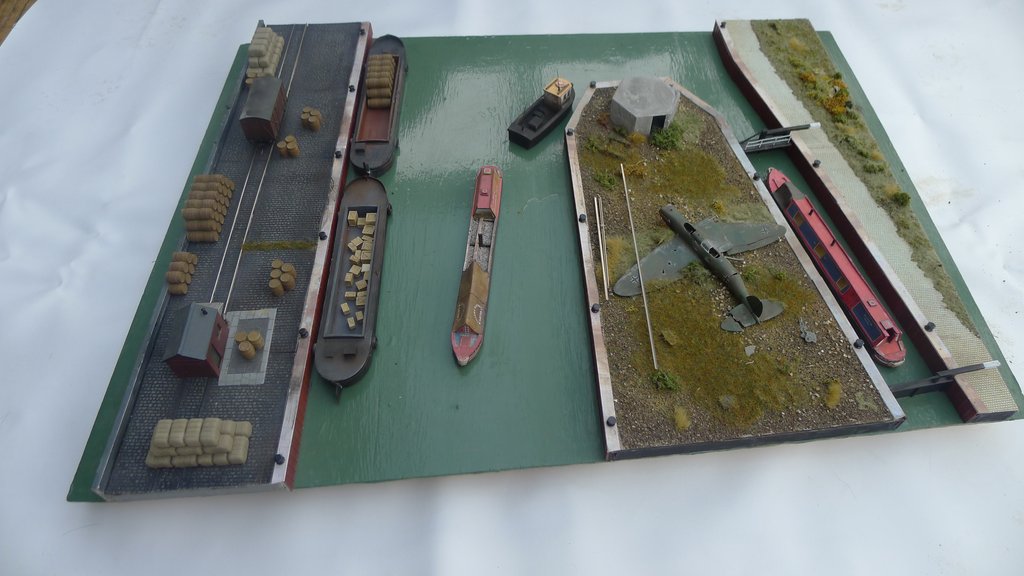

and replaced it with this
Sometimes one has to look into a mirror, raise a finger and say "You dick, What were you thinking?". What a pile of shite modelling that is. The original was light years ahead in terms of build quality, atmosphere, imagination and build quality. So armed with a brush, an apron, a small pot of UHU glue and a ruler, I set to work. A few minutes later I came up with this...............
Just realised that I have forgotten to put a loco on the rails in the above and remove the shiny rails from the centre island.
My next step is to put it onto the layout and hope that it fits.
The lock gates are scratch built from plasti card, the cobbles are wills sheets applied with various weathering techniques, the boats are scalescenes, the weighbridge is a kit, the pillbox was scratch built, the rust on the wall sides is made by various red and orange oils paints.
Is it an improvement? Could it be any better? Or worse? Is it OK? I value all opinions and maybe next time I might take notice!

I like the improvement.
Much more to look at.

Although they may exist, the wide canal looked too wide! It was my first impression when I saw it. I think the first iteration looke quite realistic to be honest, but yes iteration 3 is much more interesting. I approve
