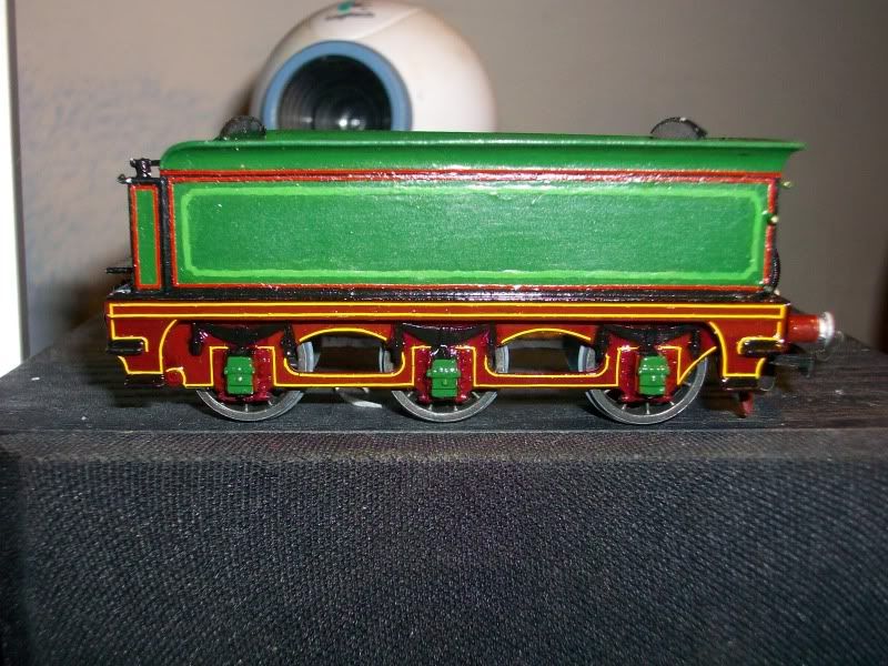

I just can't let it alone ....... or anything to put off having to add the lining !!
Added pipework on the westinghouse brake air system, added grab rails at the cab entrance, both from 15 amp fusewire. A pipe into the smoke box side (dunno what it was ?) and having removed the extended coal bunker top (not there in my photo) I've adder a rolled top, both from 30 amp fusewire.
Soon I'll HAVE to add that lining and touch up the paint - particularly the red/brown as the blue undercoat ruined my mix job !!

I'm peed off ...... don't know how to 'work' the HMRS pressfix decals. As the decal is on a thick gummed sheet you can't see through it to line up corners and joins with the accuracy I want, nay demand. I've asked on RMweb to see if any more experienced guys can offer suggestions on how best to use these. Probably have to remove the corners and lower line as I'm just not happy. I won't be happy until the standard matches what I would expect to obtain with waterslide decals.
Gonna put it all away .......

I can understand how you feel Geoff .....I even had trouble lining a set of HMRS Pressfix numbers upDad-1 wrote:Hi rocketman,
I'm peed off ...... don't know how to 'work' the HMRS pressfix decals. As the decal is on a thick gummed sheet you can't see through it to line up corners and joins with the accuracy I want, nay demand. ......
I mean ..
But whatever the answer is .....its got me beat .....
best regards
T.

Ive used the HMRS Transfers on all of my locos i make i don't have a major issue, there not like waterslide where you can move around as you have found out. You can still move them around by keeping them wet, and using a blunt implement to gently pull it to where you want it.
Other way of doing it is if you line up the beginning and only press where its lined up with and then just let the rest of the line rest of the line left loose on the surface and then get a paint brush and add water, the transfer again with a blunt implement can be moved easily but gently as they break easily.
Ill be in MK tomorrow if any assistance is needed
I have been using HMRS Single lining sheets for a while once you get the nack of it, it will come out fine. Heres a recently finished tender for my C-Class with all HMRS transfers applied, all single straight lines which are gently coax in to place and shape.

Hi all, particularly mattmay05 the one who knows how to 'work' these ......
When first reading the instructions it seems to indicate you cut through the protective covering paper, into, but not through the backing paper and lift off. Well there's no way the tack of the subject will stick enough to that protective paper to lift away the subject pulling some of the gummed backing paper with it.
Now both the protective and backing papers are so thick that I can't see through with enough clarity to work with either in place.
On RMWeb Mikkel seems to show that you remove the protective topping paper, cut around the subject, but not through the backing paper. Then lift off with the top surface of the backing paper. Well I tried that last evening and the integrity of the backing paper was too strong to lift just a layer away, and anyway the very top layer is in fact the Gum Arabic ? All that happened was that I destroyed the small piece of decal I was attempting to remove.
I have red-white transfers on the sheet I can experiment with and as I have no use for these should I destroy them all no real loss !!
My other thought was to use as I have done with 'difficult' waterslide transfers. That is to first add some watered down Krystal Kleer glazing meduim (rather a refined PVA for making windows) to the model. Cut out the subject complete with full backing paper, wet and slide the transfer onto the fluid layer in roughy the required location, then move into exact location while floating on the fluid before using a tissue or dry paintbrush to suck off most of the fluid. I use that technique to put some - particularly Czech Propag aircraft decals that grab on contact to high gloss finishes never to be moved again !
Mattmay05 I'm tempted to ask for a little of your time - only the wife is out at present and I seem to recall her saying we had to go to Northampton on Tuesday for some Christmas shopping !
I'm off to try some experiments on scraps of plasticard.

Theres various ways of using the HMRS transfers some people have their own ways of using them I have mine.
I agree the transfer paper is quite thick but with a decent light you can aligne it ok. Again may need a bit of coaxing to line up.
To get the transfer from the main sheet you use a craft knife or a stanley knife, and lightly cut round the lining using a straight edge and then use the edge of the knife to lift the transfer off the backing and use a pair of tweasers (not wifes) and peal it off the main backing sheet.
Then i use my method of fixing it in one place and leaving the rest lightly laying on the top to position it.
If you do require a bit of assistance, then ill be probably be in MK today and maybe next monday, or otherwise PM me and we will arrange something as Im located all the way over in the dump of Aylesbury.

Geoff, megga admiration for what you are attempting there. You must have the patience of Job or Jobe if you like.
I can say that if it had been me in your shoes the lot would have been out the window by now.
Good luck mate, I know you will crack it.

Have you considered a bow pen instead of transfers?
