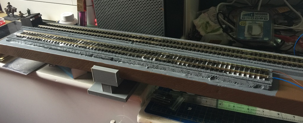

"layout" update..
cellar ceiling has gotten as far as it will in the near future, just needs painting now. will be mounting a 4' support shelf tomorrow, which also needs painting, may have a run to get the bits to start board construction Sunday.
also, the test plank has gotten an upgrade
http://www.aleopardstail.com/IMG_3026.JPG
short straight parallel section added, to use as a DCC programming track. with the bits to create a new DCC-EX++ base station on the way to arrive over the next week. this may, or may not gain buffer stops (probably will eventually)
