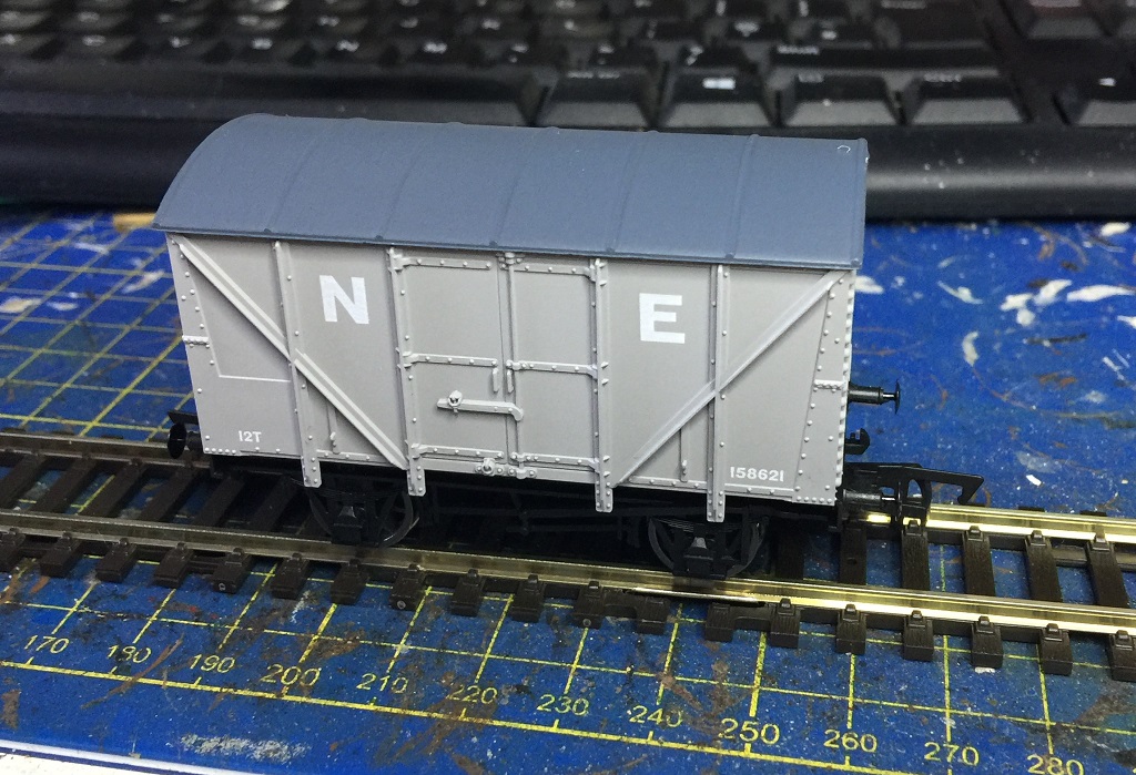

A few new additions, honestly not even finished clearing and preparing the space for the layout yet, I say its all to aid "planning" *cough*
first up needed some wagons, partly to get the size of them right for train and siding lengths. Got a triplet of these Dapol NE Banananannanna vans
Image http://www.aleopardstail.com/IMG_3012.JPG
couplings look a tad iffy however a very reasonable price from TMC with the May Day sale

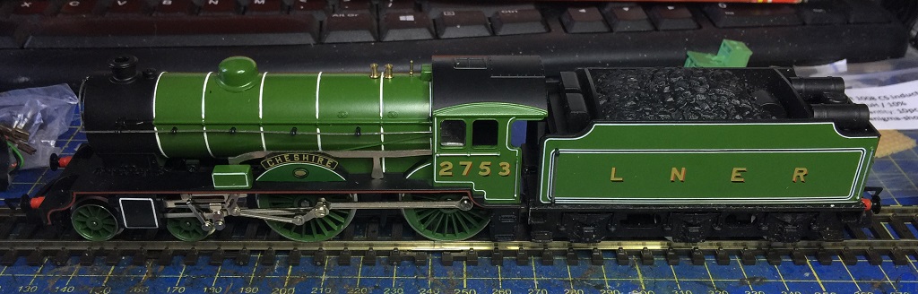

finally for pictures, a Hornby D49
Image [urlhttp://www.aleopardstail.com/IMG_3014.JPG[/url]
very nice looking, needs slight paint touchup in a few areas of the underframe though this is hardly a critical issue presently

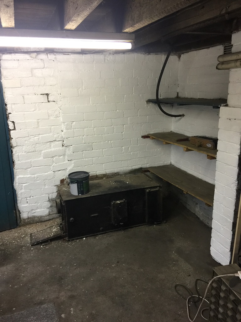

cellar now has third coat of paint, having a dehumidifier down there seriously helps with paint drying
Image http://www.aleopardstail.com/IMG_3017.JPG
this is the corner I've been working on, ceiling about will get some plywood cladding and recessed lighting to replace the strip light that is at just the right height to bang my head on.
that bulk on the floor is an old boiler, this will get a plywood enclosure to go over it.
that end of the layout will be supported by a small shelf on wall brackets with a retaining lip. will go a bit wider than the wall to part obscure the door (which doesn't really go anywhere except a small storage space) the layout able to be removed should it need to be and will extend towards the camera 12' to about where I was standing to take the picture.
there is more wall still to paint, a second old boiler etc to remove but I'm planning to make a start with the layout before finishing it all as can get going with the first 4' reasonably quickly, and while the frame will lack decking it can have a few sheets just resting on it and the test stuff moved down there

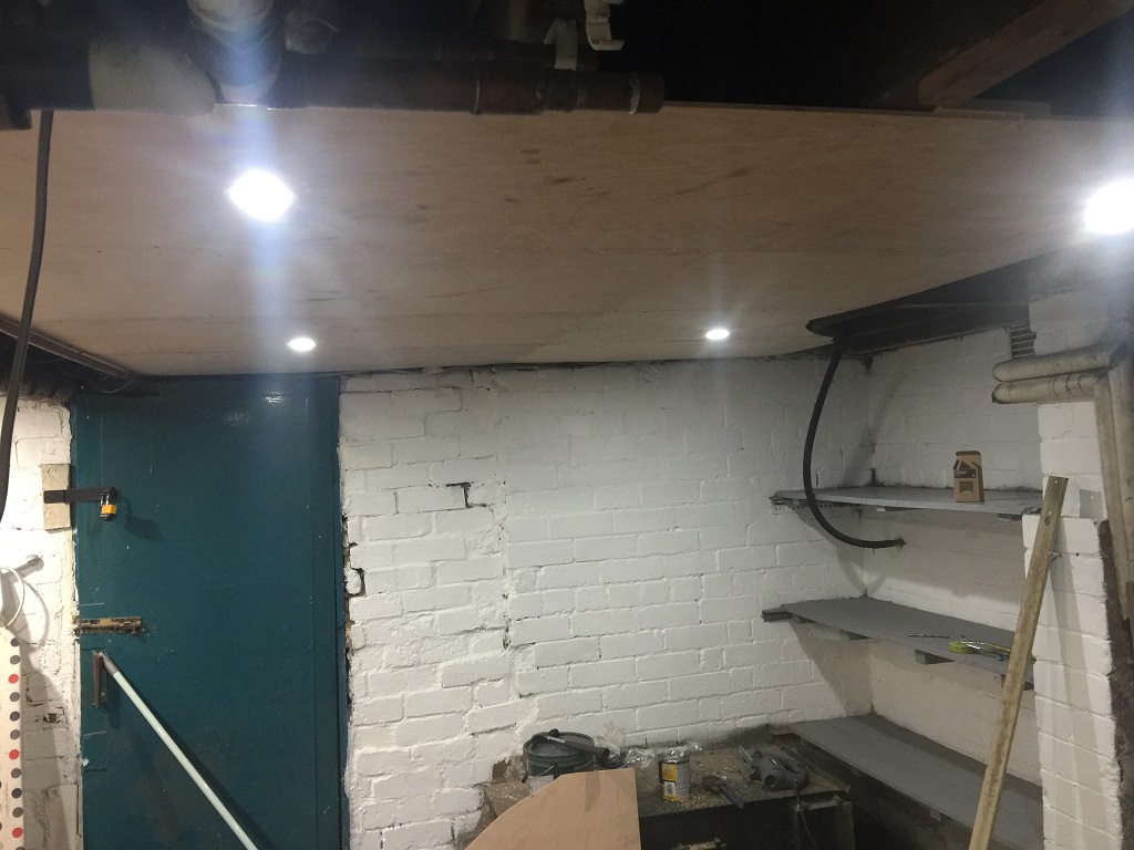

More prep work in the cellar, today saw 7 sheets of 6mm plywood added to clad the ceiling, an old strip light removed and four LED downlights added. gives me 8' of clad depth once a few side bits are done.
Image http://www.aleopardstail.com/IMG_3019.JPG
needs a lot of cleaning (job for during the week) and more painting (ditto), ceiling painting I was going to leave until the rest is done, and may still do, well the rest of the cladding at that end at least. will get the cleaning done and those shelves at the end finished though
out table top gaming Thursday evening.. which just so happens to take me past Wickes where a couple more plywood sheets may find their way into the car.
starting to plan out the baseboards, the fiddle yard side will have a pair of solid top boards, as will one of the two small end 2'x2' boards, I think the rest will be open frame as there won't be much if any level track on them to ease the main gradient to hopefully ~ 1:50 with a 5" rise (3" to clear track and trains then a further 2" to allow for point servos etc above the lower level)
