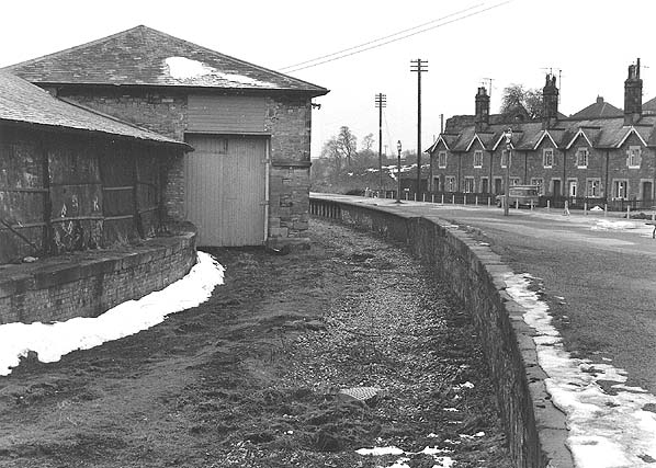

From my survey of the area around what was Richmond station on a very dark and wet Saturday afternoon (the river was fair gushing), I think I might make this my first go at scratchbuilding:
Best pic I could get of the railway cottages was this:

Nice job ParkeNd, you'd never think they were so small without the 20p piece shown. It looks like you've built them on a base. I have the David Rowe 4mm architectural modelling book in which he recommends a 9mm plywood base. I was thinking this would be overkill in 2mm. What did you use? The daler board?
