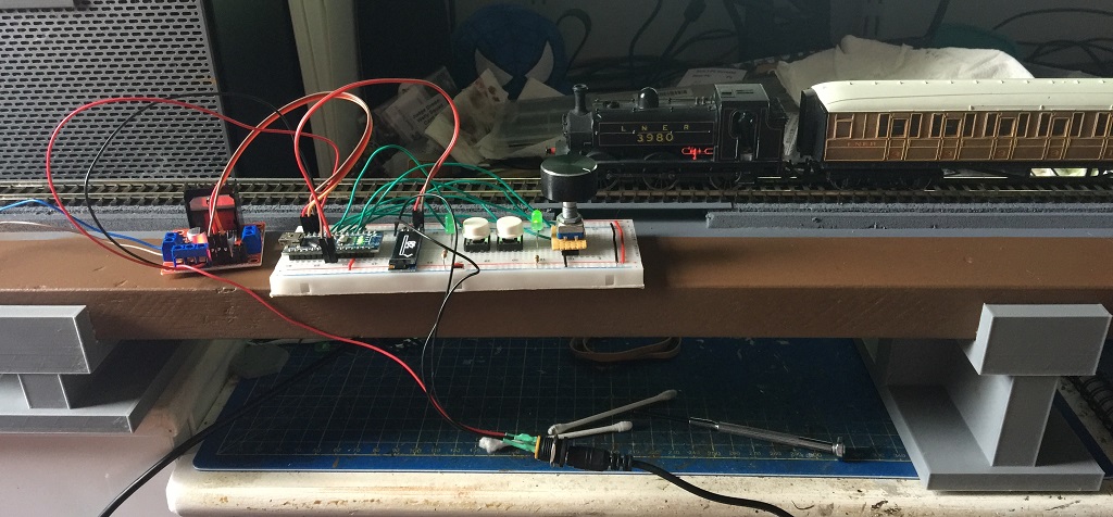

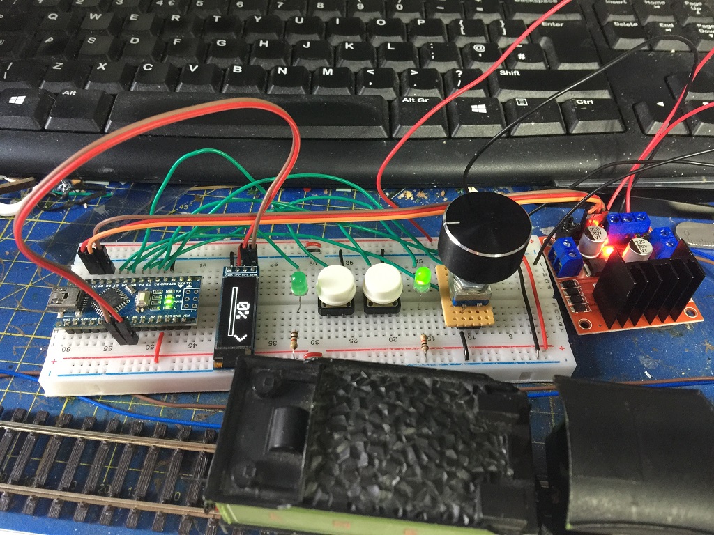

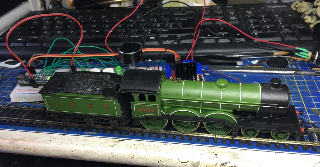

B12 experimentation, runs nicely, gave the brushes and motor a clean and ran better. amazingly noisy with the body on, a lot quieter without, have to check nothing is rubbing.
and also the somewhat rough & ready controller driving it
An Arduino Nano driving a L298N motor board. added a twiddly bit and a couple of buttons for speed and direction (pressing any of these also stops the motor dead). and a little screen showing current setting. seems to work

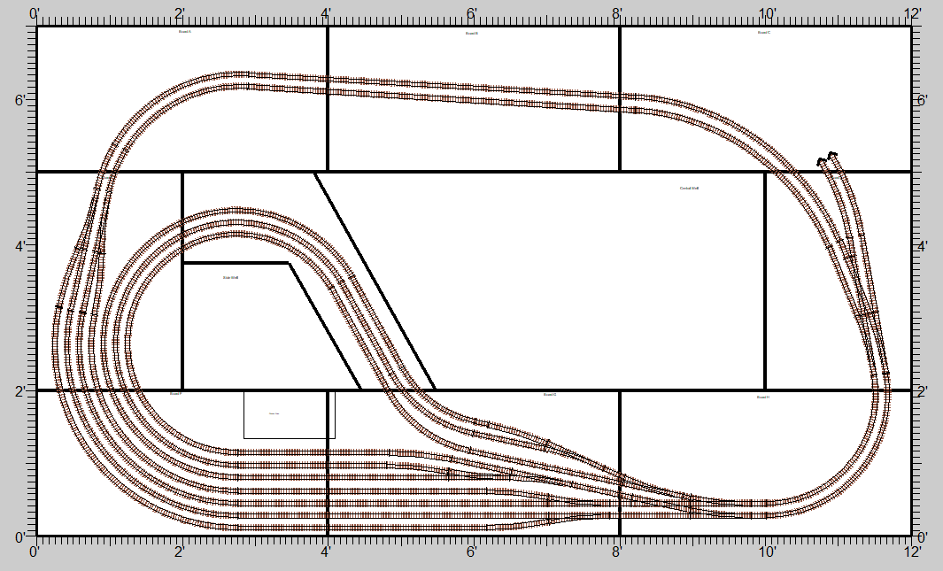

Bit of measuring up, once its cleared a 12'x7' board will fit, so long as it can be dismantled a couple of times a year.
had a think and this is the rough concept for the lower level, the tracks top right go to an incline that spirals round to a high level terminus (plan up in the air still but more or less a "minories" style station with a small loco turn table and fuel point added and a run round on a goods loop.
what we have is a pair of running lines, clockwise and anti clockwise, each of which has a reasonable length loop - this holds a "through freight" train than can be circulated occasionally through the decently sized scenic area as well as a normal running line. these loops are a good 7' of usable space which is considered to be enough, could be expanded but probably won't be.
there are then three reversing loop storage roads, each of which can hold a pair of four coach trains with a decent locomotive, maybe five when its finally worked out - this being the maximum length for the terminus.
operation is intended, eventually, to be largely automatic on this level. train comes down from the terminus, the auto system takes over, it runs a circuit of the track then gets parked up, another one comes out, does a circuit and goes up to the terminus after, this being in parallel and potentially more than two moving at once.
its kept intentionally simple, will be operated from outside at the edge along the bottom of the image, the central wells being for construction and maintenance only (this area also provides access to a work bench so has to be kept clear anyway).
I did consider a station, maybe just a through one on the scenic side but went with "less is more" and will be just plain running, signalled at either end as a single block each way.
its basic, its intended to be basic - shown with PECO large radius streamline pointwork and crossings, the operational interest is the station, specifically turning trains around to make space for the next one thats due before it arrives, this lower level is really just a glorified return loop with through run options.
I did think about extending the through loops, the outer one is easy, the inner one could be done by changing a diamond to a single slip, however they won't be long enough for two longer trains to be held so likely staying as shown here to make operation easier.
arrival and departure from the loops in parallel is possible and departure can coincide with through running
open to suggestions and comments.

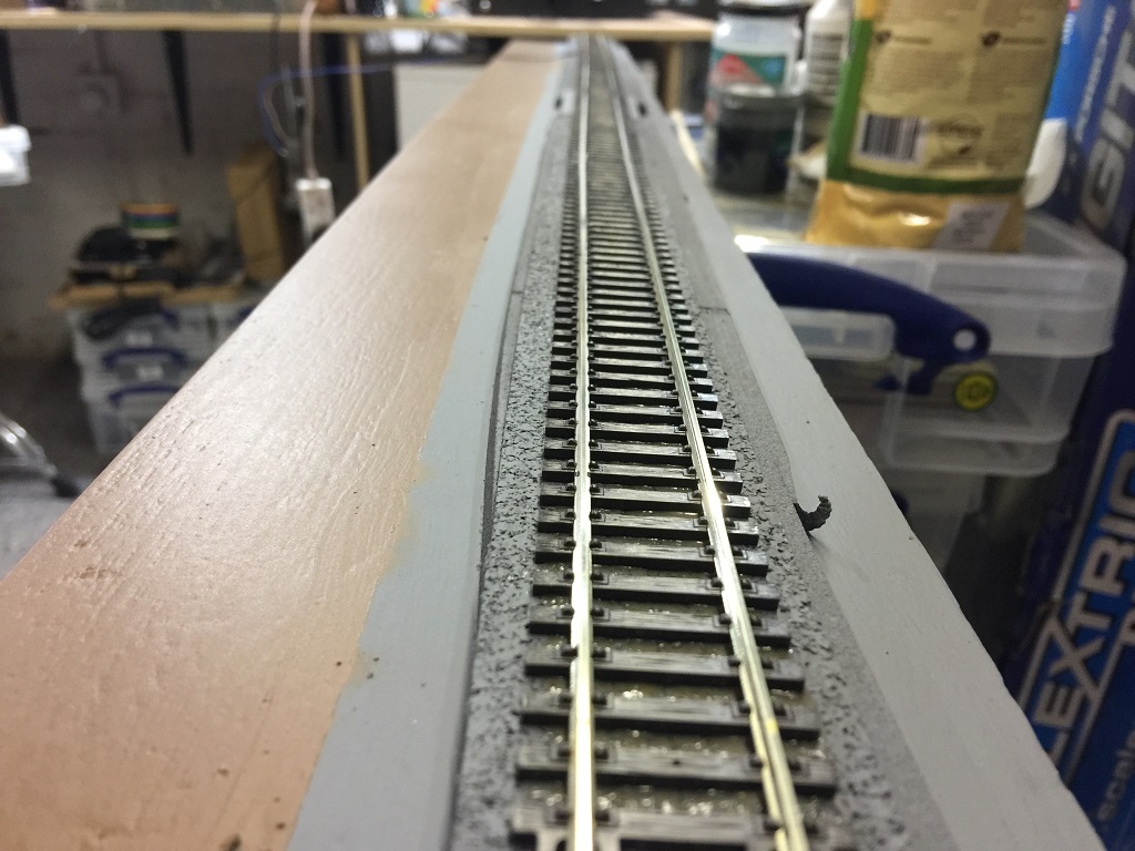

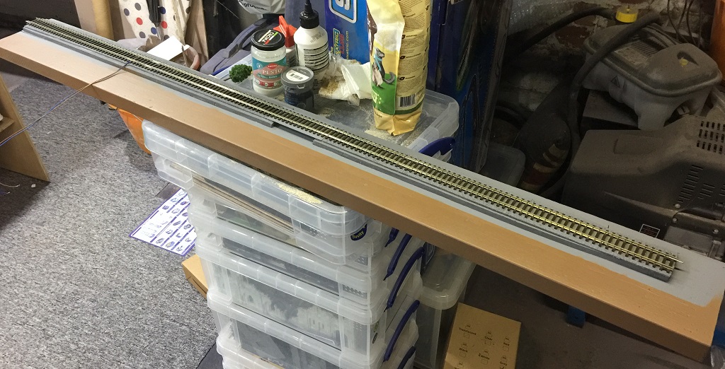

A "layout"! actual progress...
well ok an old shelf, a bit of XPS, some cork, about three and a half foot of track and a bit of paint, but its the principle of the thing.
discovered it won't sit flat on my desk, easy fix, have a pair of brackets printing that will raise the end by differing amounts to make it level, also buffer stops on order.
the cut out is for adding an RFID reader to experiment with.
moody "long road ahead" shot, cellar desk in the background, complete with that most important of things for such endeavours, a fridge for refreshments of the liquid sort.

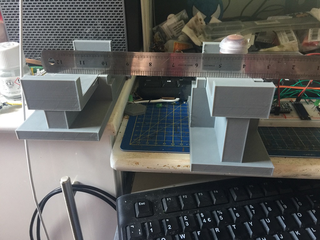

stands for the test plank to hold it level between the desk and adjacent cabinet
designed in Blender and 3d printed on an Ender 3 V2
"good enough for government work"
need to wait some glue drying and should be up and running later today
