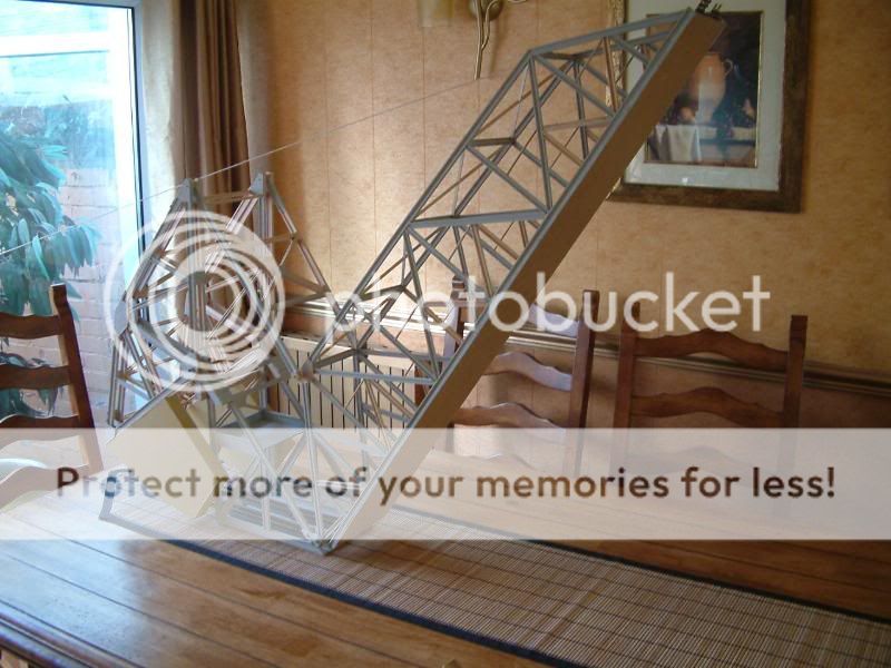

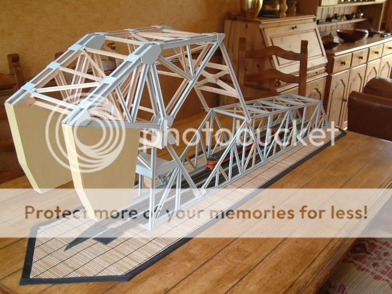

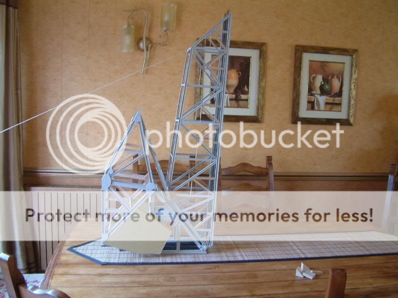

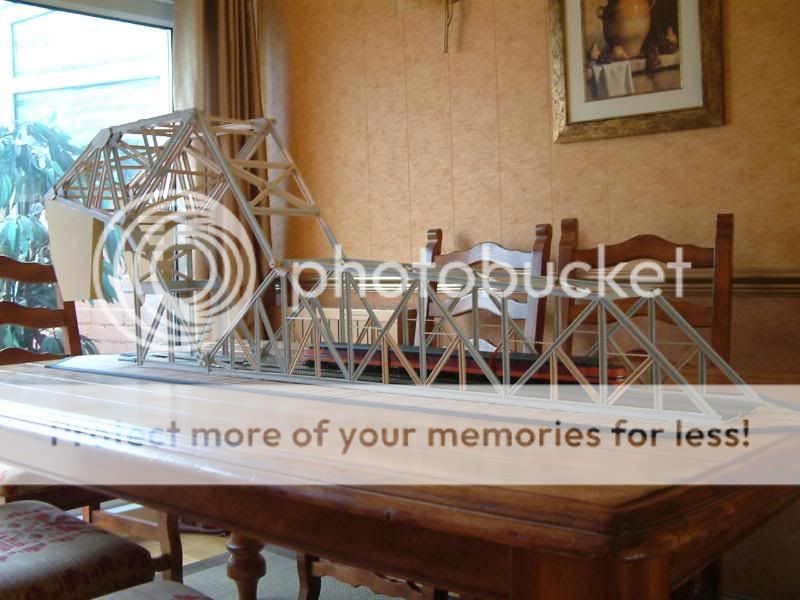

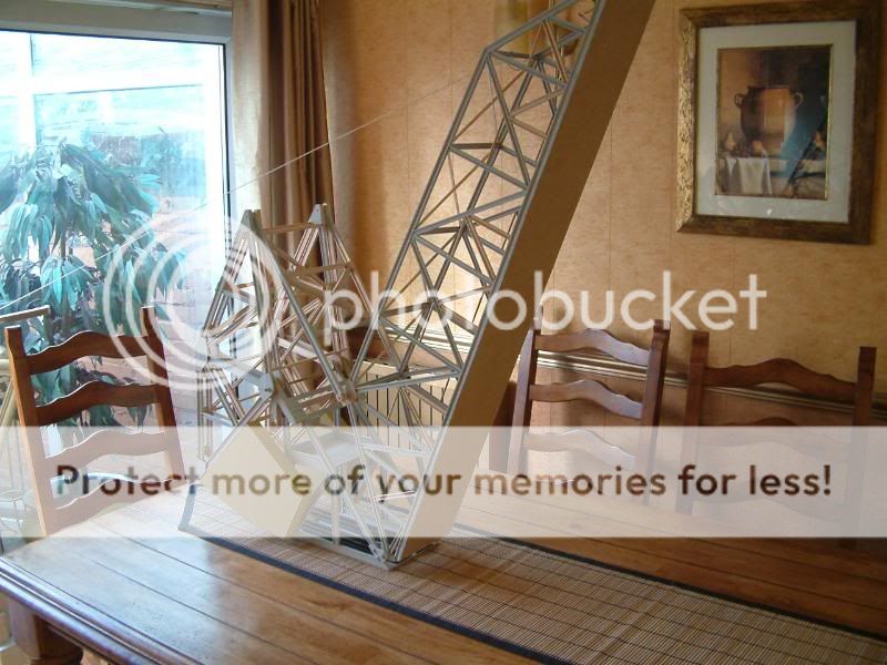

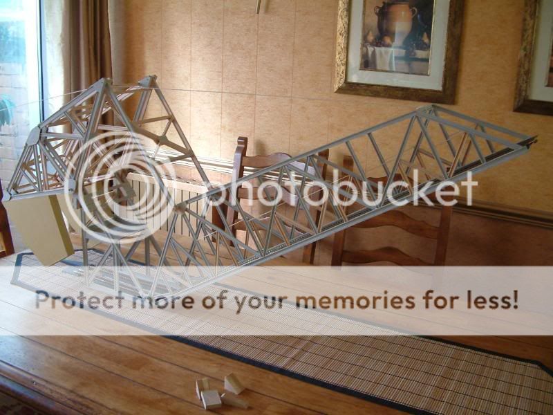

Here are some more photos of the bridge in various positions.
[imImageg][/img]
[iImagemg][/img]
[iImagemg][/img]
[iImagemg][/img]
[imImageg][/img]

Here is a photo of the bridge in position, i,ll finishthe detailing and motorise it im the near future.

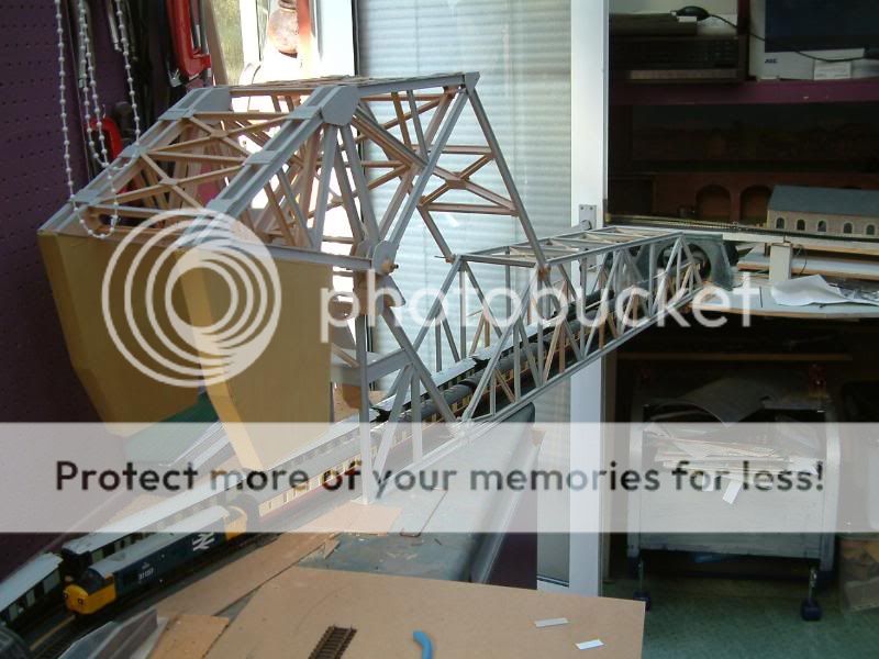

Work has restarted on the bascule bridge. The two counter weights being made of wood and not concrete as the real ones were are not heavy enough. As a result a brass bar of 13 ounces was fixed to the counter weights to balance to bridge and make the load on the electric motor as light as possible.
I have decided to motorise the bridge in the same manner as the real bridge, that is using two operating arms with rack fitted underneath, and guides above and driven by sprockets from an engine house.
The photo above and the ones to follow show how this and the real bridge operated.
The racks were made from plastic chain fixed at both ends of the arms and driven by sprockets on the output shaft of the gear box. The gearing is such that the motors seed of 6000 rpm is reduce to 2.5 rpm
