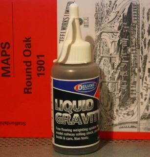

Essex2Visuvesi
Posts: 2357
Re: Weighting really light stock
Postby Essex2Visuvesi » Mon May 02, 2011 10:31 am
Proud member of the OAM

Essex2Visuvesi
Posts: 2357
Postby Essex2Visuvesi » Mon May 02, 2011 11:56 am
Lysander wrote:How can that possibly be safe for fish ? Mind you, who cares about fish....
[I didn't just say that - and you didn't really read it here either. Oh no you didn't. I love fish. Yes I do. I just love 'em to bits].
Tony
I dont know but my dad has been using it in his aqauriums for years and some of his fish are over 15 years old
Lysander
Posts: 2028
Postby Lysander » Mon May 02, 2011 12:09 pm
It looks quite good value - 10ft. would last a life time. I just can't work out how it's sealed after you cut it. I would have thought lead was the last thing you'd want to put in aquarium water. Still, if it works, it works.
Tony.
