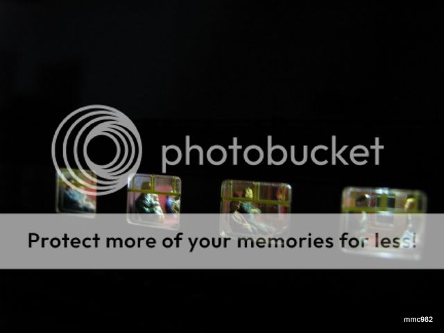

On the other hand if it is not failing I would if that's your interest go the full hog. In most cases you need to use optic fibre in n gauge. I use it in OO, O etc for dash lights warning buttons on carriage doors etc.
This is n gauge
http://www.youtube.com/watch?v=L8Qh01LkJaU
Optic fibre was used right through these 2 n gauge HST's giving you 16 fully independent lighting functions.

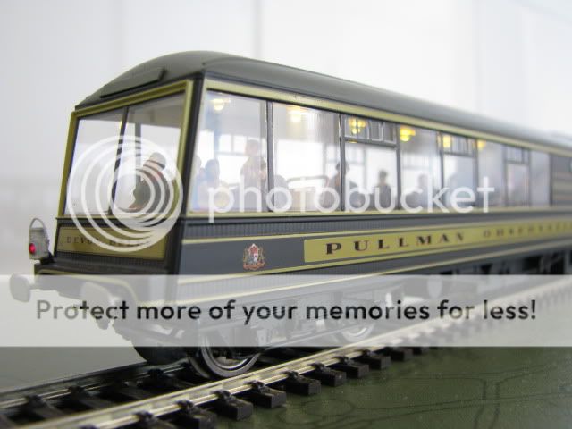

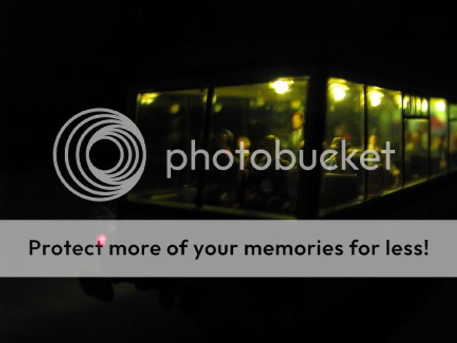

Day v night shot optic fibre used in bar area and fully controlled by 4 function decoder.

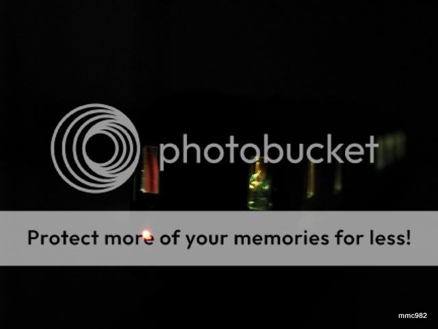

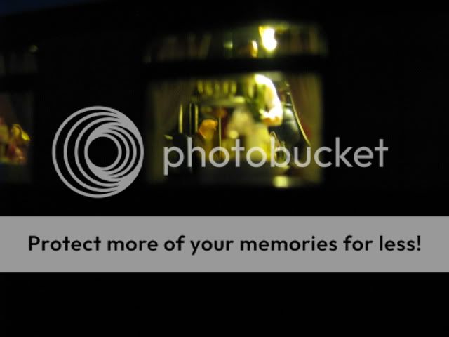

Another Pullman with the table lights switched off.
If you want to have it looking good fibre is the way to go.

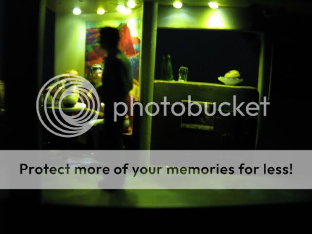

http://www.youtube.com/watch?v=aUwgaHOTlPY
I could only achieve this with fibre.
