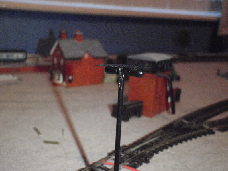

Sounds like you have filament bulbs, LED's do not generate heat,only for a nano second before they burn out. Where did you get said lights and can we see a photo or a link to a photo.

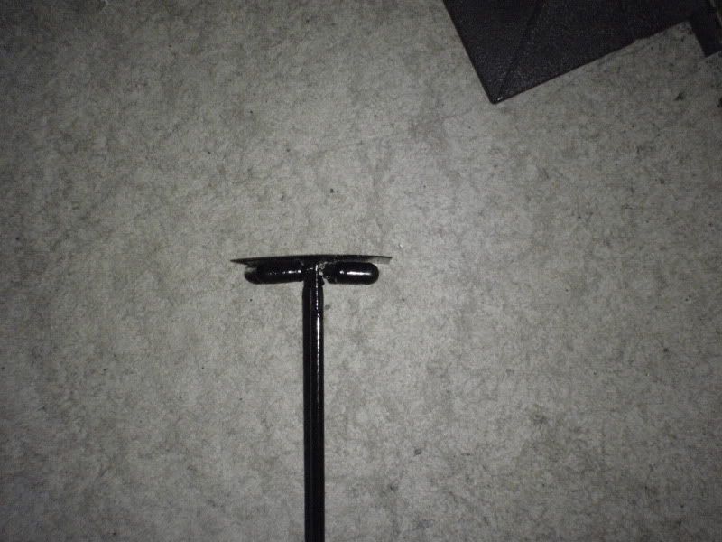

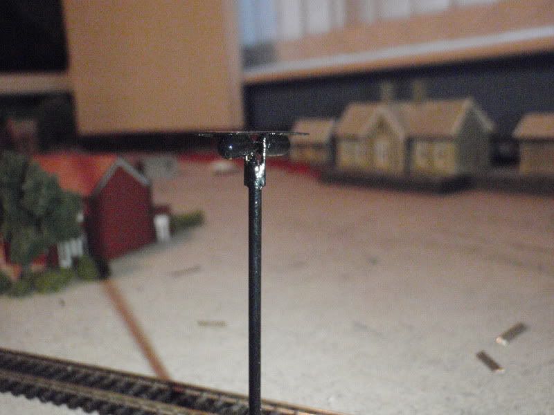

The lights were bought from Layouts 4 U, here http://www.layouts4u.net/Images/L327.jpg and my own photo's:
As i said earlier they are painted black so i can't see inside the bulb.
Flash, just tried what you said, definatley not LED's!
Ste

According to the online catalogue L327 is 6v bulb only. So there is no way they can be LED unless you ordered specially.

Yeah i realise now... i just presumed they were LED's, and they looked like them.
Still doesn't explain the burning and smoke though...

Tungsten bulbs do get hot. With the supplied resistors, you are probably pushing them to the maximum at 12v, and shortening the life. Try getting an old 6v power supply (or even a 3v) and they won't get so hot and smell.

Had a reply from the company when i got home earlier, it basically said it's the heat burning the paint of the bulbs, and after being used for a while the paint, smell and occasional smoke will dissapear :D

12v, the instructions say it is best to use 12v and wire 3 in series, so i have :wink:
Pic for you Bob!
For more see: viewtopic.php?f=22&t=20750&start=0
Ste :)
