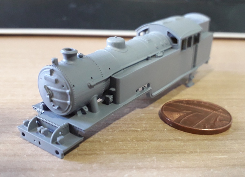

The L1 has been test printed and some areas for improvement identified. Unfortunately, there has been little progress on the County (I'll try and rectify that over the next two days!).

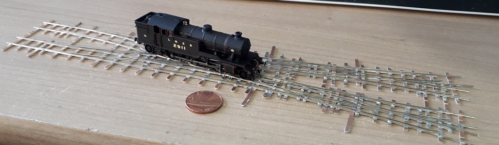

I couldn't resist having a go at another piece of track though.
This is one of two such formations that are key for the fiddle yard of my Hadley Wood project. I've still got to work out exactly where I'm cutting through the rails for electrical isolation but both wagons and a locomotive chassis (minus motor) free roll through the formation without problems!

Re: Atso's May/June 2018 Competition Entry
Atso wrote:See if I can scratch build some copper clad track as an experiment to ascertain if this would be viable in the fiddle yard of my Hadley Wood layout project.
I think you CAN!
That's a hell of a monstrosity of a point network for 3rd attempt! There is no arguing that you are game to try anything!
Looks a cracking job
Thanks Timbersurf!
I try to take the view that if I don't attempt something, then I'll never know if I can do it or not- note the word 'try', I don't always manage it as there are plenty of things in life I won't try!
A quick snap of the L1 test print printed on my B9 Creator in three sections and then roughly joined together. Still plenty of things to address, both in the CAD and the printer setup but a physical model of this body now exists and it fits the intended donor chassis!
Very fine work Atso - especially the scissors crossing - wow!

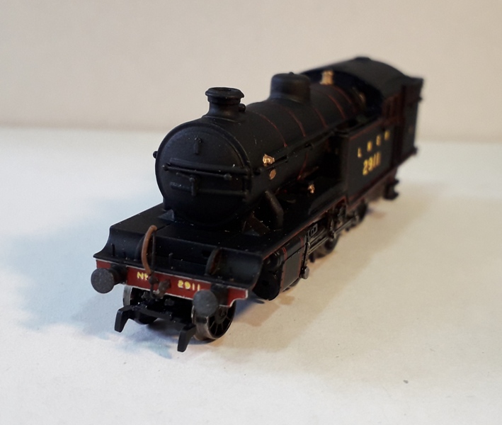

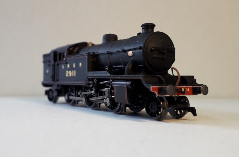

The V1 was completed:
The model was completely hand lined with the only transfers used being the lettering/numbering and boiler bands (which I managed to make myself!).

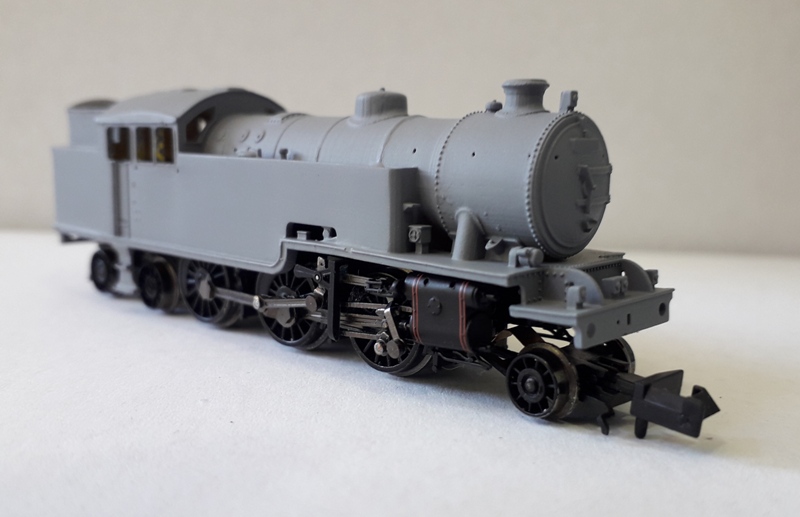

Having made some adjustments, I've reprinted the L1 body. This has been a bit of an experiment using my B9 Creator to see if I can slice the CAD into parts and rejoin them due to the limitations of my printer. Overall, I think this method has merit but I still need to get a slightly better fit of the parts.

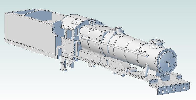

The CAD for the County didn't progress much, partly due to a bout of depression and partly due to waiting for feedback from a couple of knowledgeable people.

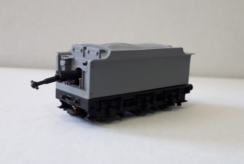

Following the successfully resolution of my D49's running issues, I've printed a tender for the one I'm building for a friend.

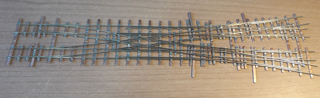

Finally, I've proven to myself that I can scratch build track in N gauge!
A video of the prototype turnout in use.
I'm really impressed with the trackwork.
