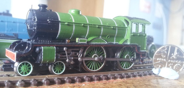

Technically a bow pen is known as a ruling pen and ebay usually has several types listed. However it is a skill that needs to be learnt and usually cheaper pens give inferior results. Currently I am using pens be Kern and a bow compass set (with ruling nib) from Haff. Kern have been out of business for many years but I picked up two pens cheaply on ebay - however this do have long nibs so are prone to springing apart slightly unless zero pressure is applied (which is what you should be aiming for anyway). The Kern bow compasses are fantastic and I consider these by far my best pen.
A book that I can highly recommend is 'A Modeller's Handbook of Painting and Lining' by Ian Rathbone. Ian also did a 'Right Tracks' DVD with Tony Wright for BRM several years ago which is now on Youtube: https://www.youtube.com/watch?v=Ne0fBH6zNkQ&t=9415s
I've been using the techniques outlined in the above book and video for several locomotives and carriages in N gauge - also my original cheap pen has found a new lease of life for making the painting of wheel spokes very easy. Below is a picture of my progress on an N gauge LNER D49, with the exception of the boiler bands and the square on the box on the running plate, everything else has been hand lined with the Kern ruling pen (done before I got the Haff).
