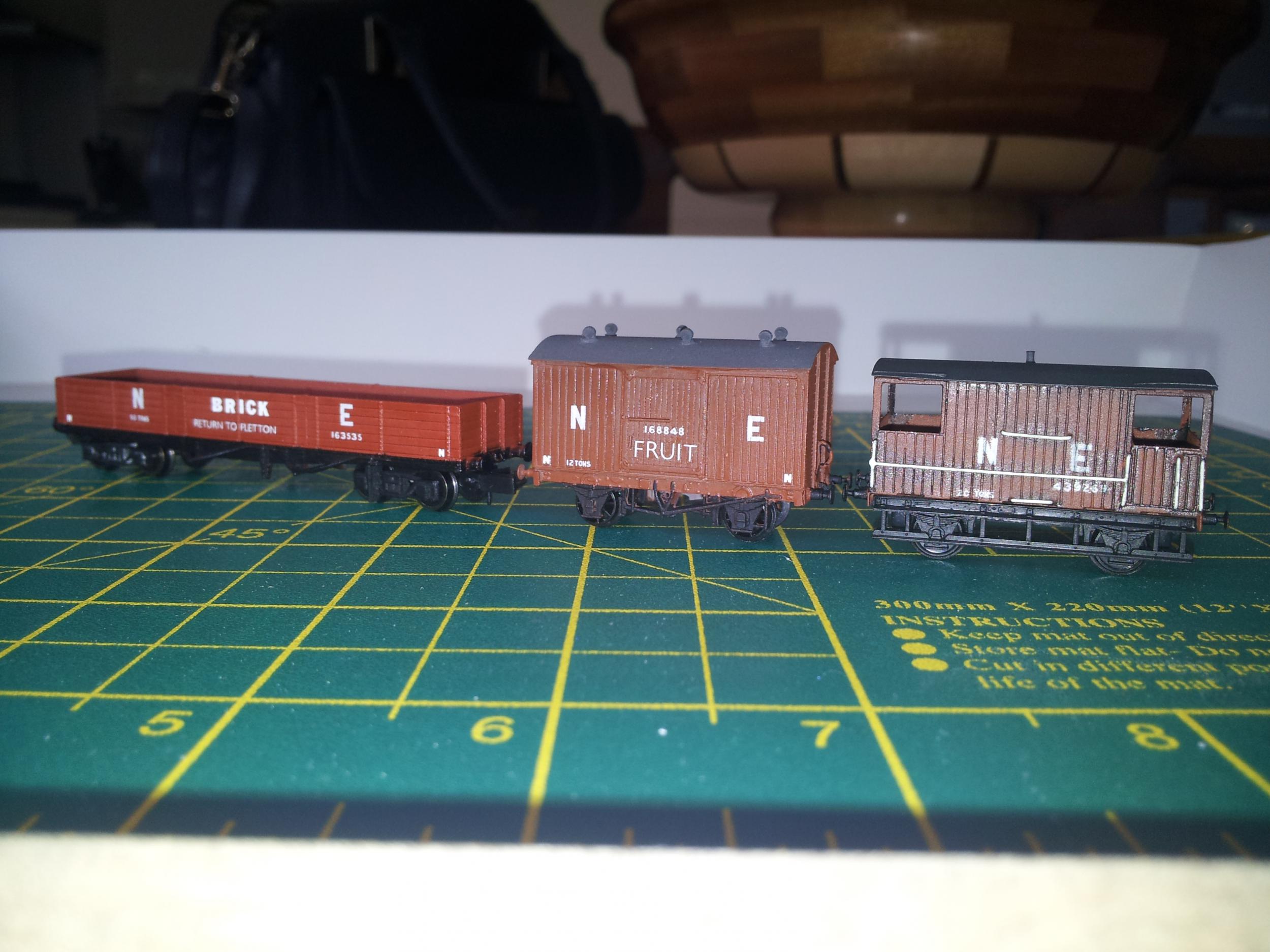

Things are very slowly progressing towards completing these wagons...
Still quite a bit to do on the other side (except the brake van) and they've still got to be matt varnished so look a little shiny here.

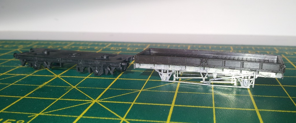

In the meantime, I've built another wagon chassis this afternoon.

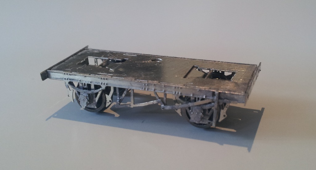

Posted: Sun Sep 03, 2017 12:38 pm
by Atso
Hi all,
Just a quick update about the growing collection of etched chassis on my bench. The total is now four and I've gone a little further on the 10' wheelbase versions by adding the brake pull rods underneath the chassis. You probably can't see them but they're not too difficult to do and really strengthen up the brake blocks so they'll pretty much withstand any knocks.
I've also chemically blackened them using Carr's blackener for nickel silver (which also works on brass!).
I really should add some footsteps to the horse box chassis....
