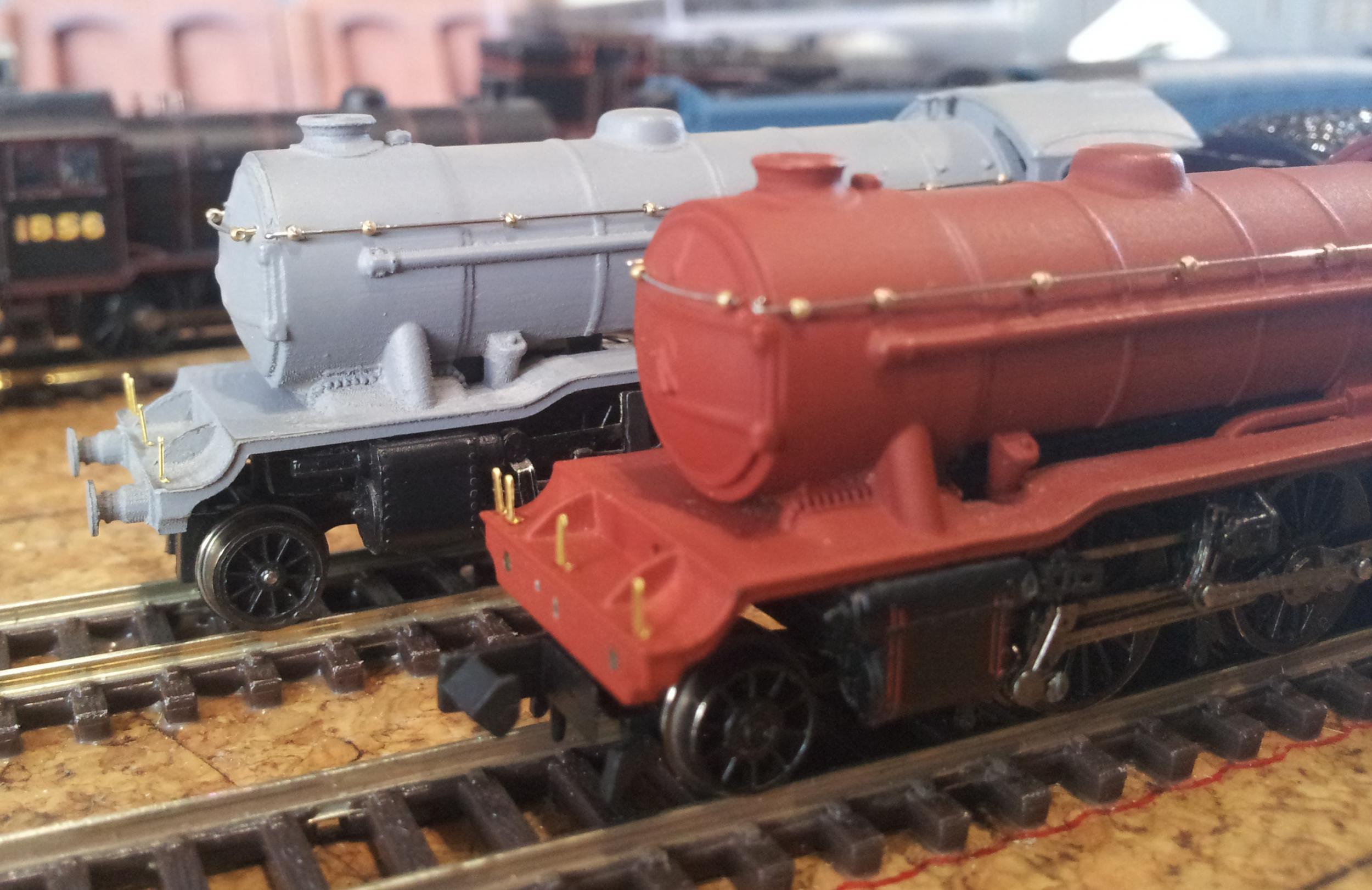

Next up are two K3s:
Both these models are based off the same CAD file. However the rear one is one of my earlier incarnations of this locomotive (a Shapeways print) complete with integral buffers and designed to fit on a modified Farish V2 chassis. The red one in the foreground (printed on my own machine) is modified to fit a Farish N class chassis and will be fitted with turned brass buffers. Both represent the K3/3 subclass and, again, one will be finished in LNER livery (lined black) while the other will once again be BR mixed traffic.

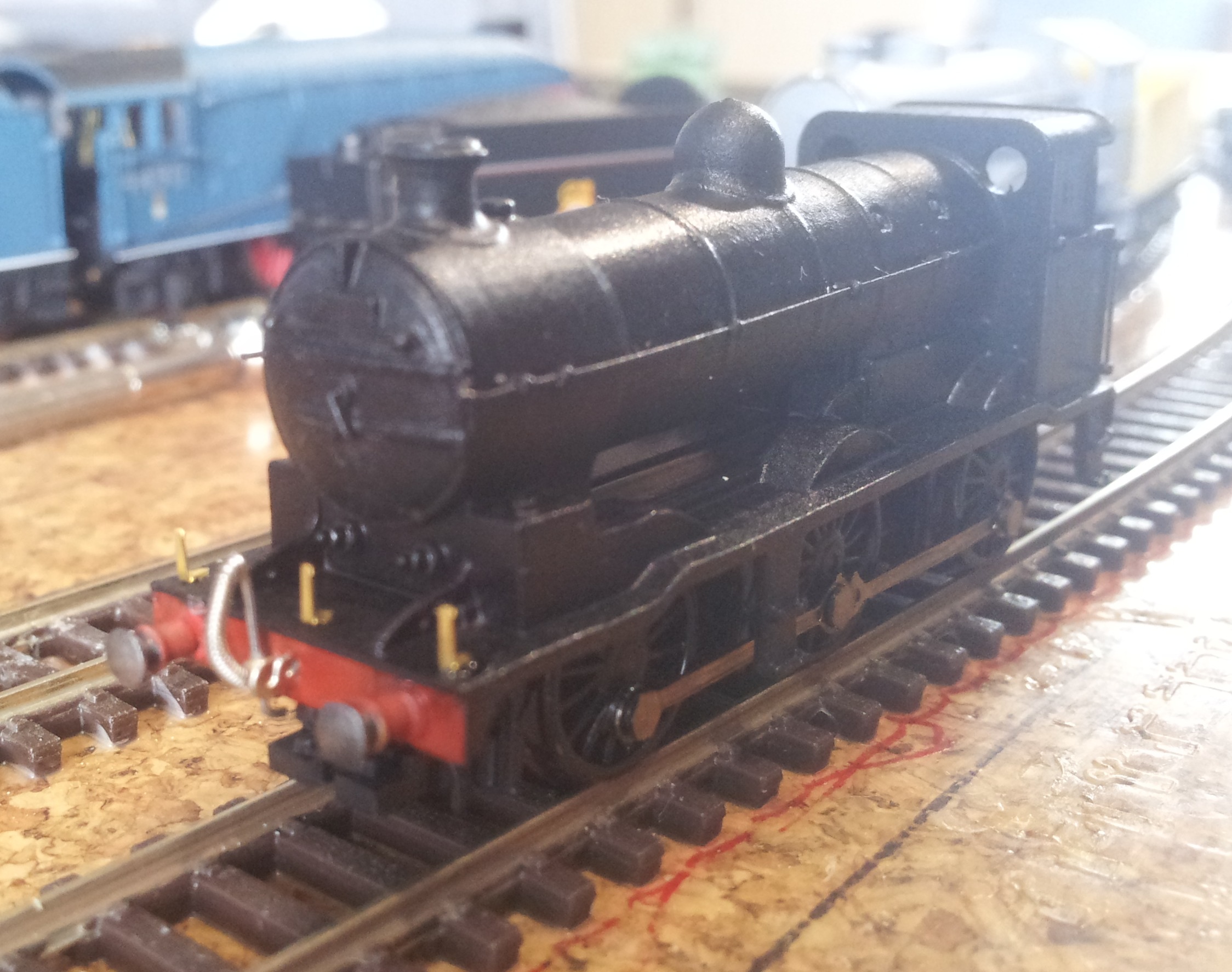

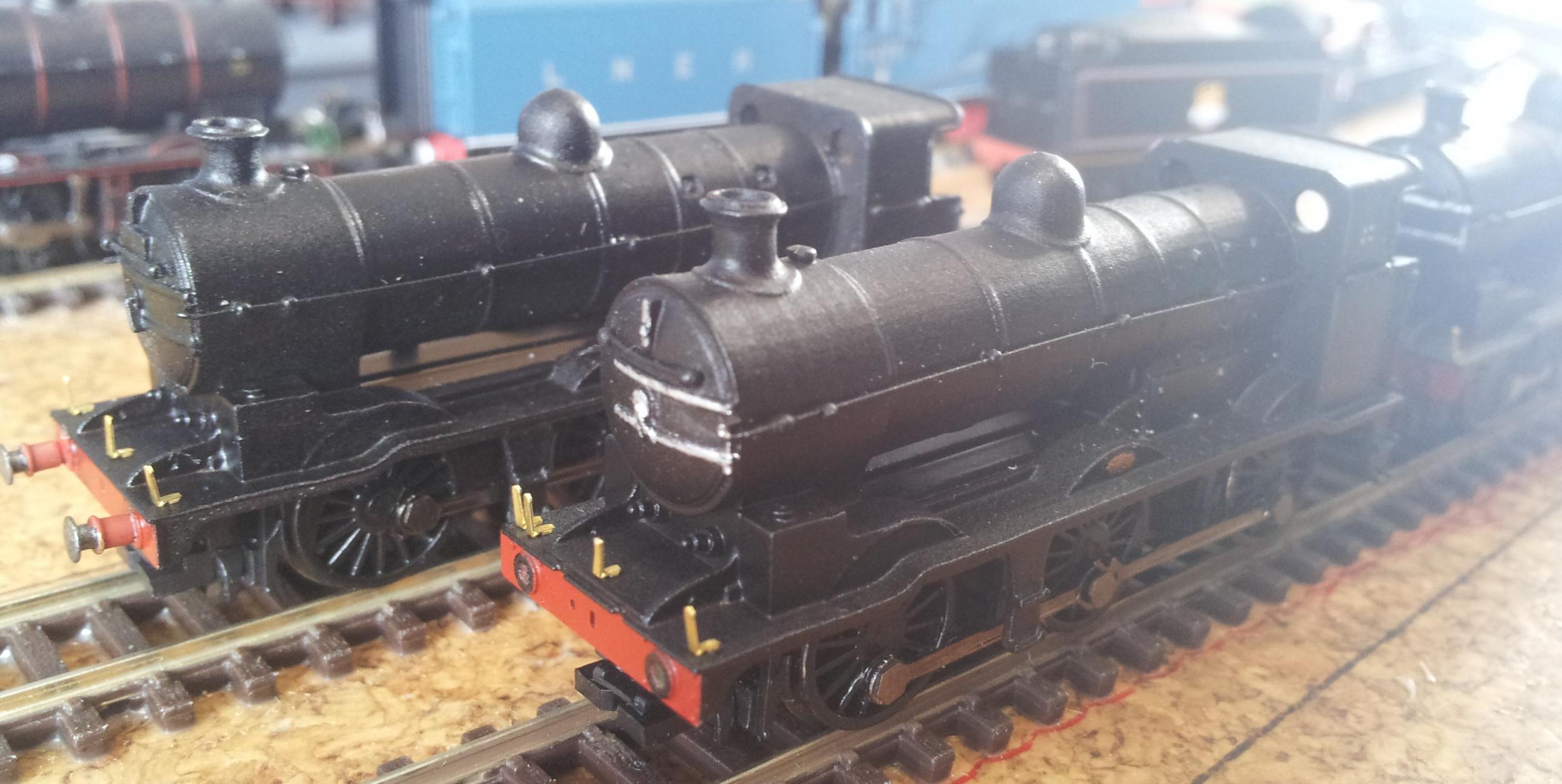

You may have noticed that I have taken the plunge and fitted lamp brackets to the above models. This is the first time I've done this and therefore, as I didn't make a complete mess of it, I felt that I had to revisit the trio of J6s to retrofit these.
Following this, as they are already painted, I decided to have a go at making a vacuum pipe (guitar wire and a handrail knob) and adding the coupling hook to the BR version of the trio (the buffers on this loco have been in place for some time).
The vac pipe isn't fix yet as I think it is best to paint it off the model before fixing permanently.
