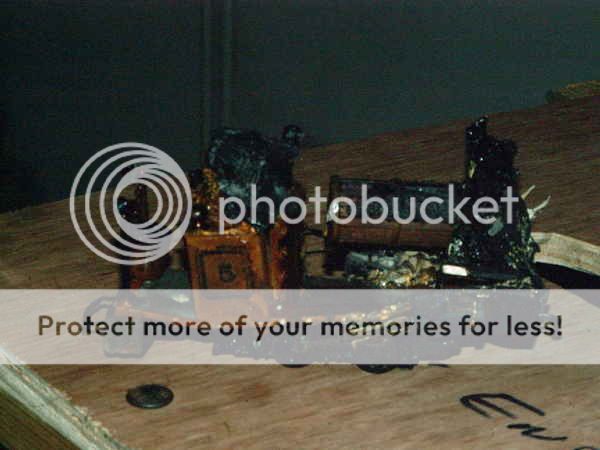

Having checked on eligibility, I can announce that my entry for the February 2015 competition is...
The Six Million Dollar Loco: we can rebuild. We have the technology.
The result of an unfortunate fire several years ago.
There is at least a usable chassis under there. I think.

Is that a motor with wooden cladding I spy?

There was wooden cladding, but the motor was vertical, in the firebox.

Have you started already? The number 5 looks good :D

glencairn wrote:Have you started already? The number 5 looks good :D
Good luck Chris
Glencairn
I've got rid of the burned bits.
Hang on, there was supposed to be something left over, wasn't there?

Meanwhile, having removed all that wasn't burnt to ruination:
The chassis rolls, the driving axle gearwheel is intact, and the original worm gear has had a large horizontal gearwheel attached which will take a small pinion gear from a small high-revving motor. Due to the tiny wheels I don't need as much reduction as usual; to end up with a suitable shunting speed.

This is certainly an impressive restoration. I am surprised that so much of it has survived - for example it's amazing that the brake shoes are still the right shape!
