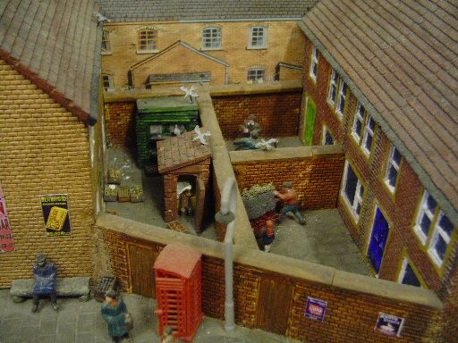

Here's a brief invasion of your thread with what Dad and Bufferstop have mentioned.
