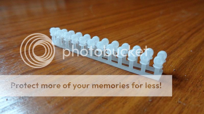

GN Saloon - 1st prototype print.
Last week as part of a bit of research for the Metropolitan coaches which are in re-designing at the moment due to the change in material. I have been working away on the GN Saloon which I announced I was working on back in August. After a few revisions and changes to various areas including details and thickness, I went ahead and test printed the chassis and body.
Here are the results:
As you can see the results are promising, after this print more changes have been made ready for it to be tested again and if all goes well shall be put on general sale once I have finish one, to show as a guide for the others who may purchase one. This project will be made available to fund the Met coaches.
Why change print material?
On the Met's I experienced some problems with Print lines with the Frosted Detail, as well as some warping. It also proved very fragile, and not only that rather expensive. The White Strong and Flexible material is laser sintered nylon plastic, it's about half the price of frosted detail... its durable, reasonably heavy, it does have the properties of plastic with a slightly rough surface texture... but this reduces once paint is applied due to it being absorbed.
The print quality / resolution has been found to be quite good, with no noticeable print lines, apart from the roof which is no problem really.
The idea of using RTR spares, such as Bogie wheel sets, couplings systems ect... is to enable the coach to run well and reliably.
Some kit skill's will be needed to finish the coach.
Price will be around £50. It sounds expensive... but then again this is a specialist area of 3D printing a coach... but there is no kits of this coach in OO, and if there were, you would still would to have put it together or have the equipment to... even then the kit could cost more than £50.
Anyway that's all for now, now to get ready for test print 2.

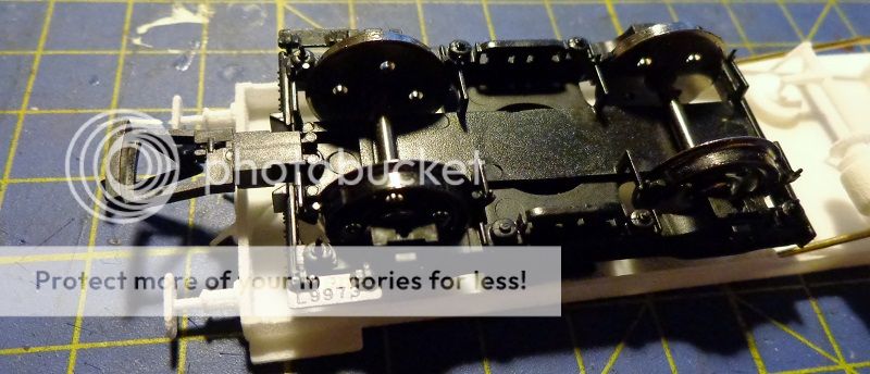

Postby mattmay05 » Sat Dec 21, 2013 3:03 pm
I have received a second test print, Sadly due to Shapeways rush to get everything printed before the last pasting dates a number of areas had errors, due to their lack of attention on checking models before printing.
But despite being damaged I was able to get an idea of how the improvements / revisions came out....
The toplight detail was missing on the first print, so this area was reworked, making the walls slightly thicker and making the detail stand out more by reducing wall depth behind the detail which brought it out at 0.3mm you can now see it's quite visible.
I have also test loose fitted some of the roof vents on the top lights which seem to fit ok now, you still may need to enlarge the hole, to accommodate other roof vent suppliers.
Other small improvements were to the interior doors have been made thicker so less likely to break off, coach ends have been made thicker again this helps the detail on the ends.
Around the doors, improvements have been made, you now have small indentations or locaters for drills, for fitting handrail knobs or hand rail wire, also a small dent in the door if you want to go the extra mile and fit Markits T-Door Handles, which I will be.
On the chassis, small changes, have made it possible to fit the Hornby coupling system you which you will find on most coaches. Another small tweak has been made to move the coupler forward by 0.6mm... but it works so that's good news.
It will probably be a couple of weeks until Shapeways find an answer to the print error, with xmas and all that, once they find out, and hopefully a partial refund I will order a re-print. If all goes well I will hope to release it very soon.
