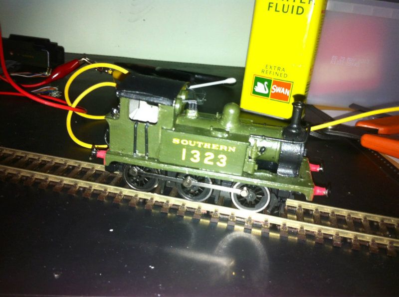

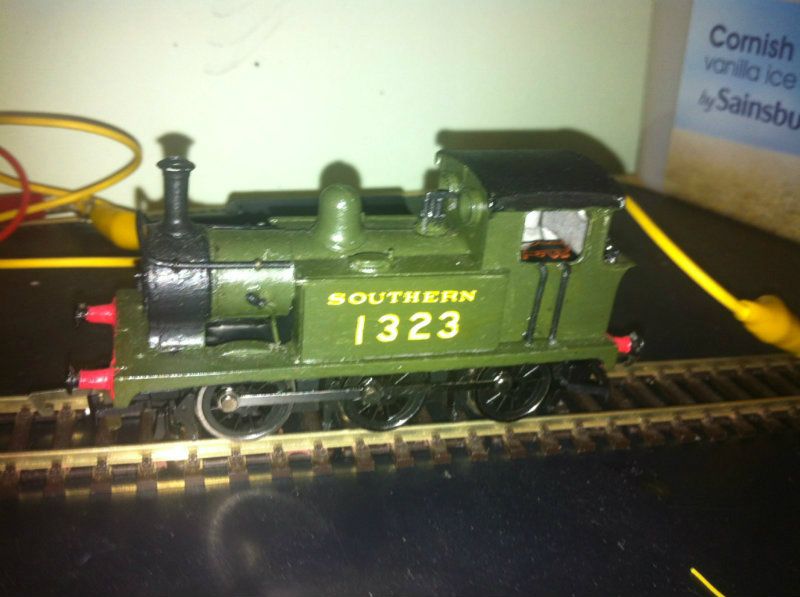

Long time, no progress. Yes I know I haven't updated the thread for a long time. That is partially due to me not making much progress. I have found many ways of how to make this project not work but I think I have cracked it now.
My first problem was that I was just not skilled enough to solder in the cheapo Hornby DCC decoder into the loco of this size and properly insulate joints and whitemetal body interior. I smoked and broke at least 2 Hornby decoders which the moths in my wallet are still crying about. I decided to switch decoder make. I found the Small OPTI Decoder which had several advantages compared to the project. It is sold as a N gauge decoder so hopefully should be able to be crammed somewhere in this tiny loco. I comes ready insulated so I don't have to worry about that and it has a plug in wiring harness so I won't break the wires off the chip and then not be able to re-solder them. So one afternoon I fired up the soldering iron and soldered in the harness, plugged in the chip and voila it worked next all I needed to do was figure out how to fit the body on.
I tried fitting it with the decoder in the boiler/smokebox first as that is what was done with my Hornby terrier. However as you can see from the photo the body did not rest right and I don't think the smokebox was really long enough for the decoder and plug which took up extra length.
I realised that the only place I could realistically fit the chip was in the cab so I soldered and re-solder extension wires so the decoder could reach its new position. I trial fitted it and it would sit below the window line and since it is black thanks to the insulation I didn't think it would be that obvious. I plugged the chip and it didn't work so I left it for the time being. Today I just went over and unplugged it and plugged it in and it worked first time(typical, but at least it works now). I then put the body in place and tried it again, it worked again. So I secured the body in place and re fitted the couplings. This is what it looks like now(you can just see the chip in the cab).
It runs fine up and down my little analogue test track(the decoder supports dc running also) but I haven't braved the dark and weather to try and take it out to the layout.

I have a P which needs chipping. Did you use the OPT1 DCC26, aka the mini ?
I was toying with the idea of a TCS Z2 which I think is even smaller, but with direct wiring.
Did you just not connect 4 of the harness wires (I am a bit new to the chipping game) ?
OliverSR
Posts: 171
Location: Tewkesbury
Re: SVR Workbench-Bluebell P Class Finished, hopefully
Postby OliverSR » Sun Jan 27, 2013 9:44 pm
This is the decoder I used http://www.ehattons.com/46981/Gaugemaster_Controls_DCC26_Small_OPTI_Decoder_with_4_functions/StockDetail.aspx. I chose this because it was the cheapest I could find which would do the job(I just want a chip that lets the loco go forward and backwards cheaply). I like the idea of the harness as then there is no risk of me damaging the decoder with the soldering iron also if it cut the wire too short I could get a new harness and save the decoder. With my one it is a Cut down hornby terrier chassis and so has a wire from each wheels plunger pickup which are connected to the red and black wires of the decoder, one wire for each side. the orange and grey wires connected to each terminal of the motor. My loco's body is a Wills finecast whitemetal body I acquired a while ago ready assembled and so has been modified to fit the chassis. One word of advice is to get some heat shrink tubing and insulate all the joints as I didn't want them to touch the whitemetal body though it is advisable to insulate all joints when DCC fitting anything(not that I always remember). What you do depends on what type of P Class you have as It could be a "proper" Wills/SE Finecast kit with a kitbuilt chassis or a dean sidings resin one with the hornby chassis. Since mine is a bit of a compromise it will probably be different for yours.
You could ask about it on the DCC section of the forum for others opinions but I am happy answer any other questions you have and try to give you some advice.
Hope this helps.
OliverSR

Last week the P had an outing on the club test track and I am happy to say "It Works!!!". It will now reside with the rest of its Bluebell buddies on the layout(If people ask nicely I could make a video of it running).
Deeftrundle-That P class looks great( wish mine was a nice as that).
It looks to me like a Kitbuilt chassis though as the wheels don't seem to be RTR and the chassis could be the one before the brass one as mentioned here http://philsworkbench.blogspot.co.uk/2013/01/p-class-history.html. The motor looks bigger than the one used in mine so the cab is probably the only place for a chip. As long as it is below the window line and is not a bright colour it is not really noticable(mine being insulated in black helped).
Next up a revisit to my previous project, Ironside.

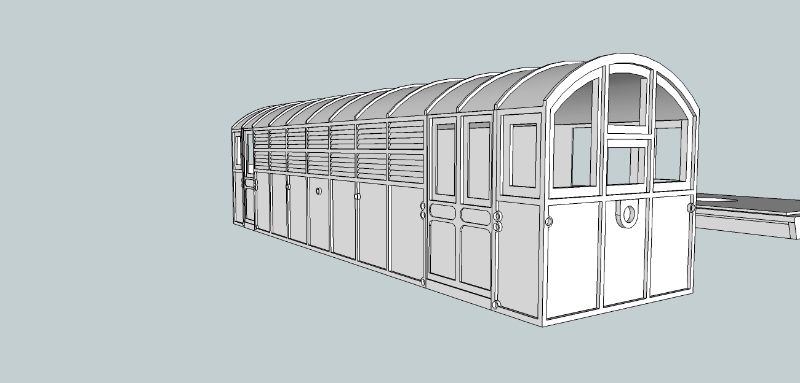

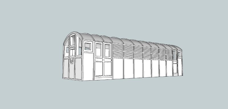

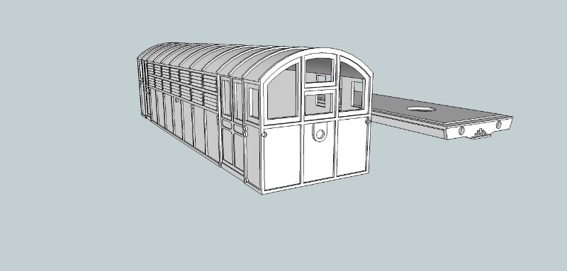

As can be seen on my layout thread I have had a change of theme and so the type of project on my workbench must also change, here is my most recent project.
After seeing other people having a go at 3D printing I decided I wanted to try.
I wanted to Try something fairly simple shaped to start with so after always having an interest in London Transport I found drawings for a Metropolitan Bo-Bo built by British Thompson which was the predecessor to the famous Metropolitan Vickers Bo-Bo(Sarah Siddons Class).
I found drawings and photographs in "The London Underground: Surface Stock Plan Book 1863-1959-Ian Huntley" and "Metro Memories-Dennis Edwards, Ron Pilgram" but cannot post them here due to copyright.
After several tutorial videos in how to use Google sketchup I decided to have a go.
I then made the model, which took ages as I kept having to re-do parts once I realized they were wrong.
(Early Computer Model)
I ended up going though over 20 different versions of the model.
(Later Computer Model)
Eventually I got it to a stage where I was ready to send it off for printing from shapeways.
Link to Model on Shapeways-http://www.shapeways.com/model/683420/met-bth-loco.html?li=my-models&key=6b6e4dd93ff235d1226493c785749073
(Final Computer Model)

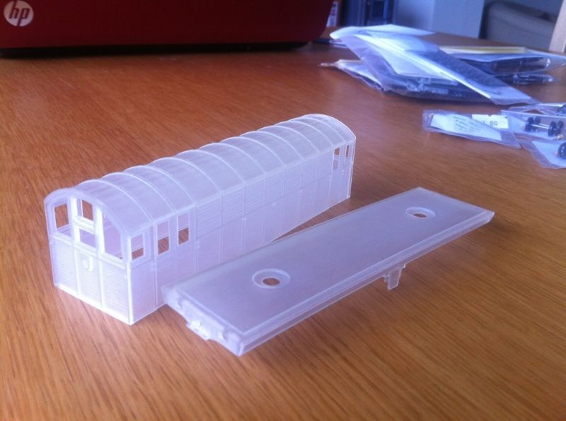

The model has recently arrived and will use components from Radley Models existing kits which require fitting.
(Printed Model)
This shows the model at its current state where it needs cleaning up and fitting of components such as buffers.
The model will be used to take moldings for a resin kit from Radley Models and will be handed over at the Acton Depot Show.
If you have any questions I will try to answer and welcome any comments.

Nice one. What was the damage (cost) ?
What was the material, and what others are available ?
What was the direction of scan, or is that determined by the print company ?
What do you think are the possibilities of doing a steam loco ? I always assumed the boiler would be a problem.
OliverSR
Posts: 171
Re: SVR Workbench-3D Printed Metropolitan BTH Loco
Postby OliverSR » Thu Apr 04, 2013 9:14 pm
The cost I would prefer not to mention though the Radley Models resin body should cost about a third of the cost of a printed one hence why it is being made as a kit.
The material was Frosted ultra detail(useful for the vents and details but for a steam loco could be a more basic material especially if you don't mind adding your own details) and there are other cheaper types available best bet is to check the website.
I don't know about print direction but shapeways website may be the answer there too.
It is possible to do a steam loco(I just chose a box type loco as a first attempt and it has been a massive learning curve for me) and may not be too hard as the only tricky things to do on sketchup is complex curves over two planes such as rounded rooves.
I might even consider doing commissions in future providing I can get a drawing and photos of the prototype and the person is willing to give me goods or services in return.
