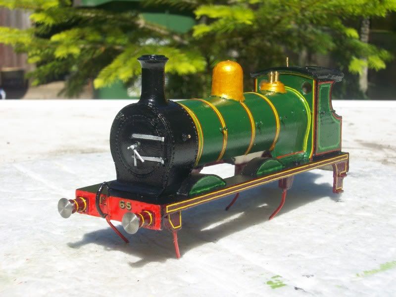

In terms of the new method... you still HMRS transfers, they are still used with the custom transfers, its just a better, neater way of doing the light green lined shapes, as before I would just paint a light green box or shape instead of lining it out...
Here's an example, 2 P-Class kits one with simple SECR livery and one with full SECR livery:
Its just about really improving it as you work through kits, and work out what is the best way to do the full SECR livery.
problem with the waterslide custom transfers is you have a Clear transfer or a white back transfer. If you use the clear, it would need a white background to work, and the lighter colours the green and the yellow wouldn't work, so needs to be printed on White transfer paper and then merg the transfer in with the appropriate paint. I have attempted both, but printing the whole thing is easier, and also gives a guide as to where all the other lining goes.
