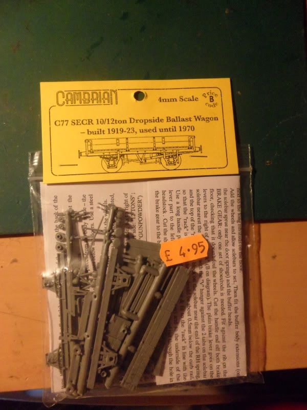

Cambrian Wagon Kit
SECR, 2 Plank, Dropside, Ballast Wagon.

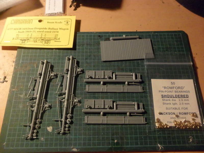

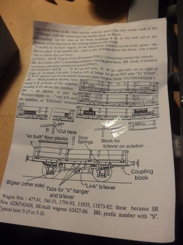

For Christmas just gone I got a few kits, from Cambrian, first one I'll start off with is the SECR, 2 Plank, Dropside, Ballast Wagon (C77). These kits are all plastic, with a bit of metal wire for the brake blocks and various other bits, on the underframe.
The things you need for this kit, Wheels, couplings, and some etched Hooks and Chains, Paint, Transfers, and wheel bearings.
So this is the Kit:

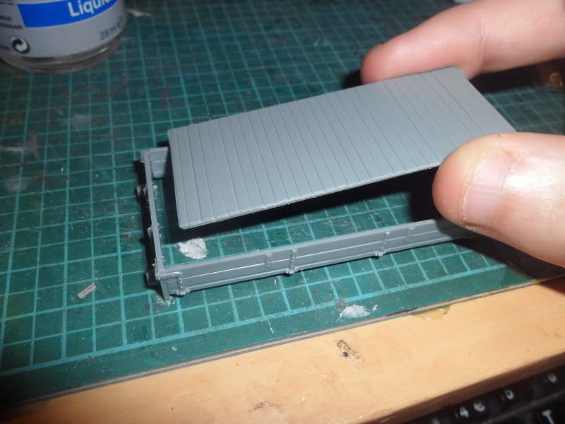

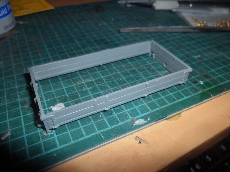

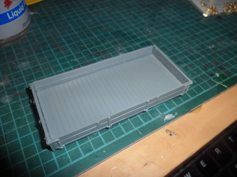

Firstly the Wagon body is constructed, I used super glue as its a bit faster acting than Liquid Poly...
The wagon floor is then dropped in from the top and glued in to place...

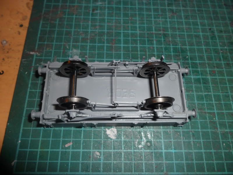

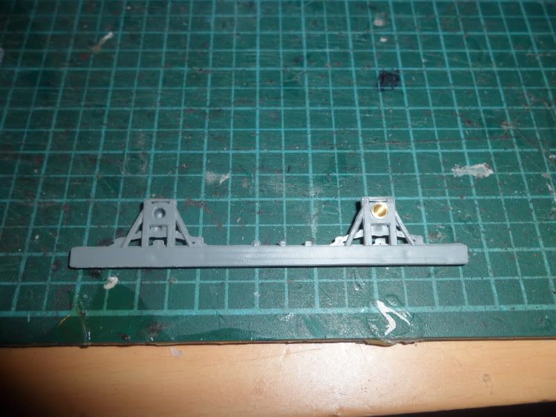

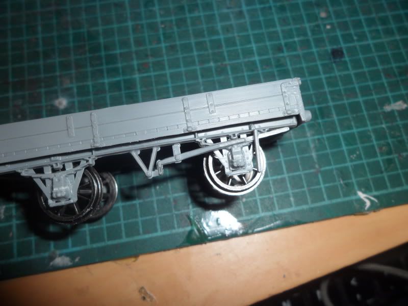

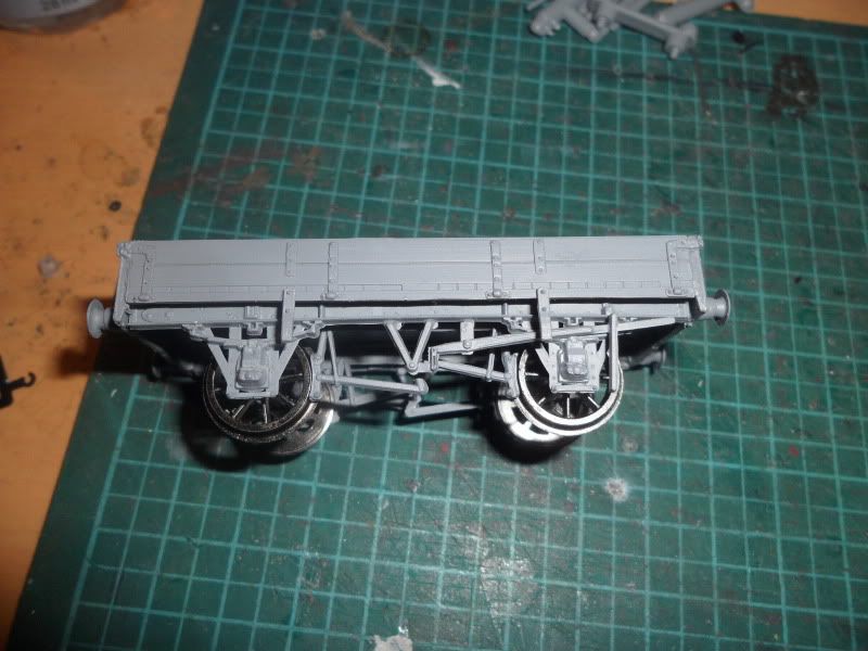

On to the next part of the build, the underframes, the 2 Sides of the wagon, with axle boxes and sole bars.... where cut from the spru, and the Brass Romford bearings glued in place..
These are then glued in position on the Floor of the wagon, there are locator tabs on the underside of the floor, and the 2 sides of the underframe glued in place, and wheels are added, to check for allignment and spacing.

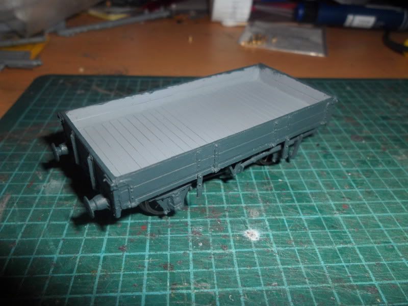

The Brake leaver is added to one side of the underframe, and then the Brake hangers and blocks were glued in place on the located tabs on the wagon floor.

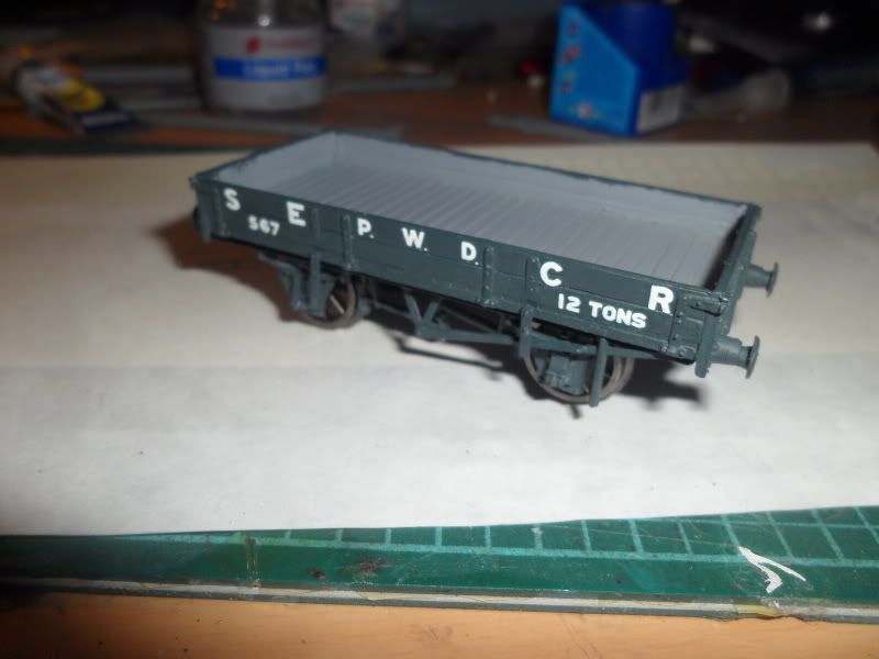

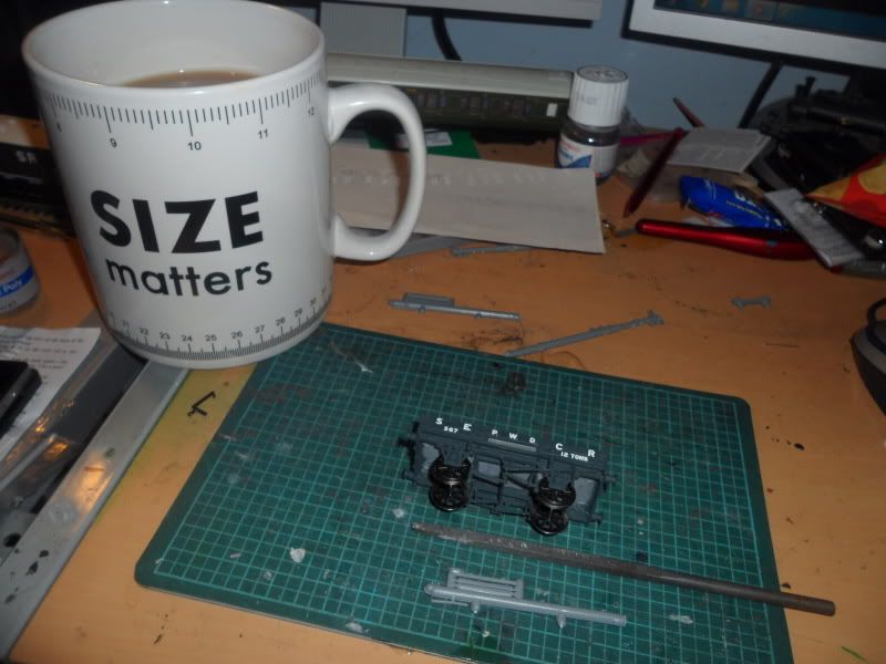

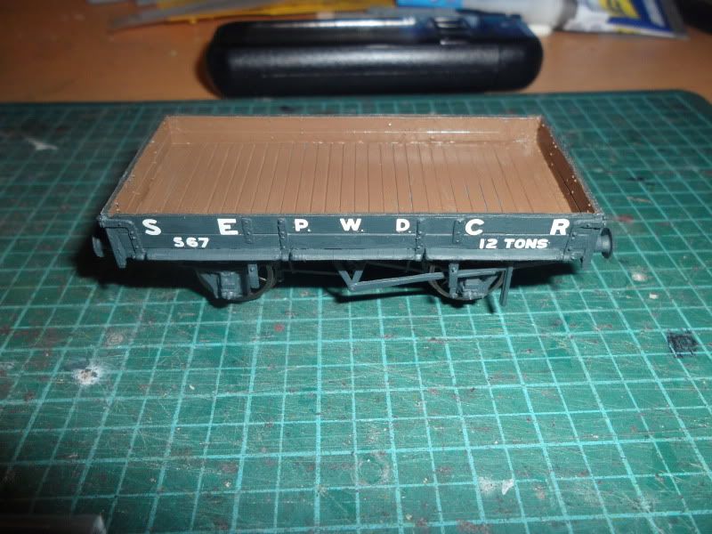

The wagon than began the painting process, The SECR wagons are usually a very dark grey, I used what believe to be close to the colour that I have seen on the Bluebell. I use Acrylic paints, and found the 69 Granite Grey in the Revell Range fitted the bill... all the outside of the wagon and underframe is painted in this colour, and I used Revell paint, 381 Brown for the inside of the wagon.
Approx 3 coats were added to the wagon, when dry I used HMRS Pressfix transfers, A freight sheet, which had SECR, LBSC, LSWR, and Sr numbers and lettering on it, The P.W.D part of the wagon was made up from letters out of Gunpowder van, with small transfer dots between the letters from the same sheet.
After these transfers a Big Mug of tea was needed... so I found myself a big mug!
3 extra parts were added to the side of the wagon just under the dropside doors... in a slight recess...

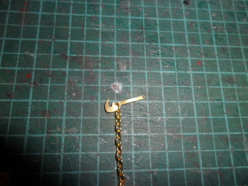

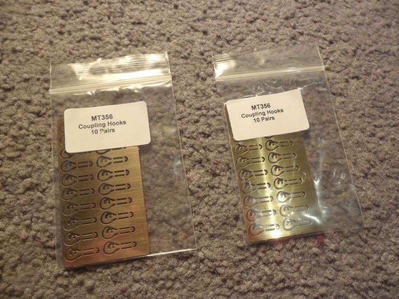

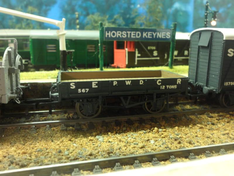

To finish off on the buffer beams, I brought a couple of Etched coupling hooks from mainly trains (MT 356). I also picked up a few months ago some metal chain about the right size for OO, I got this from a high street shop called The Works, cost about £2.99, does the job and looks pretty good.
These were primed and painted and glued in position. The Couplings were added just under the buffer beam on a coupling block which is part of the kit.
The wagon is then Varnished with Acrylic Matt Varnish, and the wagon was ready, some weight will be added later, when approppraite type is found.
