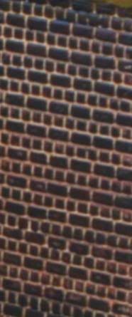

Just for illustrative purposes, its extreme cruel close up time.
Wills English bond plasticard painted with my recipe for the engineering blue brick you see around which has smears of red in it, and using Revell 35 for the mortar.
