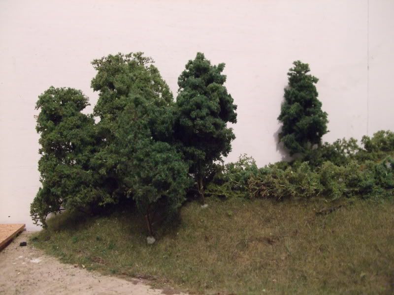

I recently purchased a 'forest in a box' from International Models - I've no link to them other than as a satisfied customer.
This is the ten step method I used:
1.) Select the 'tree' looking seamoss cuttings. Any offcuts or scraps can be used for hedging.
2.) Trim to the shape that you want the tree to look like. Do some research - do you want oak trees or birch trees? They look very different!
3.) If you are making oak trees, I'd advise painting on 'tree bark', a flexible glue-like substance (again, available from International Models or Anita Decor) onto the trunk to bulk it up. Alternatively, add a bit of modelling clay.
4.) Spray paint with a brown, tree like paint. I used railmatch sleeper grime, simply because I had some spare cans left over from my tracklaying.
5.) Once dry, insert the tree into a small tub of whatever glue you are using, either 50/50 PVA/Water or the flexible glue that's often provided with the box. Twizzle the seamoss around until all the branches, but not the trunk, is covered.
6.) Remove the seamoss tree from the glue, letting the excess glue drip off back into the tub.
7.) Hold the glued tree over another container. Sprinkle the tree with whatever flocking you are using. Try and use two separate colours - not all trees are a uniform colour!
8.) Set aside onto newspaper to dry and repeat the steps above for other trees so you have a production line.
9.) Once they are dry, spray with the cheapest extra-hold hairspray you can find, and scatter some more flocking over it. Spray again with hairspray.
10.) Leave to dry.
And hey presto, you have a mini-forest! Here are my recently completed trees:
