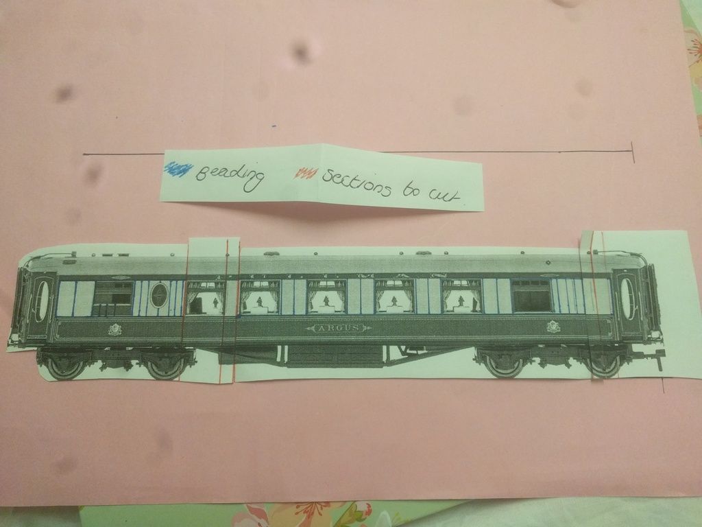

I'm considering casting some of the older types of Pullman car that are more suited to my future layout, such as the Brighton clerestories (including the PUPs), the Hastings kitchen car Pullmans and perhaps some of the SECR 'American'/Pullman cars, also.
This post will be outlining a possible path to the Hastings Pullmans, and how I'd go about creating the body.
As is, a Hornby Kitchen Parlour car (in this instance, Argus), is 25.5cm over the buffers, and around 3.5cm wide. The Hastings cars were 57 1 1/2 inches long,and thus around an inch has to be removed from the model's length.
There is one window too many on this side, however the spacing of the windows is correct and there is also the kitchen window.
With a window removed and some of the bodywork also trimmed down in length, the model would now sit at 23cm, the correct length.
I did also trial this with a print-out of the Railroad Pullman Parlour but it did not look nearly as accurate, especially given the Hastings cars were matchboard sided, and thus using a main range Pullman would avoid this problem. In terms of width, the car would have to lose around 7 scale inches, or 0.23cm. Whether this seems worth it or not, I'm not yet sure. I'd like a noticeable difference, certainly. What I'd probably do would be to remove the gangway connectors, and any roof detail I could then cut the model straight down the middle with a circular saw and then fix it back together, probably with bracing inside.
This project, if I do undertake it, will require more research into casting in resin and how to go about it. I did find this video - https://www.youtube.com/watch?v=dBEK_Jyfvek - extremely useful for explaining the process and how to go about it, especially as my casting will be hollow.
If it does work, I'll be salvaging the chassis from the model and perhaps casting from that too, or constructing a new chassis from metal and recycling the underframe detail and bogies as far as possible.
If anyone has any advice or pointers, or even an opinion on this potential project (which will be a way off yet) please PM me.

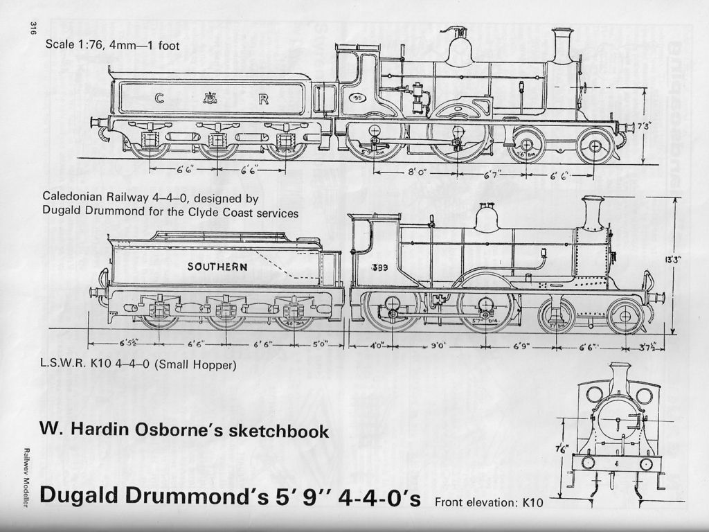

I've been doing a bit more research into the K10 and C8 classes, and annoyingly it seems I did get some of my research wrong when it came to the K10's wheelbase...
I'd thought it was 8' but according to a scale diagram, apparently not. It's 9'. From my research the C8 is still an 8' wheelbase so I shall still continue the build on this, but it just means I now have two tenders with which to run it.
(Original credit to W. Osborne for the sketch in Model Railway Constructor).
However, this does mean I now have a spare chassis and half-constructed body... What to do with it...
Well, if I manage to fix up or if I replace the running board, and add some splashers, a cab... I can create...
The spacing of the wheels is 2mm shorter than that on the 'Toy Story' chassis but for the sake of an unnoticeable 2mm, I don't think I'll be too concerned. Yes, I know it's half a foot technically but while I enjoy accuracy I don't want to spend forever trying to find yet another chassis with suitable spacing.

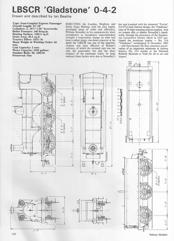

Following BlueLightening's thread on their LBSC layout, and their 'Gladstone' build, I think I shall follow a similar pattern... I'll try and find an old M7 body for the splashers and smokebox, however for the tender I am awfully tempted to look into a Caledonian Single body, as it looks to be more or less the correct outline, including the toolbox at the rear. All I'll need to do is fit an inside-bearing chassis for the wheels. I doubt I'll have to lower the height or shorten it (too much). The cab will be constructed in plasticard, as will the roof. Chimney will be sourced from Alan Gibson, most likely.
http://www.rmweb.co.uk/community/index. ... r-1905ish/
I'll finish the locomotive in either Marsh Umber with a white roof and gold lining or in red lined black with a black roof. I suppose it depends what takes my fancy. In spite of number 182 'Hastings' having been scrapped in 1910, I think I'd quite like to have the name for the loco given it's the setting of the eventual layout.

Whoops, looks like I've made a bit of a boo-boo... I already knew that some LSW designs, mostly 4-4-0s, were trialed on the Eastern section following grouping, and that this included the C8s, T9s and K10s, but I think I've confused myself with the K10s and C8 mechanical details:
From initial research, the C8s and K10s shared the same wheelbase, frames and boiler but the K10 had smaller drivers... I think I've probably gotten confused with the class name and the wheelbase- a simple mistake but embarrassing nonetheless. Still, I think I might just stick it out with the K10 (simply remove the wingplate from the smokebox of the C8) and finish it as a narrow cab locomotive. It may not be fully prototypical but at this point, I just want to finish the project.
As already mentioned, I'll keep the two tenders for use with the locomotive (the six wheel tender will make more sense as the eastern section had shorter turntables).
Deary me, research certainly pays off doesn't it!

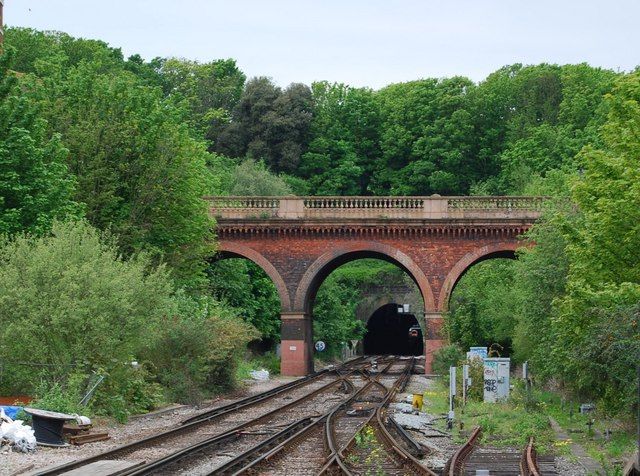

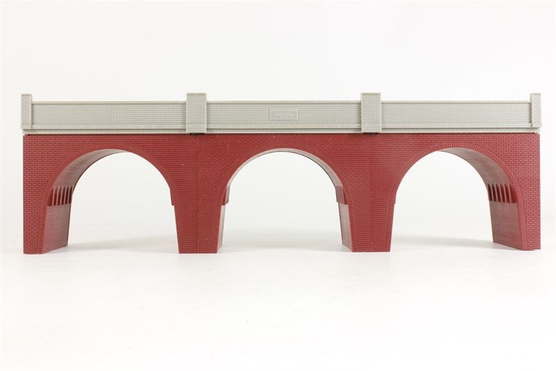

Looking at the bridge over Linton Road, at the tunnel end (West) of the station, it bears some similarity, to me at least, of the Hornby 'triple arch viaduct' piece available. Yes, I'd have to remove the girders from the top of the moulding, some judicious repainting and weathering would be needed, not to mention the balustrade at the top of the bridge and extension of the pillars but I feel like it might work.
(taken from http://www.geograph.org.uk/photo/1298306 with credit to N Chadwick)
(taken from http://www.hattons.co.uk/105633/Hornby_ ... etail.aspx)
