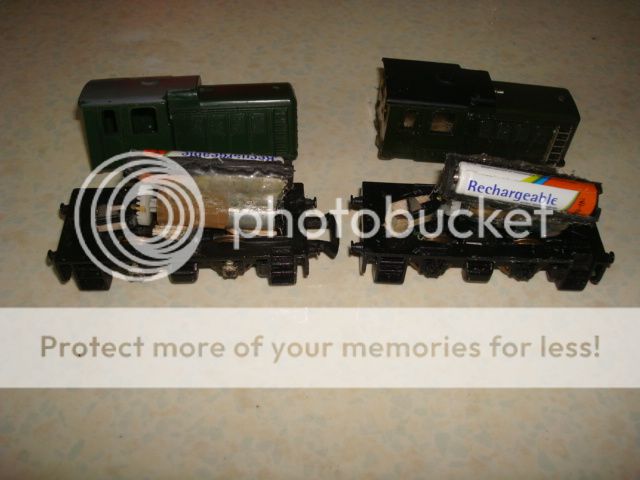

Two very cheap recently acquired Jouef Diesel shunters.
The basic problem with these has has always been that they only had drive to a single axle.
I thought it might be time to see about trying to re-work that.
The idea with getting two was that of using both the geared axles on one loco and giving the remaining body a chassis from elsewhere.
I've never seen one of these with two axle drive, but there is most decidedly a lay shaft mounting already in place, and it turns out to be a pretty simple job to fit two sets of crown and pinion gears to couple up the second axle.
I won't need that extra chassis.
These two will now get low-revving motors, batteries and radio control (of two different frequencies.)
They don't have much internal volume, but it is all free and conveniently arranged.
I think it can be done.

Fitting motors for the Jouef Playcraft shunters has gone well.
Plenty of room for the control chips in the cab space, and I may be able to keep it below window level.
So far so good. I'm holding off the soldering small wires stage on several locos until I am a bit less tired.

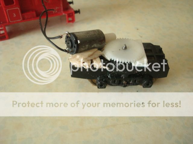

From a Jouef Class 29 I have taken the bogies to use separately, the both have 4-wheel drive.
Here getting the gearing and motor mount came first, before I started thinking about what body might fit over the top.
It's coming out remarkably compact and tidy.
The original vertical spindle gives a 2:1 reduction to the driving wheels so with a a worm and 48 tooth gear the drive is 96:1
Now, what to turn it into, It really was compact, so I'm going for a reduced dock shunter.

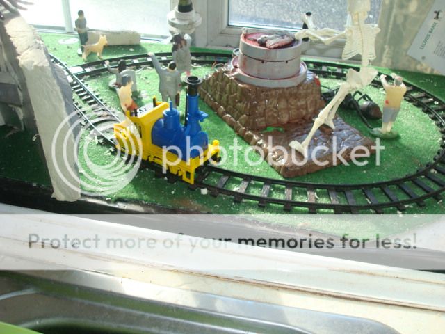

An almost instant out of the scrap-box and into the window was a Halloween display.
I've dome better ones before, but this was quicker and less effort than restoring either of those to being properly operational
Faller mini playtrain locos and track intended for a Sylvanian families display layout got glow in the dark zombies from my garden railway, and a chunk of scenery with a life-size zombie pirate's head from a layout four years ago.
It looked and worked better than I had feared.

rosenblad wrote:I really love the motor mount in the red diesel, third photo from the top! You're nuts in a very good way! :D
Those Playcraft bogies are turning out to be very handy.
The odd angle of the motor is A) because it is the most compact in plan view and B) just out of the plane of the gear wheel (about 15 degrees, but by eye) so the teeth of the worm gear come in at 90 to the large gear, it not having bevelled teeth.
I do like the glued balsa mounts because if the mesh isn't spot-on you just split (or even half-split) the balsa along the grain and make a tiny adjustment.
That red diesel chassis has, I think, come out a bit too fast, but I'm nearly ready with a matching bogie with double the reduction and I will compare the two before going Dr Frankenstein on the first one.
