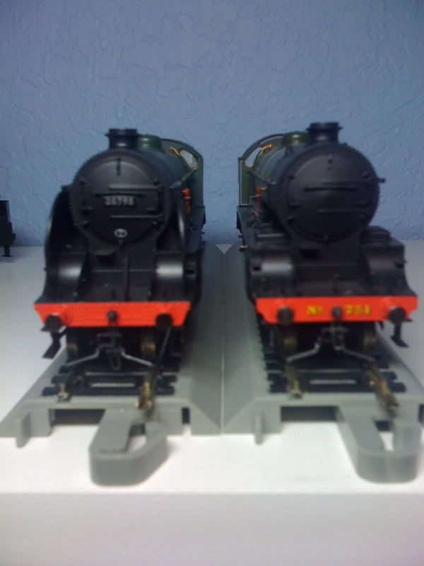

Note some of the small detail differences in the photos
Front Comparison:
Urie
Maunsell
Together

Some notes: You might have noticed by now, that both of my N15s have been modified. My BR 30798 'Sir Hectimere' was a TMC edition that I had made for me, and my SR 751 'Etarre' has been modified to pre 1926 condition, when it did not have smoke deflectors as well as to go around sharper curves. 'Etarre' is also awaiting etched nameplates. I'm also looking into getting another N15 because the model is so good!
