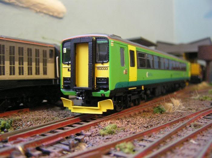

Looking at the model the impression is immediately of a quality RTR “Sprinter” to do the class justice. The odd cab ends (small and large) are well captured and detailed with the motor bobie at the small end. I particularly like the fine bracing around the corridor connections and the fine moulded handrails. The ends also feature NEM sockets, and authentic dummy couplings above these that don’t have to be removed to fit the Tension locks. Slightly more disappointing are the obstacle deflectors, which, rather than being body mounted, are attached to the bogies and swing with the turns.
I’d personally rather have seen body mounted versions that were removable to allow for the NEM socket to be used.

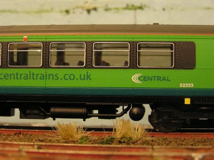

Moving down to the chassis the awful box that ruined the otherwise good Lima/Hornby Class 156 is thankfully absent, instead some nice moulded detail including exhausts, air tanks and if you look closely, the drive shaft. None of this detail is picked out (the exhaust silencer should be a nice rust streaked silver) but would be an excellent detailing project. The only thing I didn’t like in this area were the wheels, which appear chunky and are bright silver. If Hornby had blackened the wheels they would have looked much better.

underframe and rivet detail on 153333.

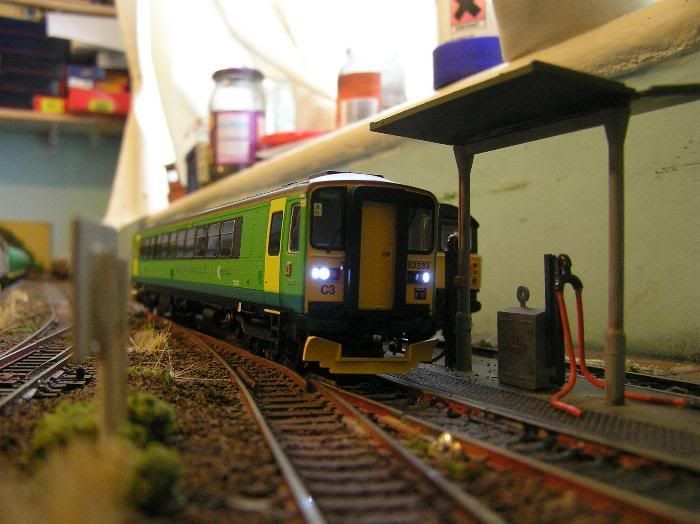

Large end.
Small end showing lights.

Not a bad looking model, but that snow plough looks to be sitting too low on the model, unless there's a NEM pocket mounted on the bogie ?

Yep, there is. The ploughs are too low by those pics.

maybe as an idea, if only using the unit on its own, remove the deflector from the bogie and then remount it under the cab
dunno how well it'll work

Hurst Models sell a full depth one ISTR
