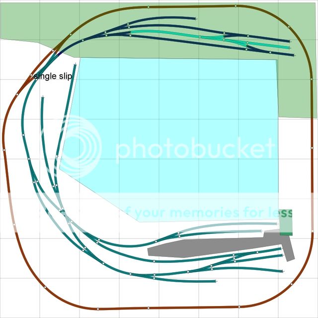

Posts: 2287
Re: Loch Terry - OO 8x8 layout
Postby Emettman » Tue May 09, 2017 6:32 pm
My take on using the extra space, barney:
A siding or two can clearly be lost on the main station if that is felt too complex, but I did that to show what can be put in place,
*with all tracks on the layout R4 or wider*
If R3 is allowed the station can be made a bit more compact, and there is more choice as to where the sidings go.
What have I done?
In the original, trains from the terminus had to go round the continuous run to arrive at the fiddle yard.
Now, they can do that OR take a direct route to the fiddle yard.
The continuous run now goes *behind* the fiddle yard.
This means trains running the oval can do so independently of the fiddle yard and more conveniently away from it.
In the fiddle yard the light blue will be the loco release road unless lifting locos is acceptable, in which case plain sidings will serve.
A sector plate would save even more points.
Where the circuit gets close to the station there is a new option: there is room to make this oval rise until at that corner it is 3" high, so you have a viaduct in the corner allowing for the proximity, and giving room for arches or a girder bridge to give nice road access underneath to the station and goods yard.
The diamond allows shunting of the factory siding/sidings without fouling the bay road or dock siding.

Hi Chris
Thanks for the plan but I feel I loose the loch and village area with it, and probably a little too much track for the ficticious area I had in mind. I do like the fiddle yard idea and the line going straight to it, will have a think to see if I can get it to work somehow in original plan.

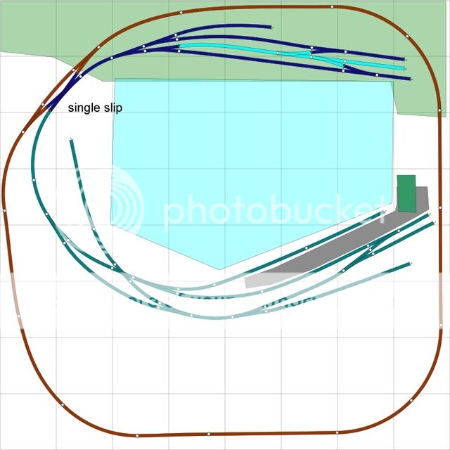

Posts: 2287
Postby Emettman » Tue May 09, 2017 10:34 pm
barney121e wrote:Hi Chris
You've some R3 and even a bit of R2 there, which does let you pull the line to the terminus round more tightly.
Losing 2 or 3 sidings is no problem!
There you are: trimmed, and tightened by using some R3 curves (no R2)
barney121e
Posts: 117
Joined: Fri Nov 23, 2007 9:13 pm
Location: Dumfries
Postby barney121e » Wed May 10, 2017 7:20 pm
What points did you use as I have medium points and cant make plan work.
How about I add a passing station bottom left to break the run from the station to the original fiddle yard?
Posts: 2287
Postby Emettman » Wed May 10, 2017 8:03 pm
These are all the shorter versions SL-E91, 92,er versions And one Lt curved E-87.
One of the two points at the terminus loco run-round could probably do better as a Y.
With rad 3 & 4 curves being used I'd tend to use the smaller points I think they show up less against the curves, unless there are places the size up really want to go.
(That's only a personal preference.)
A simple passing station lower left would allow two trains on the oval while still having the Station to fiddle yard route open. or be a nice passing place (and token hand-over) for trains taking the longer route.
A siding or two would increase variety for a goods train, but this all eats up space that could otherwise be village.
If the oval was to be raised at bottom right, to separate it vertically from the terminus, adding a station bottom left would limit the degree to which that could be done.
Or a long passing loop could be hidden, preserving the operation capacity and the village space, but not the visual effect of a station.
(lucky village with two! Many only got one station, a mile or three away.)
Choices, choices. All yours.
