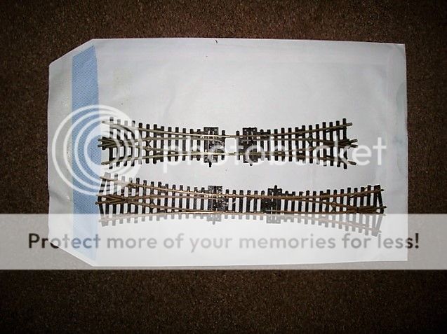

Maximise?
I've build layouts with track (commercially made) down to 10" radius, but that decidedly puts limits on the locos and stock that are happy with such.
Saves a lot of space, though! One more possible trade off.
Two sets of Peco short Y points. One pair "trimmed". Where things are tight, every little bit can help.
