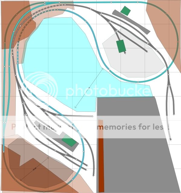

Postby Col » Sun May 15, 2016 4:10 pm
Thought I'd post this in this section as I posted in the welcome thread without thinking.
Anyway here's a sketch of the area available to me.
A must is a mainline for the Flying Scotsman but also incorporating other ideas too, thanks all.

Postby Emettman » Mon May 16, 2016 10:26 am
OK, first idea, not finished.
The unusual thought here, to fulfill the brief in the space is to have two unconnected railways.
It's not that unrealistic for numerous places in hilly country: a little mineral line went up the valley, and the later express line crossed it on a viaduct.
So there's an extensive double track mainline: it's level but as the ground wildly isn't the track goes from tunnel to viaduct via embankment and cutting.
It's there to let two long trains run. Pausing out of sight in the top left corner, if desired.
Deeper in the valley, in the shadow of viaducts, and ducking through the same hills is a little mineral line running from the source quarry or mine down to a tiny quayside.
(something low volume but highly valuable it must be...)
A limited passenger service would be mainly for workers. Perhaps one set of dirty coaches plus a railcar?
The village/town would rise from the station lower left to fill that loop area on a removable board to give access to the corner.
Access to the top right corner is one of the things I'm not happy with yet.
It may be possible to get more space and more spectacle by giving the mainline gradients (at more construction complexity) and lifting the outer lines upper left so that the inside lines there can sit under them. (with the single track lower still)
A figure of 8 mainline would also be possible but I suspect not so successful scenically.
The mainline could be single track, in which case a long hidden passing loop would enable two trains to take turn on it.
A bit of space saving would result, perhaps allowing for an extra siding or two on the mineral line.
Yes, this is odd.
But it might just work: trains in a wild landscape.
Out of the tunnel and under the viaduct:
If this seems at all on the right lines I can develop variations. if not, I'll think again.

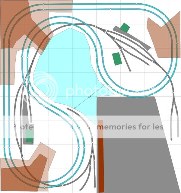

Postby Emettman » Mon May 16, 2016 2:01 pm
A single track version, but with a long hidden passing loop so two trains can still take turns on the mainline.
The extra room eases everything a little.
Tracks still level, on two levels: the gradients were a little severe, and building inclined viaducts is only considered fun by unusual people.

Postby Emettman » Tue May 17, 2016 5:47 pm
Thank you for your kind words.
I've had a mull, and I can't think of anything obviously better than the single line version, but could wish for some comment by other old hands here with comments or alternates.
Next steps?
If it were me, I'd cover the rooms floor with opened-out and taped cardboard boxes, or reversed spare wallpaper or...
And draw out the shape of the layout fairly carefully and the track fairly roughly, to get first feel of the full-size effect.
The next is to work out what size of access hole you would need to be happy to duck under and come up through to gain access to the more remote corners.
if those two I've marked are far too small, there are other possibilities I have thought of, though not quite as simple..
Next, work out what could be done most easily and neatly to provide the good under-layout storage that was requested.
Big plastic storage units on wheels, or cupboards, chests of drawers and bookshelves.
If these latter were all from the same range of student bedroom furniture (say) with matching heights then the majority of the hefty baseboard construction could be done with there and then.
To give a rpugh idea of what I have in mind, this is something I built for a hospital's childrens' ward.
As it happens the whole thing was on castors, so it could be moved for cleaning.
The top was just 1/2" chipboard reinforced underneath where the sheet "bridged" between units.
But that's just my thinking...
