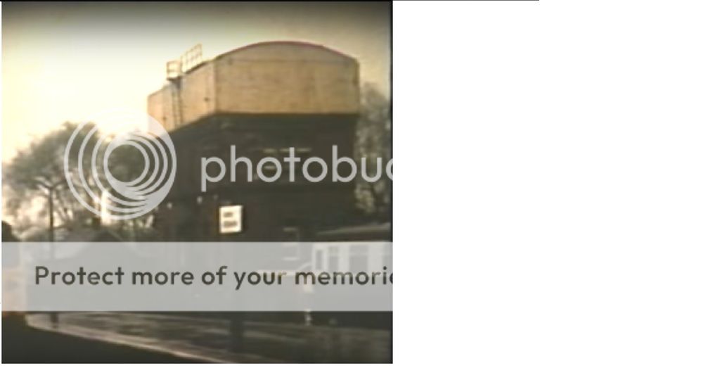

More info, whoops sorry, the reference is to Exeter St Davids
"the old water tower is a monument to the steamers, when long distance crews bedded down in it. Dormitories roofed over with a few thousand gallons of water. New men were warned, if you have to get up in the night, don't pull anything."
It had never occurred to me before to question as to why there were windows in water towers. Knowing the sheer practicality that railway engineers exercised, it should have been obvious they were for something?
Thanks you b308 and Bigmet for the information. Did water towers form any other ancillary functions?
