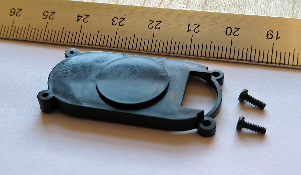

I have just acquired a new 3F (31-627B) of 2015 build with which I am well impressed, but I have a couple of questions about it. First off, what on earth is this thing which comes with it in the detailing pack but is not mentioned in the destructions?

Your random black lump of plastic is a frame to secure a speaker in the tender for those wanting sound effects.

Cheers Bigmet. I'd never have guessed what the speaker thingy was!
