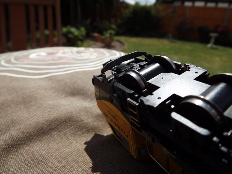

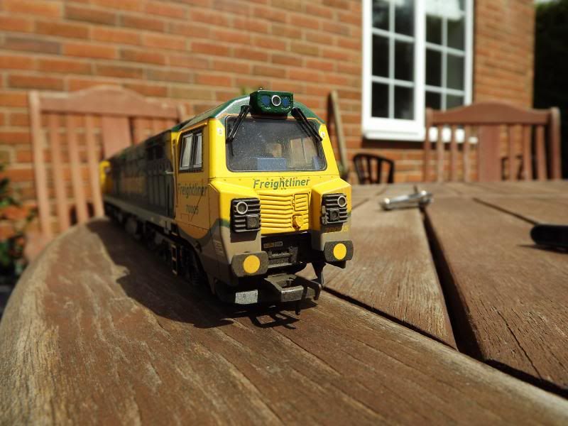

Here are some photos showing the issue,the first two show the snowplough up tight to the underframe,and the bogie pulling up at the front caused by the coupling sitting on the plough .
http://img.photobucket.com/albums/v284/ ... 89cf98.jpg
http://img.photobucket.com/albums/v284/ ... c7f77c.jpg
The second 2 show the plough not tight to th underframe,but with a 3mm gap
http://img.photobucket.com/albums/v284/ ... e4d9f4.jpg
http://img.photobucket.com/albums/v284/ ... 3d4104.jpg
Any ideas why ?

Postby martin_l_jones » Sat Jul 20, 2013 7:30 pm
I suggest you remove the plough and try the loco without it.
Just to see if it is definitely the plough.
Or pull the coupling hook from the NEM pocket.
Something a miss on the second picture, the bogie doesn't look parallel to the body.
Does the bogie swing freely on a flat surface ?

When plough is not fitted it runs fine and moves freeley
When plough fitted it is tight and pulled up to the body by the coupling nem socket
