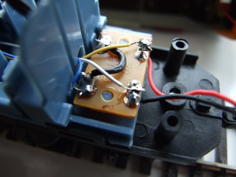

Re: class 158 question
It's simple to dcc the lights using the existing leds. The return wire from the decoder is soldered to the 'pick-up' side of the resistors, the function wires are soldered to the 'LED' side of the resistors. Obviously you will need to disconnect the resistors from the pick-ups aswell. The only thing this won't let you do is have the tail and headlights on simultaneously at the same end, but then you are unlikely to ever need that anyway.
Its is a simple job, I did post some photos on how to do it some time ago.

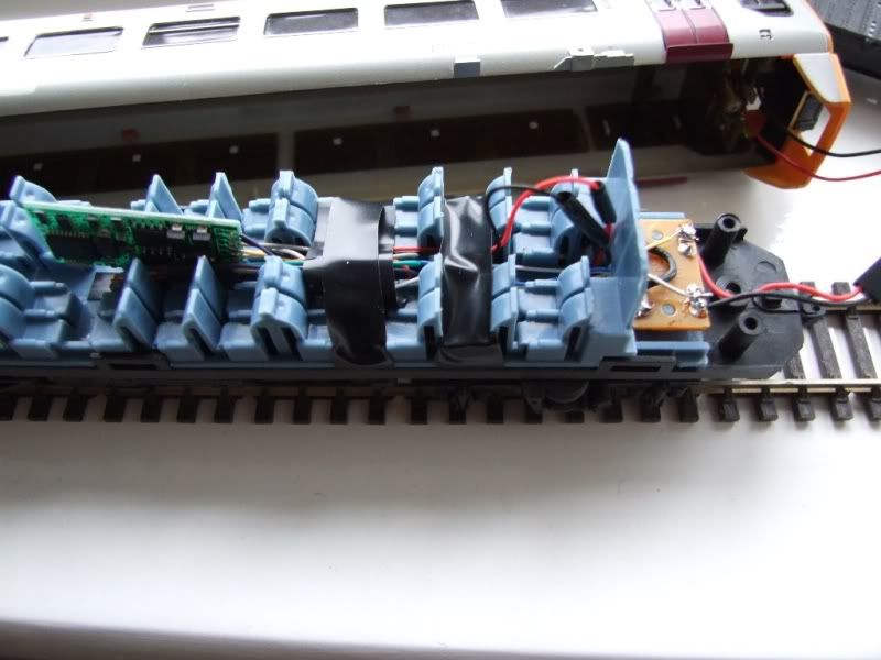

Here are the key photos..
The motor is red to red, black to black..
