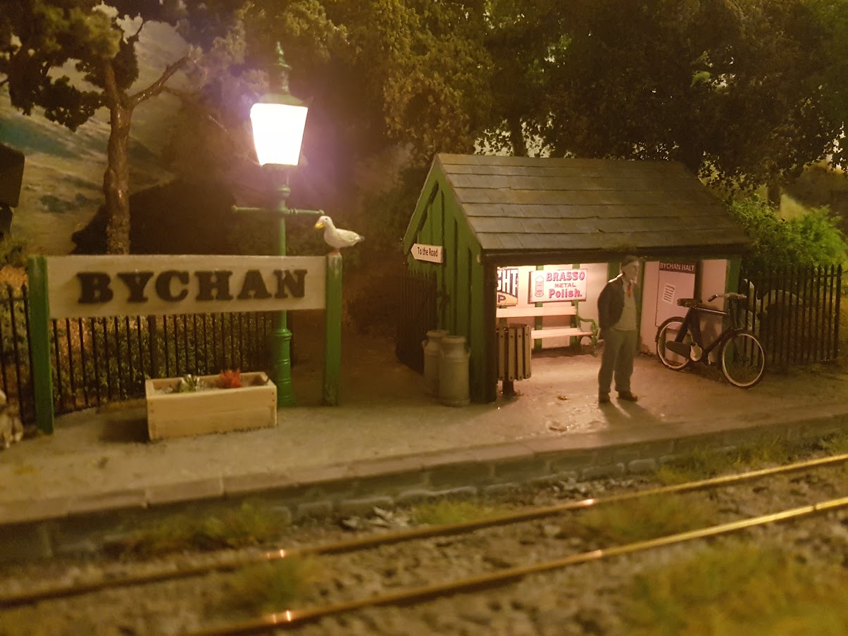

OK now for something a little different :o
I recently purchased an Arduino Starter Kit (actually a Chinese version called Elegoo) with a view to automating some accessories on my little layout. I intend to (initially at least):
  1. control lights
  2. switch my single point
  3. activate an uncoupler on my siding
Other things may follow later . . .
I also bought a bluetooth module so I can control these things from my phone, rather than having to install physical switches etc.
A combination of some programming of both a simple android app and a sketch for the Arduino has got me to the point where I can switch lights on/off on my layout using my phone - Oh the wonders of technology!!!
Here is the bread-boarded circuit showing the Arduino, bluetooth module (standing upright behind it), battery powering the Arduino, second battery powering my two grain-of-wheat bulbs, and a servo (in the foreground) for the future point control:
And here is my simple app on my phone (not all of it does anything yet!):
Then (after a few corrections to circuits and programs!) the moment of truth - lights that I can switch on/off:
This was only possible because I have a background in software development (!) but it is so nice to now have a use for those skills that I can apply to my hobby :lol:

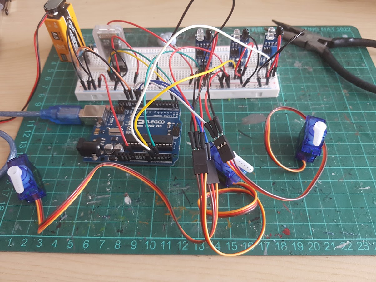

Work has continued with my little arduino project - the first four uses (each controlled from my phone as previously mentioned) will be:
  1. station lights
  2. point switching
  3. uncoupler
  4. warehouse door
The software for all four has now been written for both the android app and the arduino sketch.
This photo shows the circuit on the breadboard - showing the servos for items 2 to 4 and 3 infra-red sensors for automatic opening of item 4 when a train approaches:

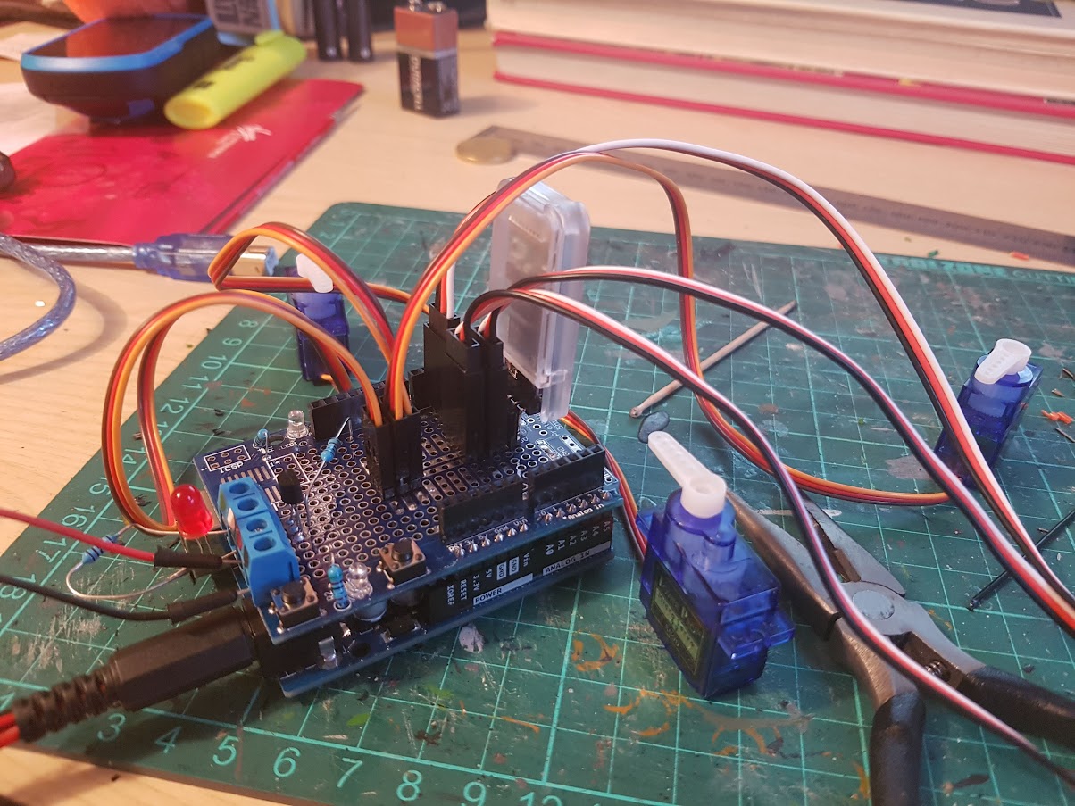

The next stage was to build the circuit on a 'shield' board which sits on top of the arduino itself. As this photo shows I have used connectors for all components that need to be installed on the layout, so that the boards can be removed easily if required:
So, I am now contemplating the final stage, which is the mechanical installation of servos for the items 2 and 3 (item 4 will follow later once there is a warehouse in which to install a door :lol:)
