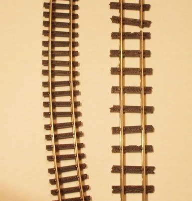

4) You're right, it does use N Gauge track. However, Peco make special 009 track which looks a bit nicer (in my honest opinion.) Here's a photo showing the difference:
N Gauge track is on the left with denser sleepers, 009 on the right.
I hope this has helped! :)
