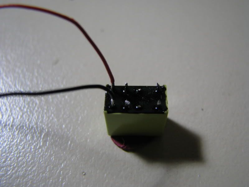

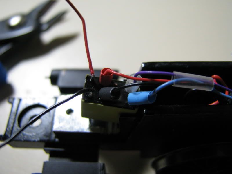

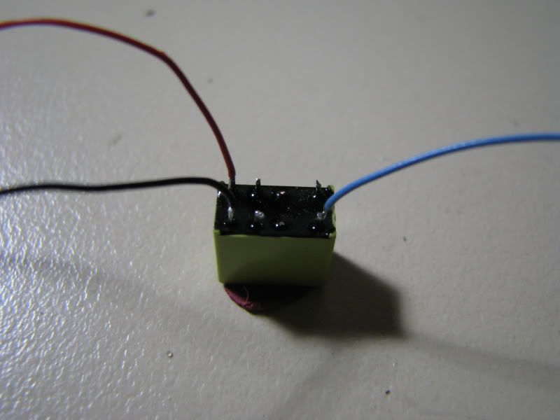

A couple of photos may help. This relay is a DPDT 1A coil is 30mA.
Tails to smoke units wired in parallel. Notice I have cut out 2 legs between control side and power in. They are not used so to reduce a chance of a short cut them out and coat with nail varnish.
Blue added on control side. You need to get this right as reverse blue and purple and the relay will not work.
Pick ups added from track plus purple.
I hope that gives you some idea.
