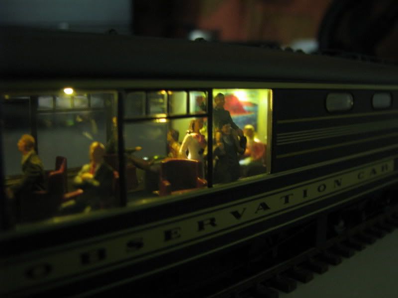

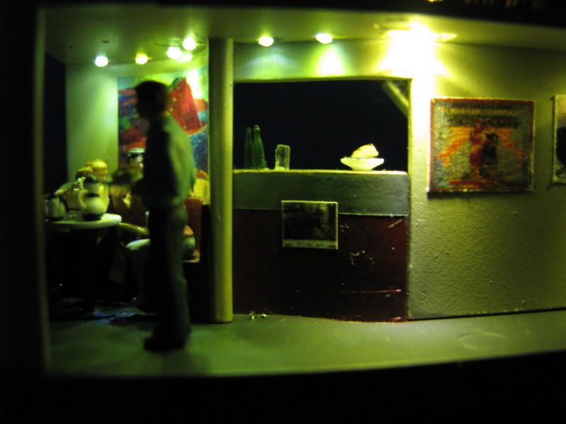

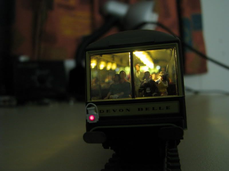

Finally a 4 function only TCS decoder added to the Hornby Observation car. The hardest part is getting in. Remove the NEM coupling. Have a look at the 6 plastic de-tens or tabs, located at each end and in the middle. Push them in towards the coach and start at the end that has the NEM coupling. Gently lever up and hold in place with a business card. Then do the opposite side. Move then to the middle repeat and finally the ends.
Tips
Gently is the key here.
Wash your hand before starting and
remove the NEM coupling before attempting it.
Lighting is on each function of the decoder and allocated as follows:
Tail light
Main viewing area
Bar area
and downlights
The results
Bar area inside observation coach.
Enjoy
Martin
