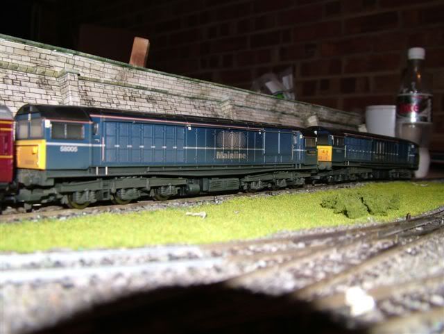

Thought Id show off my latest purchases:
Hornby class 58's (pair, dummy + Powered) Ebay £28
4 Mainline Crimson Coaches, all in very good nick Toymart £20 (woops its de-railed just noticed on the preview)

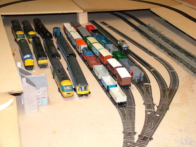

Some wagons and all my not yet DCC'd locos.

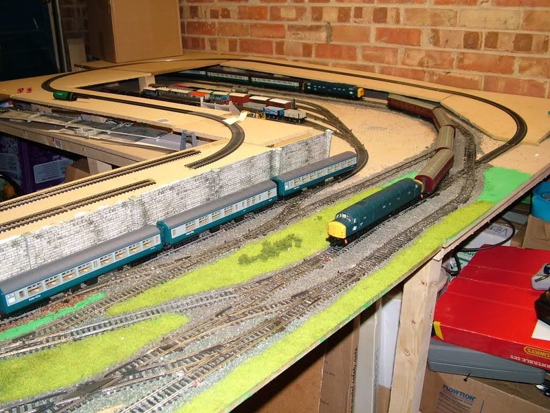

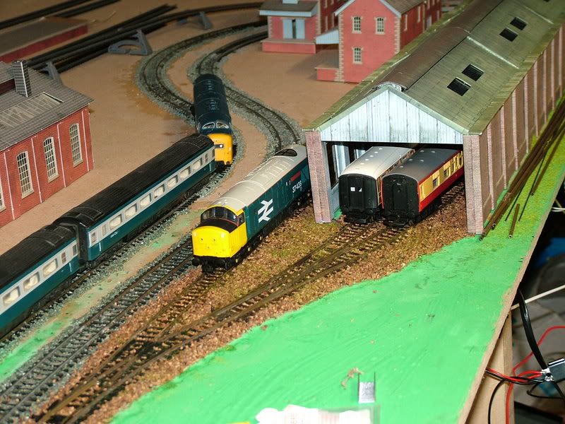

What might just pass as scenic shot

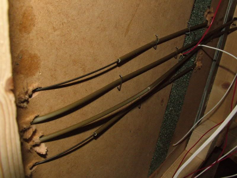

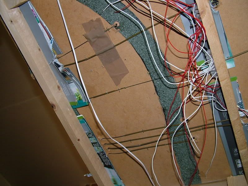

The wires in tubes going to some points

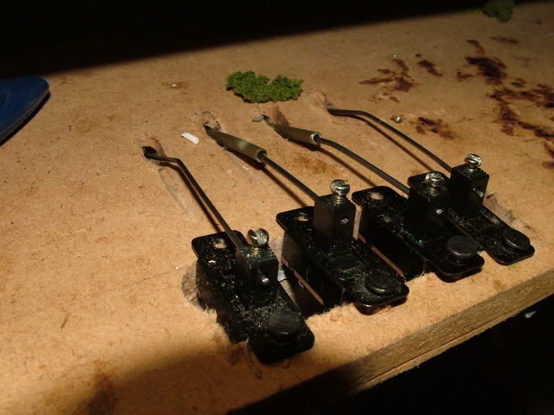

The switch end of the Wire in tubes, which will eventually also control the lights on the future yet to be built display board.

Excellent progress Jon. I certainly think that qualifies as a scenic shot too ;)
It would be great to see a video of a train doing a circuit. Any chance of one?

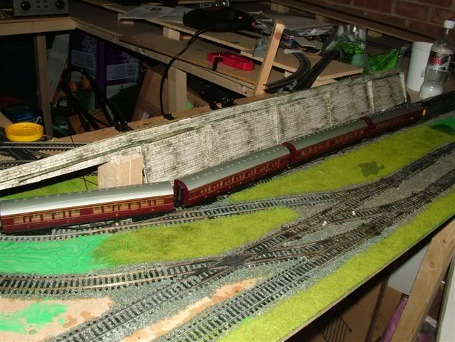

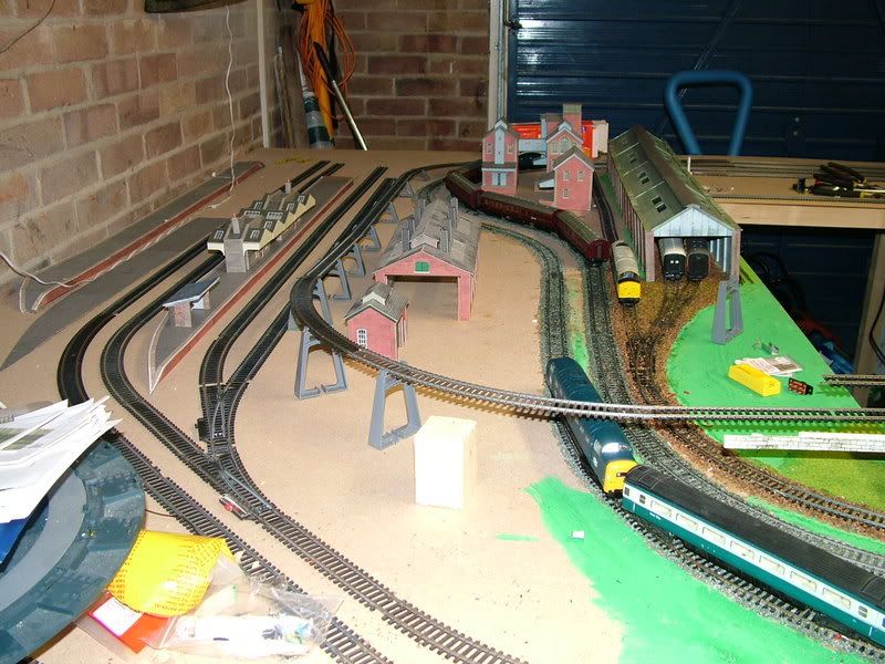

Can the wire in tubes be bought then? Or does it have to be home made? Also I love the way that you have made your incline, very gradual and also decieving to the eye.
And blimby it must have take you ages to build those four engine shed together from scalescenes, I have made one of them and I still havn't done all of the finishing touches. If I was to make one fully it would take me a week!
I also spot a turntable box exactly the same as mine!

Postby SouthernBoy » Tue Oct 02, 2007 11:57 pm
This is starting to come to life now - I particularly like this picture, with the tracks sweeping around and down below your raised loop.
B@rney wrote:Few pics now i have tidied things up a little
Any ideas on scenics / setting ? ie. Town / country / suburban / industrial / etc ?

Very impressed with your carriage shed.
Was going to ask how your sourced it and then noticed holmedwa04 provided the information.
I must make a note to check out the scalescenes site again.
I assume you can store 2 rakes of 4 carriages?

Questions: Wire in tube, yes you can buy it but all the places i looked at it was very expensive and in the main had to run on top of the baseboard (or slightly sunk in) as the wire and tubes are much more flexible. The wire i use is pretty tough, flexible enough to go around corners and still work, but strong enough to take an angel bent into it. Plus this stuff is really cheap, 1 metre of wire 85p, 1 metre of tube 35p, switch 85p from maplins. (but i can only buy 2 at a time without placing an order anyway)
The carriage shed took me best part of 2 weeks with a couple of hours most evenings, again nice and cheap compared to kits ones liek metcalfe.
It didnt turn out as nice as I would have liked, I have a bit of problem cutting cardboard at right angles. but i think it looks ok in pictures. I was a bit concerned that it appeared over scale when i put it on the layout first, but ive got used to it now. And yes its 2 rakes of 4 carriages.
The turntable box, Yup its a hornby one, if you could have moved slightly to the right of that box youd also be able to see a peco one.

and Finally, scene setting etc.. well I have nothing particular in mind, but my loco collection is now mainly BR blue, so I guess that sort of sets the age period. Location: possibly midlands somewhere I guess, as i have hills so cant be Norfolk (where i live). It is mainly going to be countryside, 2 stations, a terminus (which may change to something else) and a 2 platform with mainlines through the middle run through. I would like a container yard, but thats a long long way off (as containers are very expensive)
