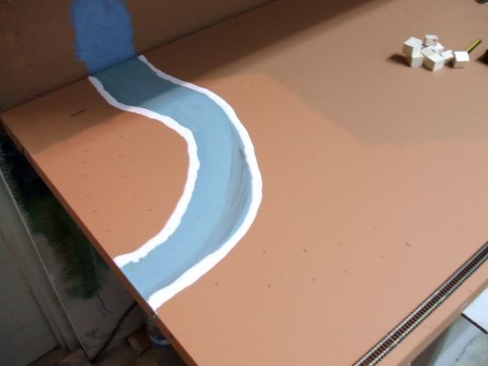

So where were we....the old trackplan has been modified a little but not too much, I still want to be able to run either end to end through all the main lines or just a long circuit continuously.
I have marked out on the board now where all the raised sections are going to be and used some decent wood to make pillars....the gradient is somewhere around 1 in 28.........the trackbed on top of these pillars is going to be 4mm ply, nice stuff so should get a decent finish.
I have painted in the river bed, it's a bit blue but thats ok, I have used a thick run of glue to form edges, this will make it easier to do the varnish later, the dark smudge is a likely location of some type of outlet pipe or another from the factory that is going to be here, the fisheries ministry will be on the phone!

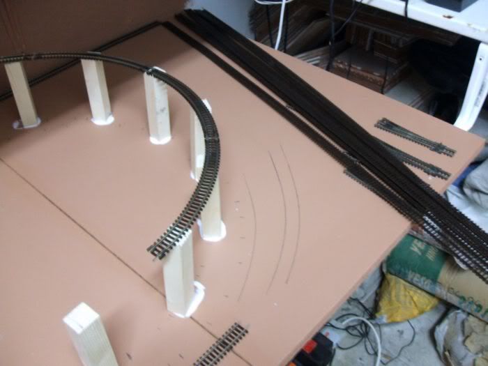

So here are the shots of the track supports during construction, the curves on top of the pillars were only me being smug that I got the curviture correct......
The inner curve is going to be setrack 1st radius, the out curve is flexi, I have had it all measured out and tacked in place so the angle should be a nice smooth curve....

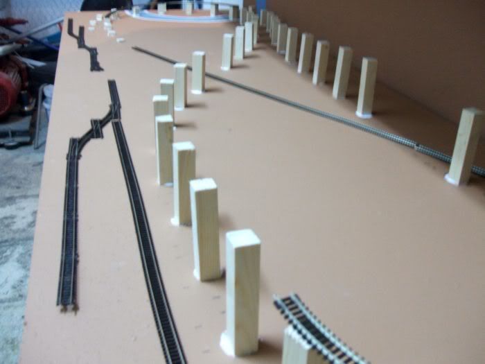

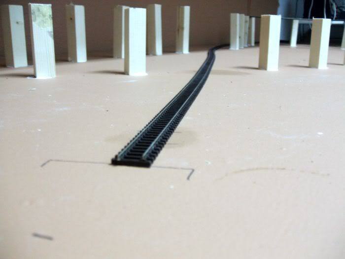

The inner rail in this shot is actually going to be the same gradient as the outer, I just started to gradient earlier to make it more interesting, the inner loop will peak at 8.5cm above baseboard, plus the 4mm ply plus the underlay so a nice height, the outer one peaks at 10.5cm as I would lurrrvvveee a viaduct but we'll see...
This shot shows where I have left the gap for the bridges, 2 of them crossing the other rail separately and at different heights again to look different and somehow more interesting....
The area on the left is where the small station will be, plus a couple of sidings for oil tanks etc, it is all setrack and will feed nicely off the flexi laid mainline, looks ok and all seems to fit ok....
