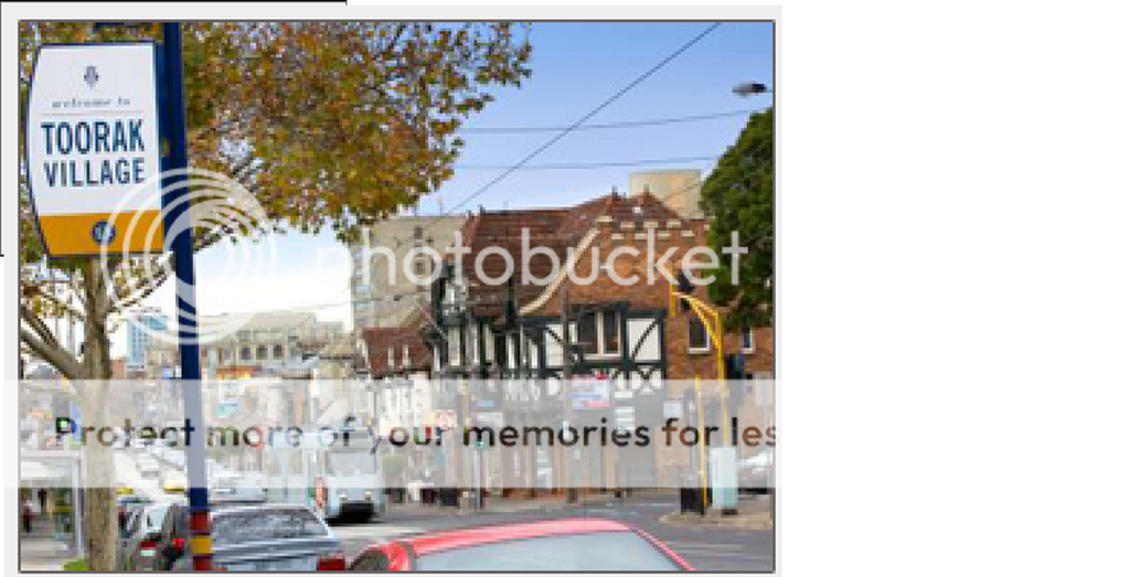

Very nice work. The pub sign really demonstrates the ability of the 3D printer.
Does your layout have a name?
Cheers, V.R.
P.S. (did you steal Toorak Village?? :lol:)
V.R please explain this for me. and at the moment I do not have a name but working on that.

Postby VerdevaleRailway » Mon Jan 16, 2017 6:35 am
Hello, apols for the confusion, There is a string of Tudor shops on Toorak Rd,
There must have been a thing at one stage for tudor=esque shops in Melbourne early 20thC, There's a set in Commercial Rd, Prahran, another in Burke Rd Camberwell. Elsternwick has another set.
'whose origin was a terminus'

Postby timbologist » Mon Jan 16, 2017 7:06 am
I have not been down that end of Melbourne for that long I could not say that I have or have not seen them, I grew up in the Northern Suburbs, If I ever go that way will have a look at them.
