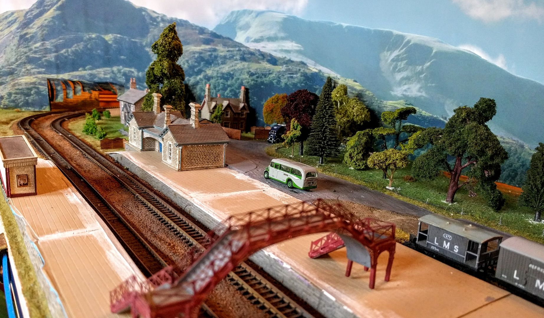

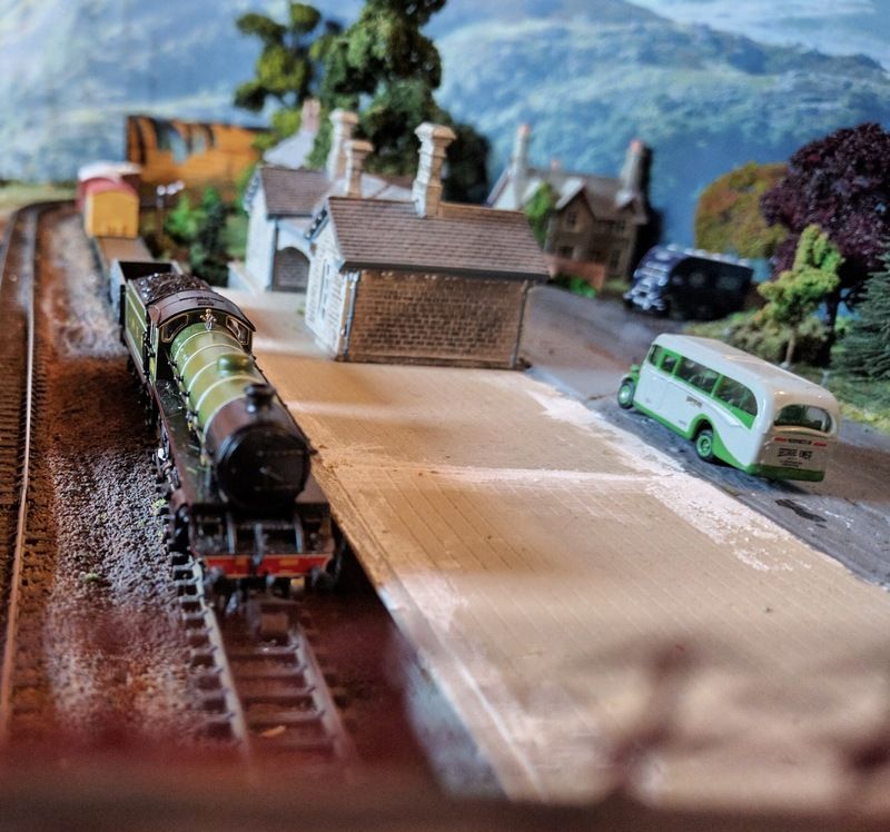

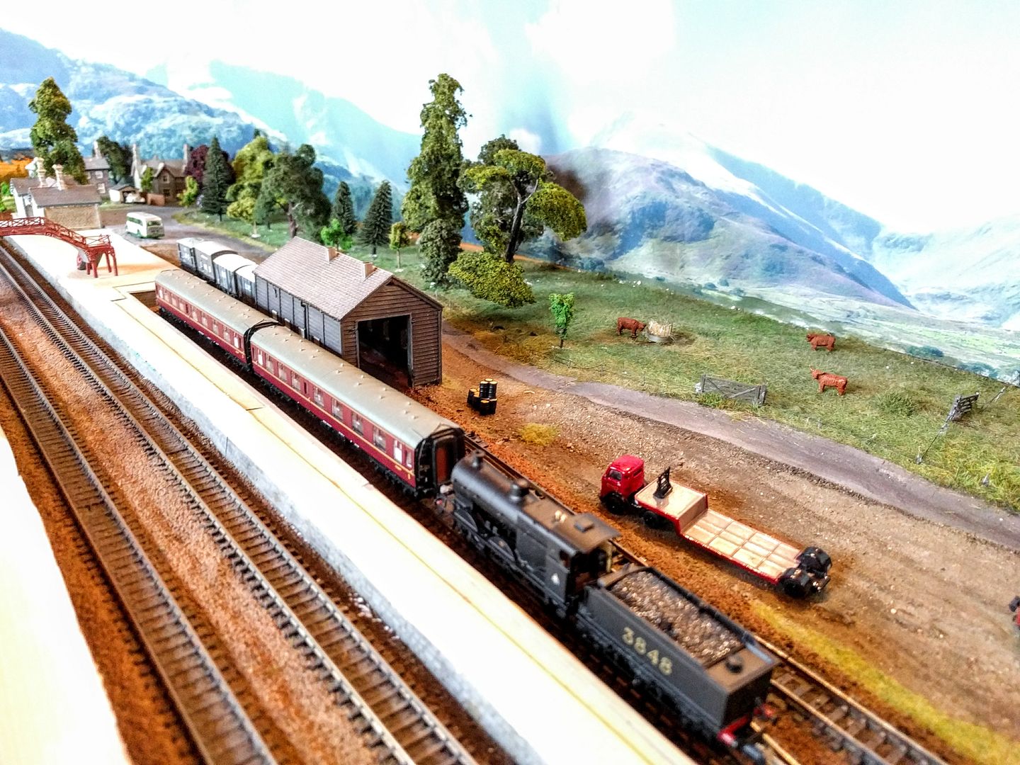

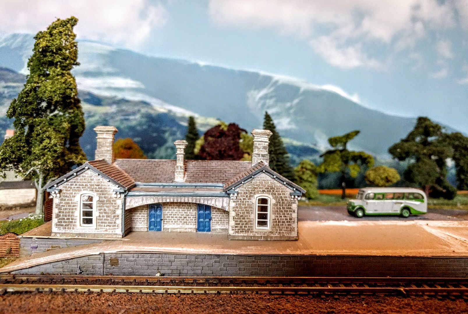

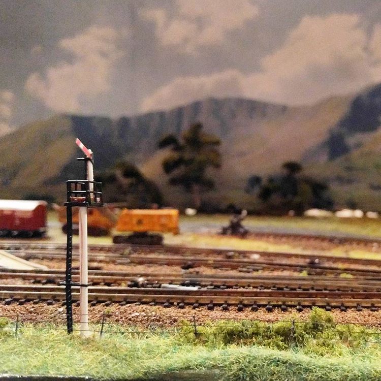

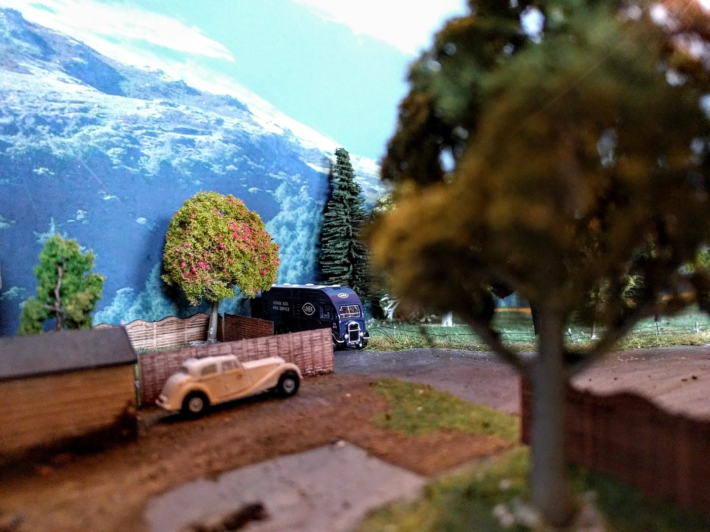

Postby LukeB » Mon Sep 26, 2016 7:47 pm
A little break over the summer and now I'm back at playing trains. Lately I've had a good deal of time to work on Newtonmore, due to a mystery illness I'm at home a lot.
I'm currently on with the most infuriating job since wiring up, laying down the fencing. I looked high and low for fencing that would be appropriate off the shelf but most N gauge fencing is wooden posts and rails, and the fencing around Newtonmore is all barbed wire. I was left with the option of making my own, which I've made out of brass wire sprayed with primer and strung with EZ Wire, a stretchy elastic thin stringy type of thing, used my model aircraft builders for rigging. You can't really see it but it's much more to scale than off the shelf stuff.
I made it by glueing the fence posts to a piece of ply at 5mm intervals (which would stretch to a scale 6-7mm interval once planted) and then stringing the EZ Wire across the board, glueing it at one end and using the reel it comes on to keep it taught enough to be straight at the other end. This was then glued with a tiny amount of superglue to each post, then repeated three times for each row. A thousand blobs of superglue later...
I also started planting my trees from previous layout and all of a sudden it came to life! I can't believe the difference these and some vehicles has made to it, it's given me a great deal of motivation to crack on.
As you'll see, I've also put up some signals and a few of the buildings have been temporarily put down (mostly so I could have a running session yesterday!). I think I've decided that the station buildings and footbridge will not be glued down so it's easier to take photos (with the proper camera, these are still all from my phone).
Next will be foliage I think, the trees look a bit funny plonked straight into grass so I need to put some undergrowth in there.

Postby whynot » Mon Sep 26, 2016 7:54 pm
There's dedication and attention to detail and THEN there's "....This was then glued with a tiny amount of superglue to each post, then repeated three times for each row. A thousand blobs of superglue later..."
Difficult to believe that some of the shots are N scale. Wonderful stuff. Thanks for the photos.
