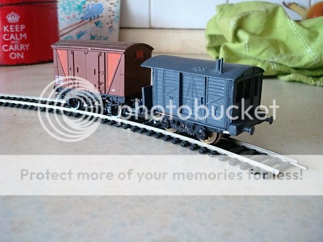

Ever since seeing comments about "sheds on wheels" I've wanted one.
Working from this phoro in particular
Not quite that far....
The body is an HO van with sliding doors with ends cut down from an ancient Triang brake van
Inside:
There is room for the R/C chip on the left.

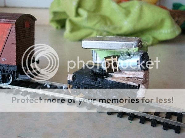

Just to see I cooked up a track power 12v version of the chassis:
With the built in brass gears in the bogie (from an Playcraft class 21) , total reduction is 1/56
Add a body for the little ugly diesel of your choice.

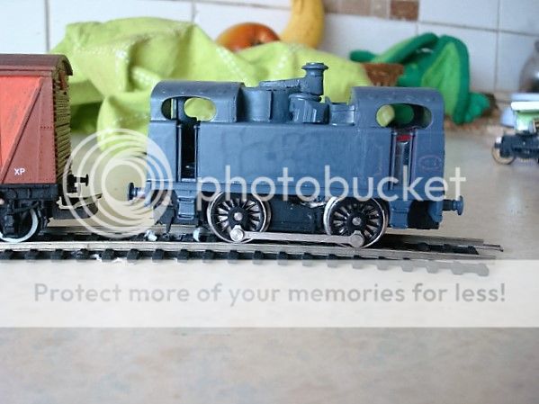

Moving on, again a quite small loco, a double-cabbed vertical boiler, at least by outline.
Inside, the chip is low and flat enough that two full AAA batteries fit happily. The motor wires are loose as I haven't decided which was is notionally "forwards" yet.
When everything works AND fits inside the body there tends to be a pause: details, colour and couplings can come in due course.
One more steam loco that I'm happy with to my latest idea of "good" and I should go back to making progress on the layout itself.
