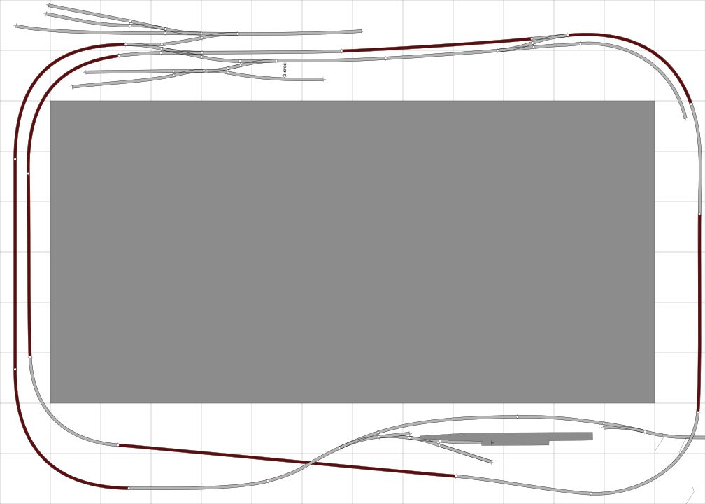

It's been a little while since anything was posted showing progress on the layout so time to rectify that. Following a decision to model something based on my home town station a new track plan was drawn up producing this.
Using Anyrail software I was limited to 50 rails so some track has been omitted. The main roundly roundy is a double track being served by the station of Galgorm Hall. A branch line also terminates at Galgorm Hall on the bay platform at the upper side. This branchline feeds the outlying station of Abbots Grove before continuing to other outlying stations on the route. The track feeding off the board on the bottom right hand corner will eventually be a fiddle yard for the line.

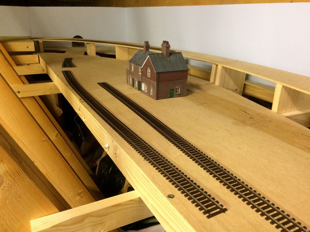

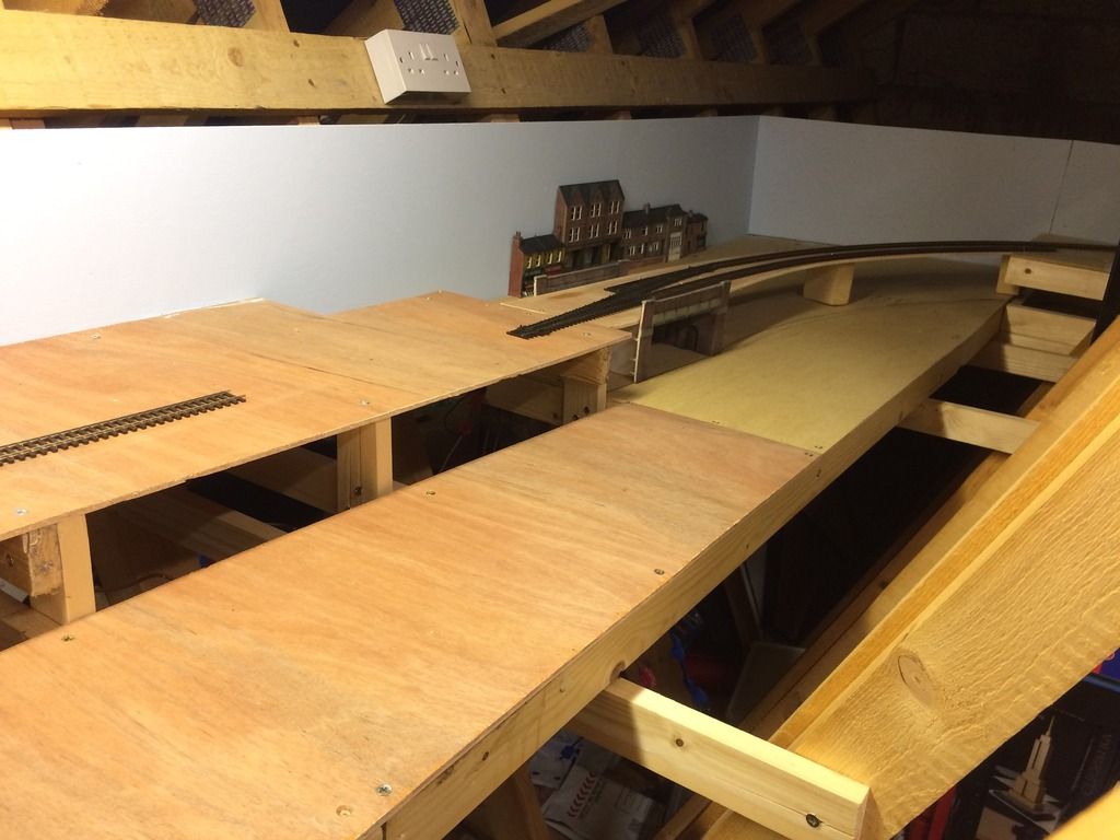

The mainline sits 70mm above the main baseboard so it was necessary to carry out a lot of woodwork to produce the required hieghts for both main and branch line and that work has just been concluded.
With some track loosely placed and the shape of the raised trackbeds it's now possible to get a feel of how the layout will look when permanently laid.
The north end of the main station sees the track feed round from the branchline and the main line run. This is where the main pointwork will feature with the two road station shed sat in the upper corner and a goods siding on the lower side. The lower baseboard will have an access road sloping down from the upper board to the main road with the station and its upper level platforms the main feature here as per the prototype.
Moving south out of the station the tracks will run over an embankment with the town featuring on both sides.
The bridge is not as per the prototype but I liked it from the last build so wanted to incorporate it in to this. The low relief buildings may have to be replaced with something else as the dimensions don't quite work at present for what I have in mind.

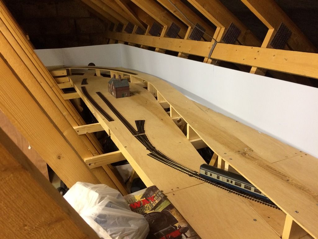

Going back to the north end, the trains loop round the corner with the branch-line at the rear beginning it's decent to the lower level baseboard.

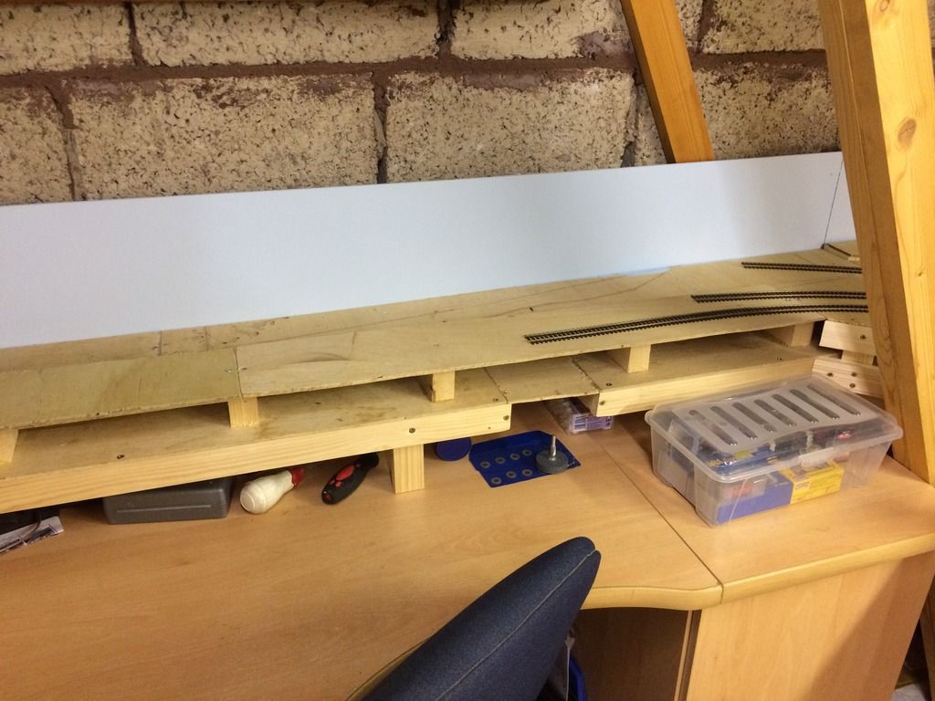

Having swung round the joining board the mainline is on the upper tier with the branchline crossing beneath

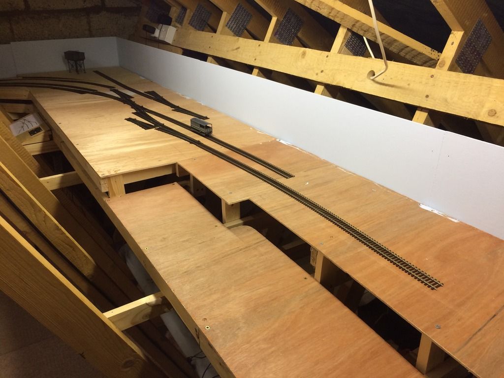

The branch enters the outlying station with the mainline sweeping round behind.

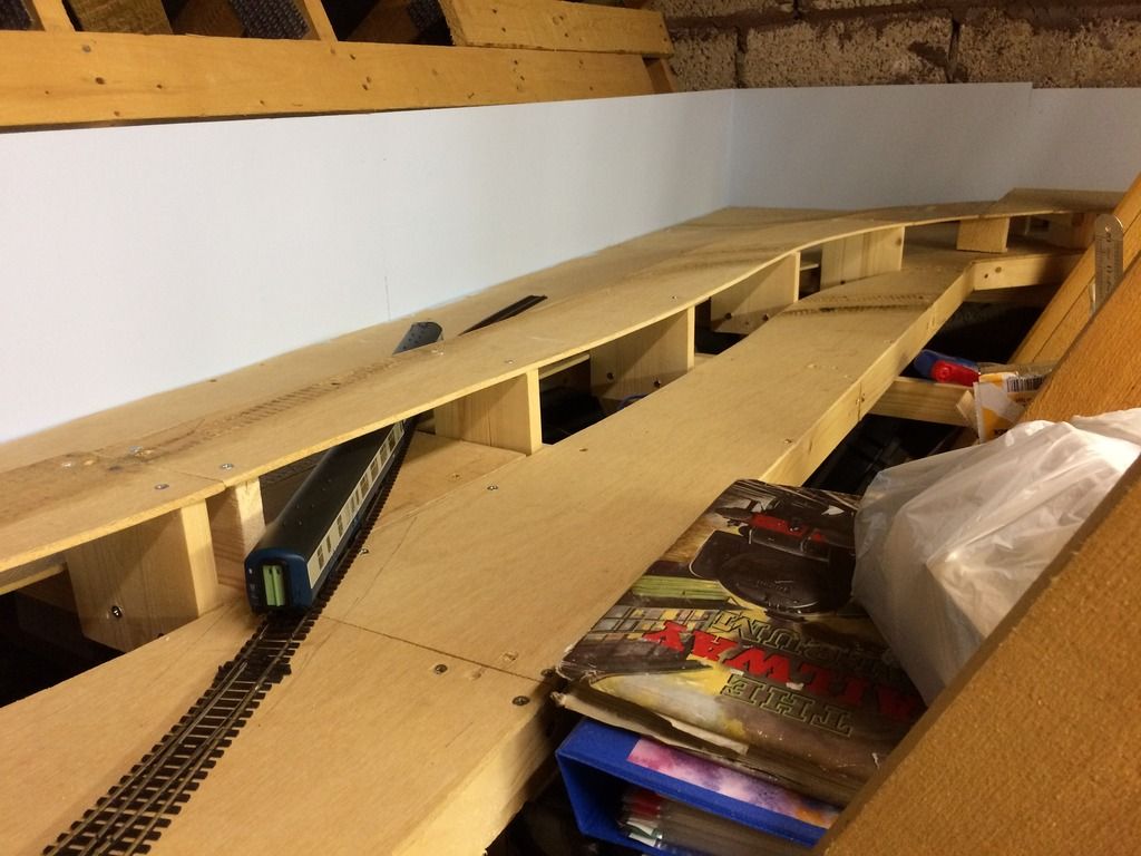

The branch then continues under the mainline again and will end in a fiddle yard off the back of the main layout (yet to build).
