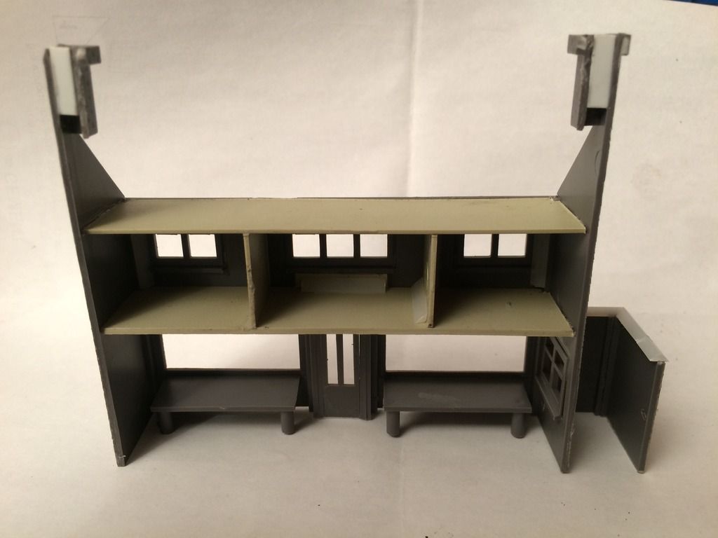

In the meantime I have started the first build and it is probably the last kit building I will tackle on the layout. I'm using the Dapol general store kit but am hoping to make some minor modifications. The first glaringly obvious one is that it's been chopped in half as it forms a low relief store next to the fruit shop. This will plug the small gap between it and the joining side street.
Here's the progress so far.
I've added an additional wall to the side from the offcuts of one of the gable ends just to add a little interest. I'm going to keep it as a hardware store and hope to stock it with all manor of items in the shop windows, on the kerbside and hanging on the walls. In addition to this, I'll add a cloth canopy above the shop windows. The building is going to have a whitewashed finish to the brick although this will be faded in places to reveal the original red paintwork.
Since writing this I have the main rendering of the walls is done.
A coat of red oxide primer was applied first followed by a coat of white primer. This actually took two or three applications to cover over the red but applied lightly and left to dry after each coat prevented the brick recesses from being lost. Finally, sandpaper rubbed over the surface revealed the red brick beneath. Care needs to be taken on what appear to use. Too fine and it doesn't work it's way through the primer and too coarse and it scores the paint in lines rather than lifting full sections of paint.
It all looks a bit spotty at the moment but it should tone down somewhat once signage is fitted and the windows, doors and walls are painted.
